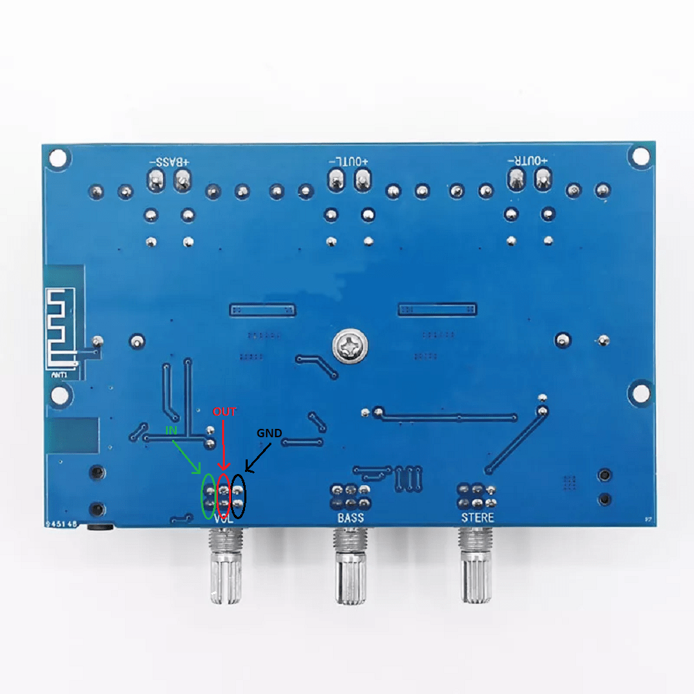

You simply need to wire Rin, Lin, and Sgnd in parallel with their respective inputs on the amp board. Never wire a VU meter to the speaker outputs, especially on a full-bridge, single supply amp. You might have damaged the VU meter already.

I'm also throwing this out there, and I have no idea if it's possible, can an adequate signal be pulled from a volume pot or tone pot? stab in the dark. I know its alot to consider just for some dancing lights. But this all-in-one integrated board is a tough one.

You can try connecting it directly to the input of the volume pot if you want the level to be full scale regardless of pot position, or connect it to the output of the pot if you want it to track the pot level.
Interesting, ok I'll give that a go. I knew someone here would be kind enough to lend a helping hand. Some forums out there are utterly savage. Thank you Anonymous.
Oh one thing though. Does the vol pot recognize left and right respectively? or is it overall volume gain for both left and right together like a mono channel.

Good morning.... Anonymous if you wouldn't mind confirming if you can, based on what I researched last night, does the wiring diagram in this picture match the pin layout of the 6 pin volume pot on board I have? Logic tells me it matches, I just need a second opinion.

Yes, a dual gang pot has a left/right inputs and outputs.
I don't know which TPA3116 board you have, so I just grabbed an image of a random one from Ali. The marked inputs and outputs have two pins each for left/right. Solder the VU meter inputs to either the pot input or outputs pins depending on how you want the meter to behave.
Sorry, I must have been typing and didn't see your earlier post. Seems like you got it figured out though.
HAH, got it working... YES. I'd post a small video, but the forum only supports images

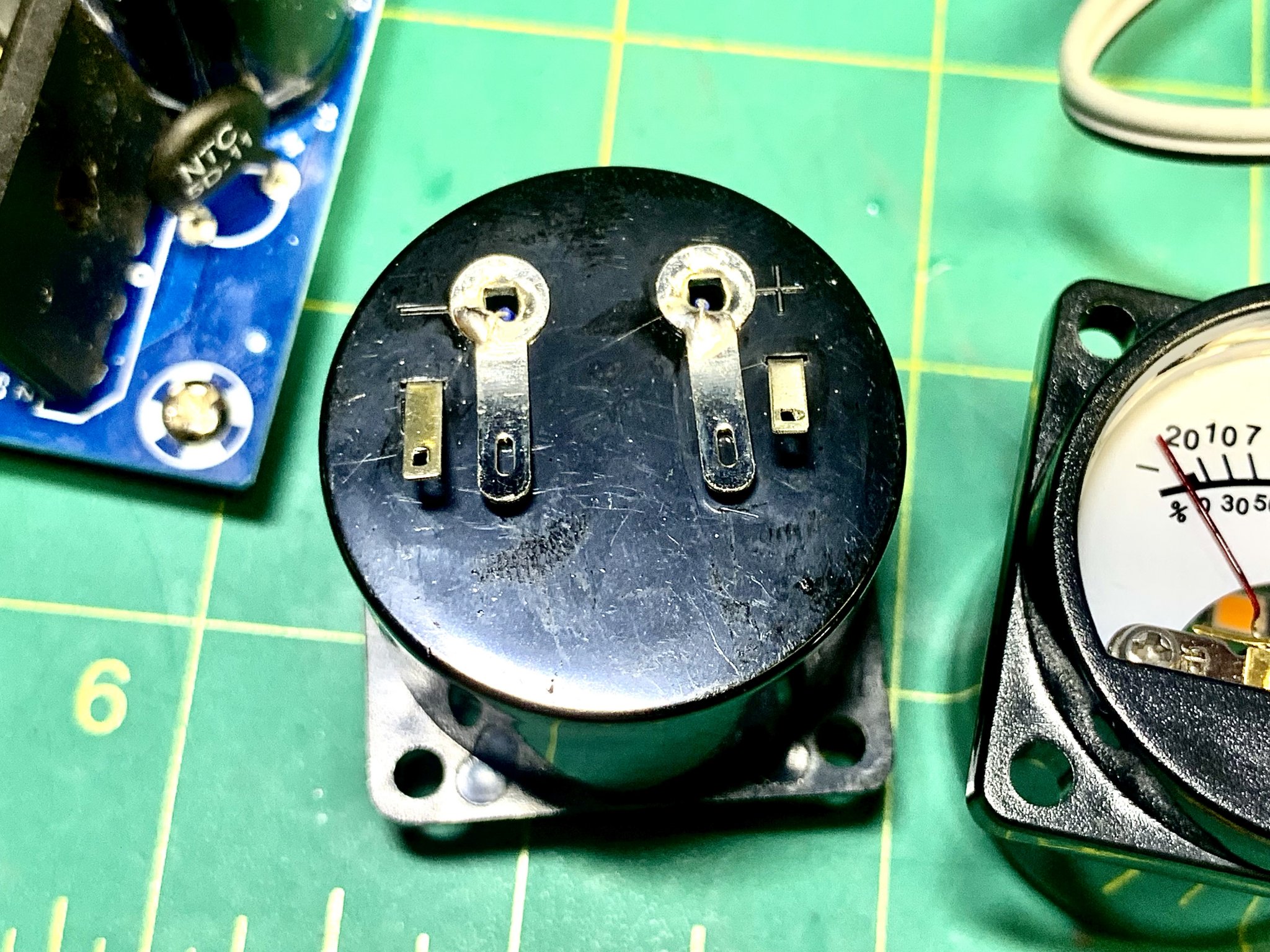

If you wouldn't mind confirming something for me Anonymous. The wire diagram I found that closely resembles these analog meters I got says that the smaller tabs are for the back light and the larger are for the signal. Does that sound about right to you?
Got a pair of analog 12-15v / 300mA VU meters with the driver board, and yet again no paperwork or diagrams.
