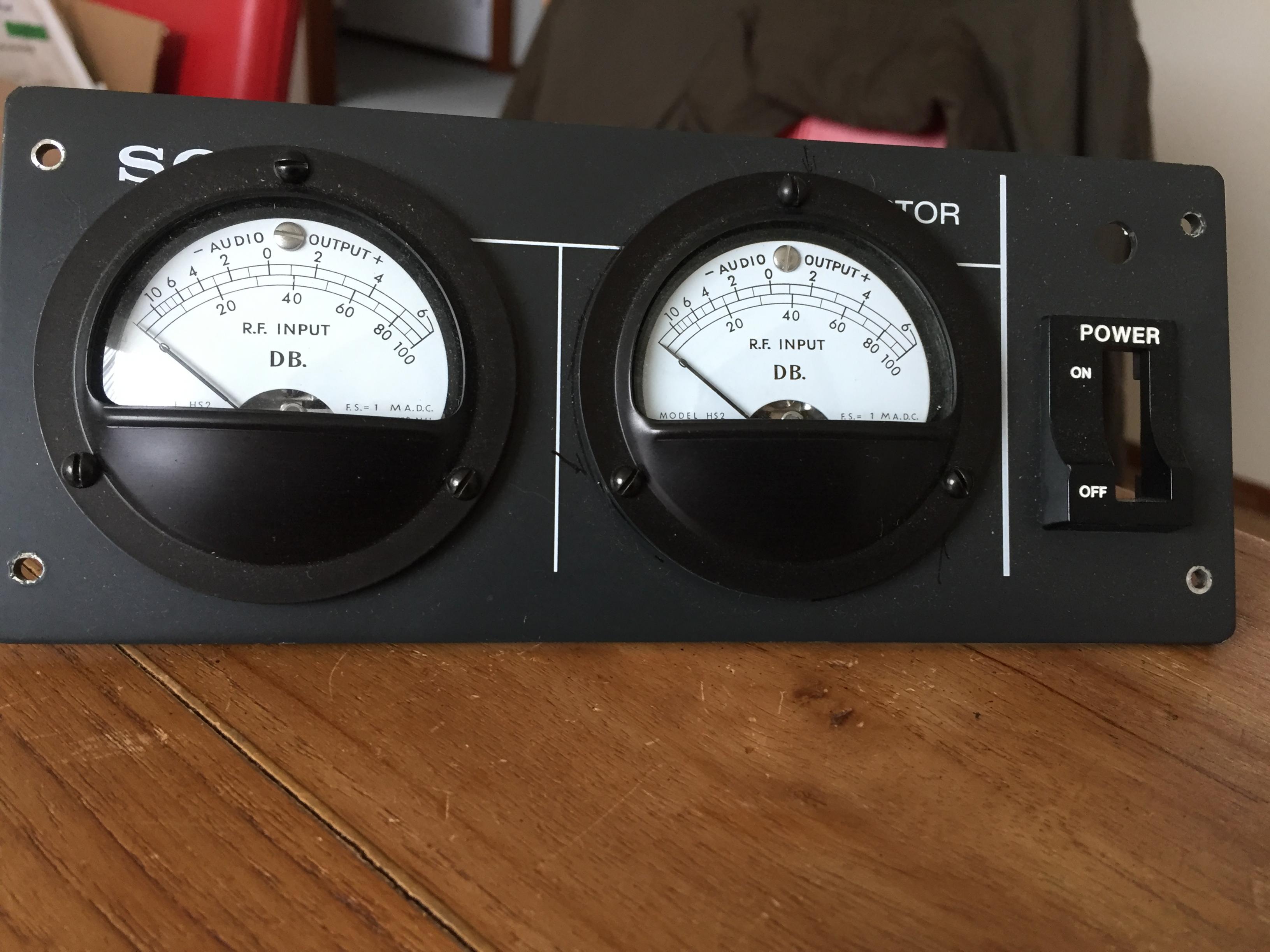

For positive inspiration my idea of level meters. Very old airplane meters but new in box...
Dang!! 🙂
