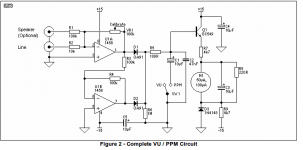

Your problem may be that amplifier output voltages under normal operation are much smaller than you imagine. Take off rectifier drops and you don't have much left to move the meter. Using a precision rectifier circuit (which I think someone suggested earlier in the thread) avoids this problem.
Its like we keep saying, well lets try and put it another way. All the meter movements have mass that needs moving. A transient peak just doesn't do it, you need more sophisticated electronics to stretch and hold that peak so the meter can respond. And the other problem as DF96 mentions is the rectifier volt drop. The voltage needed to overcome that is actually more than enough to give decent audio output from most speakers, but the meter are blind to it.
P { margin-bottom: 0.08in; } I didn't design the circuit that I'm using, I just found it online in "AT" Magazine (see Attach AT51..... for accompanying article). I'm still searching in vain for the elusive ballistics circuit, so far I've only found "VUPPM..... " s. Attach which I can't use as it needs a dual supply and anyway I don't need PPM facility. So if anybody comes across a proper circuit, knock yourself out, let us know about it please.
