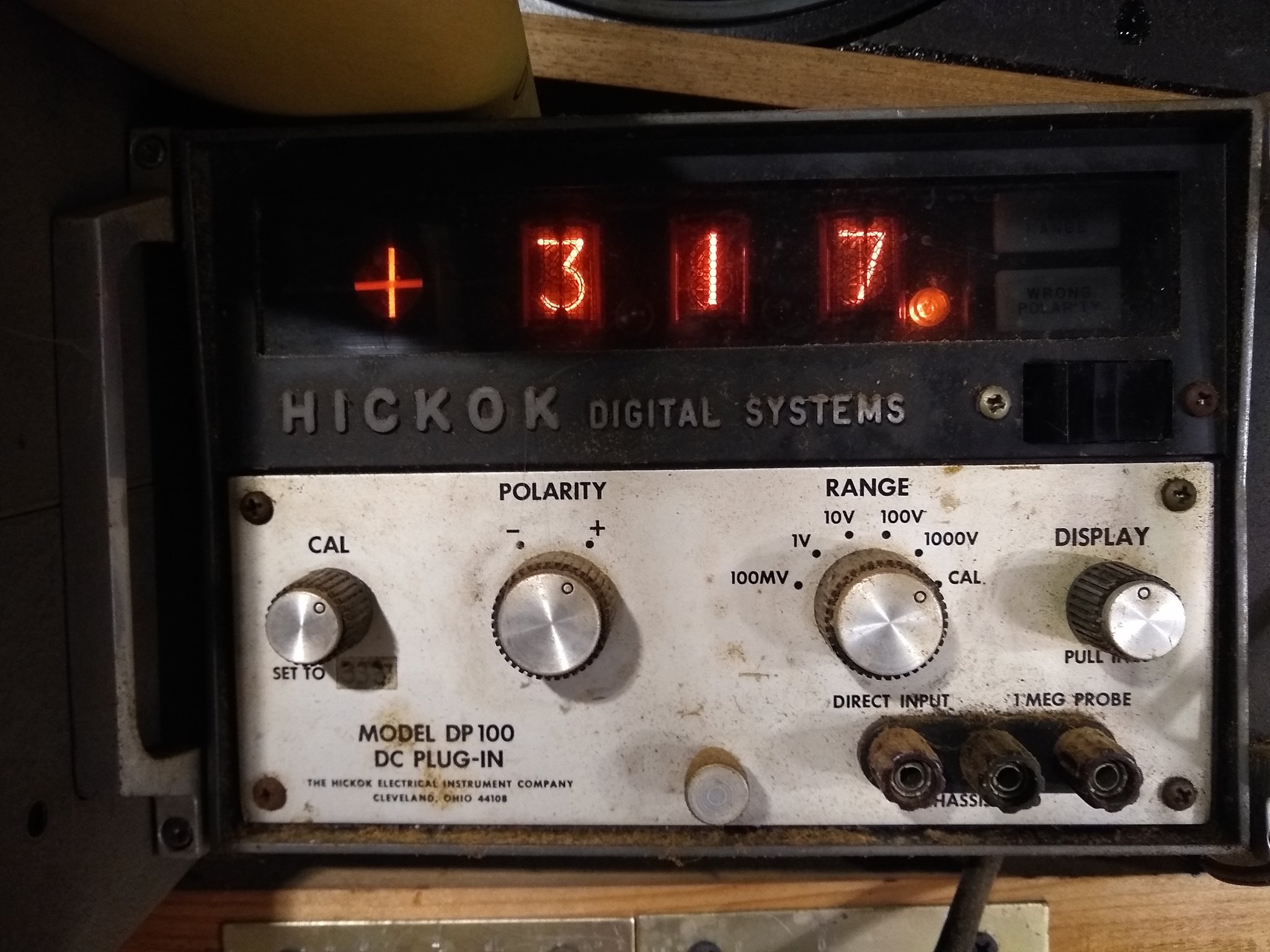

an old Digital Voltmeter I bought surplus around 1972 for $50. It has a few problems now. One day I may see if I can fix it. It is all transistors inside except for the Nixi tubes, no IC's.

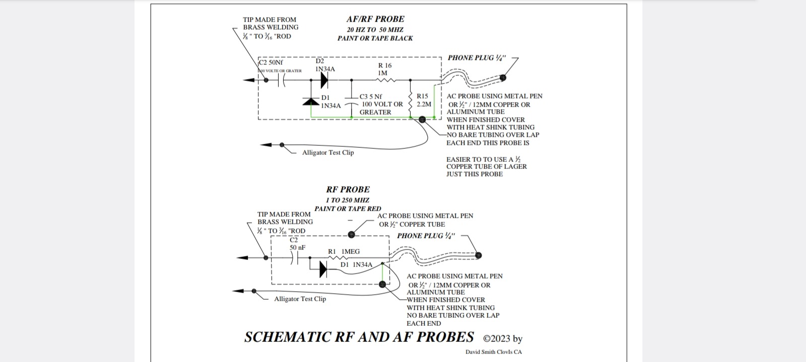

I use probes for all AC, AF and RF.
My first design had a AC switch .
Most old VTVMS was only rate to 4MHz after that you use a probe.
After reading the best way to change the AC, AF and RF at probe and most VTVM you either change the probe to without a 1meg resistor or it had switch.
So came up with 3 probes from DC to 250Mhz. I have a design for 1.5 GHz but I do not think I would ever use over 120 Mhz.
I also use probe for 250 volts AC DC keeping the voltage inside the VTVM to 100 volts. I do think I will ever need over 125 volts.
Dave

Nicely done. I would add low capacitance diodes from the buffer amp inputs to supplies for protection. I'll assume your input divider is designed to be slightly high? I haven't bothered to work out the ratios. I like the way you sorted out calibrating each individual range.
Some experimenting with parallel capacitance across your dividers would extend high frequency response on AC. That would seem to be useful. Does it have an AC detection circuit, or is it just DC?
-Chris
Here is schematic for probes

Nicely done. Your drawings are excellent by the way - very impressive!
It's cool seeing germanium diodes used in new product. I haven't looked, but I wonder if there isn't a current (new) low forward drop diode with very low leakage available. Interesting application for a new product if available,
I am very impressed by your work and thought in this. I still suggest you instal some protection diodes on the input of your buffer amp.
-Chris
It's more a case of a chip failing "funny" where the input is damaged. If you can avoid this easily - you should. The diodes only need to clamp the voltage to either rail so you don't exceed the common mode range destructively. The chip maximum input current (20pA) has nothing to do with it.
Anyway, easy enough to tack a couple diodes from each rail to the input. Most signal diodes, like 1N4148 (silicon signal) would work. A low leakage part would be better. One example, and there are probably better parts for this, 1N4149. 100V, 500 mA - not the interesting specs. 25nA leakage @20VDC and 2 pF junction capacitance 5nA leakage spec is at 75 V reverse voltage applied as a limit.
