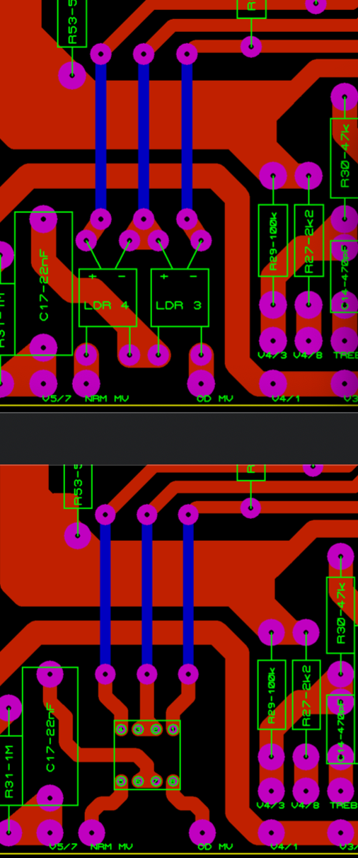

I was wondering what would be a best alternatives to VTL5C1 opto switches used in Soldano amps?
Would this available part NSL-32SR3 be a drop in replacement?
Also browsing the internet I found some drawings using 8-legged couplers there, but cant get any information on which exactly? Here is a fragment of the schematics attached.
Of course people are switching to relays, but heard you would need to do some muting in order to eliminate clicks.
Thanks!
