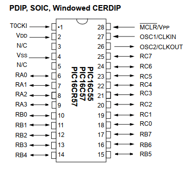

The PIC shows what I thought was a clock on pin 1, but I see there are two OSC pins at 26 and 27 now that I take a closer look. I did not see any clock signal on any pin when I probed with a scope. Either the crystal is dead or the PIC is dead. Crystal would probably be my first guess.

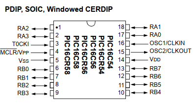

I just discovered that if I connect pins 14 and 15 together, the unit comes out of mute and audio passes through both channels. I still can't see a clock signal on either of the clock pins. There's a 4MHz crystal in there.
Yeah, interesting, there are 18 pins on the physical chip. But the part number references to this data sheet. Oh wait, the diagram on the left is also DIP:
