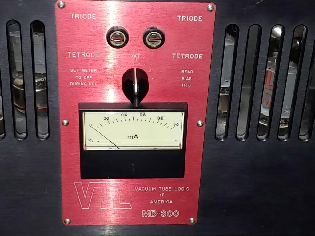

1. The amp front plate has an an ammeter and an 8 position switch, see picture (I assume for measuring the bias on the tubes). The manual says nothing about this.

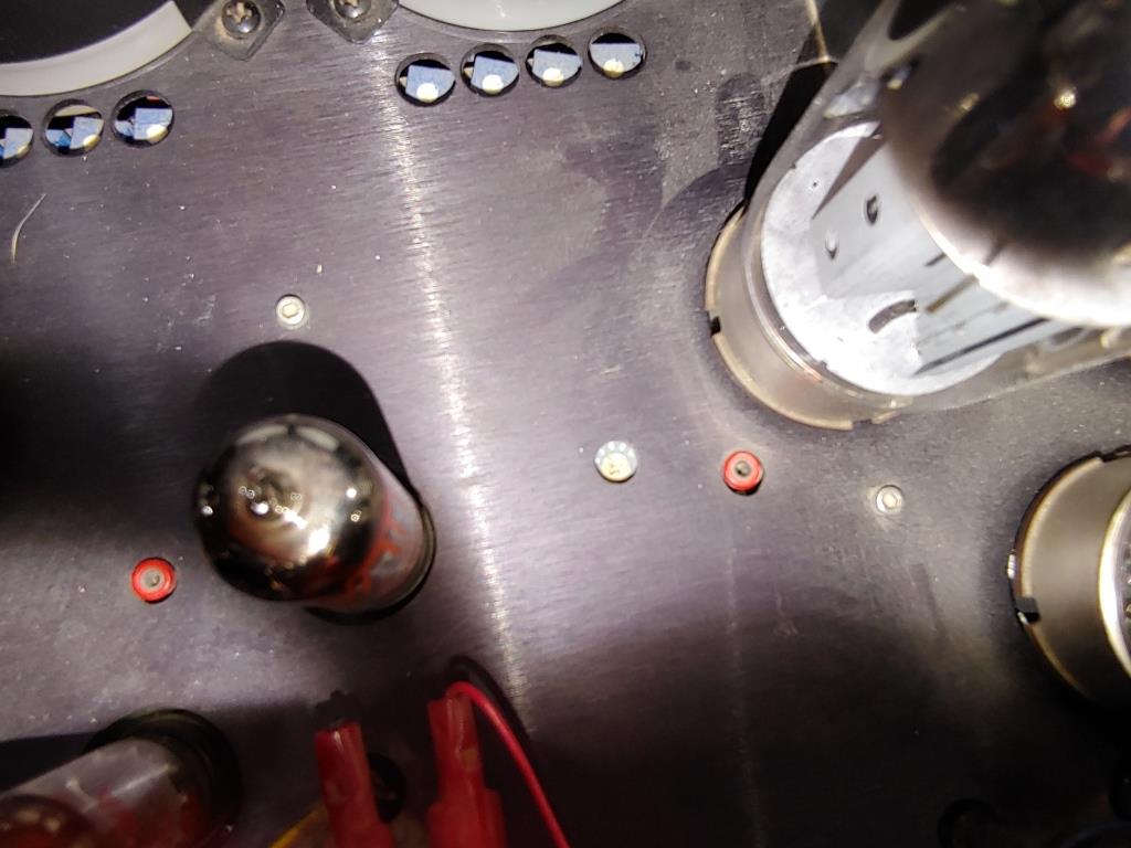

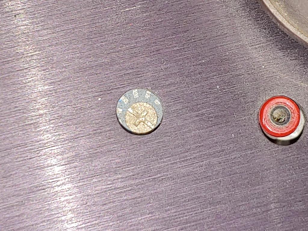

2. In the center of the amp between the tubes appears to be another switch (see picture) between the red test nodes. This also is not in the manual.

1) This measures the cathode current in output valve determined by the position of the 8 way switch. I assume the 8 pots on the back will adjust the grid voltage on each valve.
2) No idea.

The Idle current is around 27-30 mA each power tubes; this type of amp with meter is the first I have seen.
In every case normally VTL put a 10 ohm resistor from cathode to ground of each power tube to check the current,
The two test point and the trimmer is about the balance on phase splitter; a scope will help

Thank you for the help. I was able to resolve the issue. VTL was unable to help me. As it turns out, Manley Laboratories was able to help me. Manley Labs split off from VTL a long time ago to go after the pro audio market. The switch is used to bias each of the outputs. The other test node is for an AC signal check. I was able to get it up and running and it sounds excellent.
