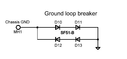

Please read my whole post before reacting. I have 3 VTL designed amps. had the same problem. I installed this mod on the amps and the preamp and problem solved. The mod goes from the chaiss to the ground wire of the electric cord inline. A low or no ground fault, the diodes forward voltage drop results in a virtual open circut to ground (basically a virtual cheater plug), at ground faults with a voltage greater than the voltage drop of the diodes (about .75 volts), the diodes bias and the virtual open turns into a virtual short and operates as a normal ground. The gotcha is that you must use diodes at the continuous current rating of any expected circut breaker, or it will not be safe. I used 30A diodes that had a surge rating of 45A. Make sure your diode voltages are better than 240 volts.
Thanks for all the suggestions, everybody. I ended up using a 5-ohm resistor parallel with two diodes in either direction and soldered between circuit board ground and chassis ground per Fran's suggestion. It works but not ideal. It's quiet enough.
