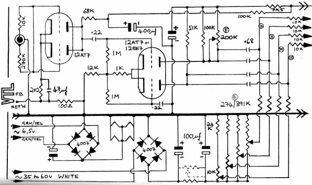

Hi Brad, thanks for the info. Yes I did look at the audio asylum on those 6p3s-e. For the price I also think that there shouldnt be any compliant, if it can fit into my VTL. In the VTL it has individual tube bias and also a central bias port. But I'm not sure how to bias an amplifier. 😀
Yes I'm willing to get my hands dirty, and will try to locate the cathode resistor ASAP.

found some info on bias and schematics. For starteres make sure your amp uses 10Ω resisters on the cathodes to measue bias. You should be able to measure the resistance at the bias port to ground with amp off. Bias your KT88s accordingly then give another listen.
I would contact VTL with your serial number to see if they can provide you with the book on this amp.
