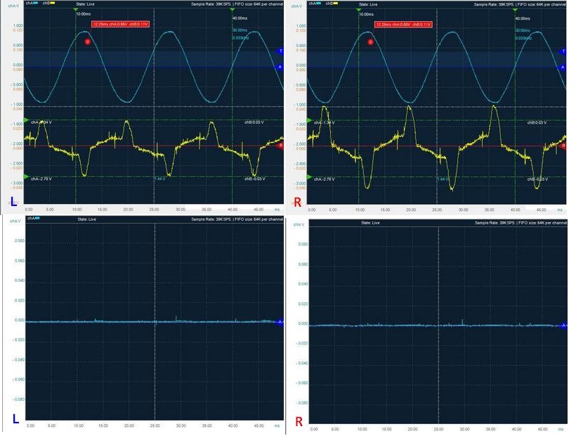

I’m new to building amps and I’m looking for some help on a slight hum/buzz issue I’m having with my new VTA SP14 Khozmo build from Tubes4hifi. We can take a step back and I’ll give as much info as possible about me. A few weeks back I built a pair of M125 mono block amps from Tubes4hifi/Bob Latino. They are dead quiet, transparent, open and clean. I was using my Bluesound Node 2 as my preamp to stream music. Love them! I was so impressed how they sounded I wanted to compliment them with a Tube preamp therefore opting to build the VTA SP14 from Tubes4hifi. I opted to upgrade the standard SP14 to the Khozmo design which incorporates a digital display and remote control. I also upgraded the output caps to the Muldorf’s and went with the NOS Sylvania tubes.
The project went very well. It is completed and it sounds really nice except for the issue I’m now getting an annoying buzzy/hum coming through my speakers. I’ve been working back and forth with Roy from Tubes4hifi and I’ve tried different things including powering everything into the same power strip (which I hate) but for the sake of testing did and because my voltages were on the high side, I changed the HV tap on the tformer per Roy from the 280vac tap to 260vac. The buzzy/hum persist. I have attached some pics of the SP14 builds along with the mono blocks. Looking for any suggestions from some of the experts out here. This thread is in no way to bash this product or seller. The seller Roy has been very helpful to this point.

just doing a quick look at the photo's, those toroid transformers are right next to the pcb, which in my opinion are too close. Personally I would prefer more distance between them and the pcb.

A ground loop hum/buzz can be easily misdiagnosed by a novice as a preamp/amp hum issue. Ground loops are usually external to the piece, but can also be an issue with the internal ground wiring of a preamp or amp.
It is not always easy to try and solve a ground loop issue, they can be a real pita!
There is no doubt it was a ground loop issue. But I tried that preamp on 4 different systems in different rooms in the same house and everyone of them had the issue. It wasn’t very loud but I heard it every time I turned it on. I just got fed up with it because I wasn’t going to start reinventing the wheel in my electrical panel for the house lol
Sorry you didn’t get it sorted out. There’s so many things we could have tried.....I never saw this thread until now.🙁🙁
As another just suggested. Ground loop.. This is exactly what the builder of Brown Labs Audio said. Ground loop but occurring for some reason where metal meets metal on the chassis for Khozmo volume control shaft . Now I would like to think that this builder checked out what was going on and apparently when Khozmo was removed everything was ok .. Maybe it was something in his topology design that created the GL . I have a message out to him and curious what he will say.

Two things that are wrong are the transformer orientation and the 0vA buss joining the panel RCA connectors.
It appears one half of the high voltage line is adjacent to one of the heater lines. The High Voltage line should be twist up to the point the enter the PCB. ALL A/C lines should be well twisted. The aforementioned Valve Wizard article should be followed explicitly.
0vA - ZERO Volts Audio - should be one point.
The transformers appear to be HT and heater. They should be oriented so Line is as far away as possible from output. Twist ratio is inadequate. Heater winding polarity should match between channels.
See http://192.168.1.160/Audio/VTA_M-125.php#Polarity for more info on transformer and heater polarity.
There should be no direct connection between 0vA and chassis.

I had a stepped remote control khozmo in my bpbp, with an acrylic front panel and no metal-metal contact with the khozmo rotary controller. It was fixed by grounding it to the signal gnd on the bpbp pcb with an extra wire.
There is an internal grounding of the attenuator to the case of the Khozmo, I did a line stage build for a customer, and had the same ground loop issue, I’ve never grounded my preamp stages to the volume pot, tried to contact them with no response! I connected one of my motorized ALpS to the unit and sounded great with ZERO hum!!
