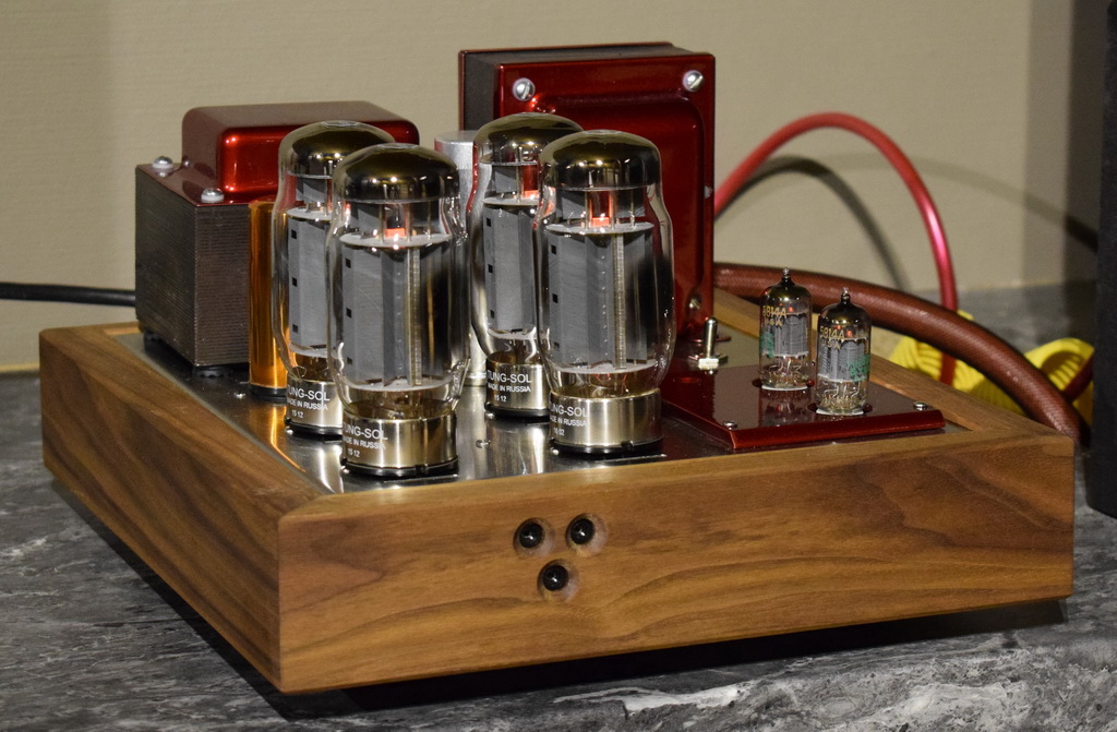

Try running the yellow negative feedback wire right up the chassis to the board instead of along the side.
Well the yellow wire isn't yellow any longer, it's black and it's screened. It
helped a bit but not all the way. It changed position a bit as well during that
change. I have some consern about filament wiring from the transformer to
the output tubes. Also pentode/UL wiring is drawn between the output tubes
instead of along the side of the input pcb. The signal wire is also changed for a
screened one, dual wire, screen connected at the pcb ground (not in the picture).

Thanks Bob. I will try to relocate the feedback wire tomorrow, how about my filament wiring ?
Actually, it's star grounded.
I'm seeing at least three chassis ground connections, two at the cathode resistors and one at the multi-section 'lytic.
Be very sure all those screens terminate at the star grounding lugs.
The pcb is already connected there, why would it be a better idea to connect the
screens with an additional wire to the star ground point ?
So now the feedback wire is relocated as described in "post 25" and I
measured 3,5mV ac of the speaker connections. The lowest value measured
so far 🙂 The remaining audible hum is almost non existant and I'm not going
to loose any sleep over it. In due time I will try some other tubes for input.
I'm using 5814A tubes for now, no idea if they are noisy or not.

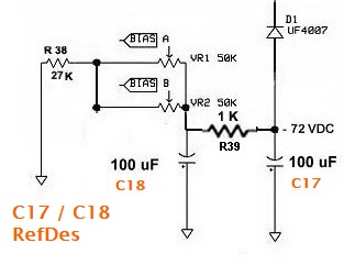

Per Mr Latino :"I can tell you that on the M-125's R39 can be either a 1K resistor or a jumper wire. I use a 1K resistor but a jumper wire will work OK also. What R39 does is that it sets the "range" over which the bias may be adjusted. Since the M-125's use either 6550, KT88 or KT120 output tubes, these tubes need more negative DC bias voltage to control them than the EL34 tubes that the VTA ST-70 uses. In the ST-70 we use a 7.5K resistor which drops the voltage into an area that is better for EL34 output tubes."
The noise problem is caused because the Audio GND is tied to Earth safety and in some implementations, causes a ground loop. Once the loop is eliminated the amps are fairly quiet, ≈78db.
The autobias boards only increase noise because the pick off point and R39 were incorrect. If anyone at Tubes4HiFi / VTA had tested an amp pre&post AB-Q install they would have seen the problem immediately. Just as I did.
The 1k resistor vs link is going to make a ≈1v difference in the range: 1/(1 + 50/2 +27). It will however change the LP filter from ≈1.6Hz to none in a stock amp. 100Ω raises the filter to 16Hz, but that's still ≈15db down @ 60Hz.
78 + 15 = 93

The as built noise was not caused by the auto bias per se. Just design and poor build.
![Sch_BiasCCT.jpg](/community/proxy.php?image=http%3A%2F%2Fielogical.com%2Fassets%2FM-125%2FDTAF%2FSch_BiasCCT.jpg&hash=ae90c6f218fb1ea57f67b6ede55e6262)
78 + 15 = 93
