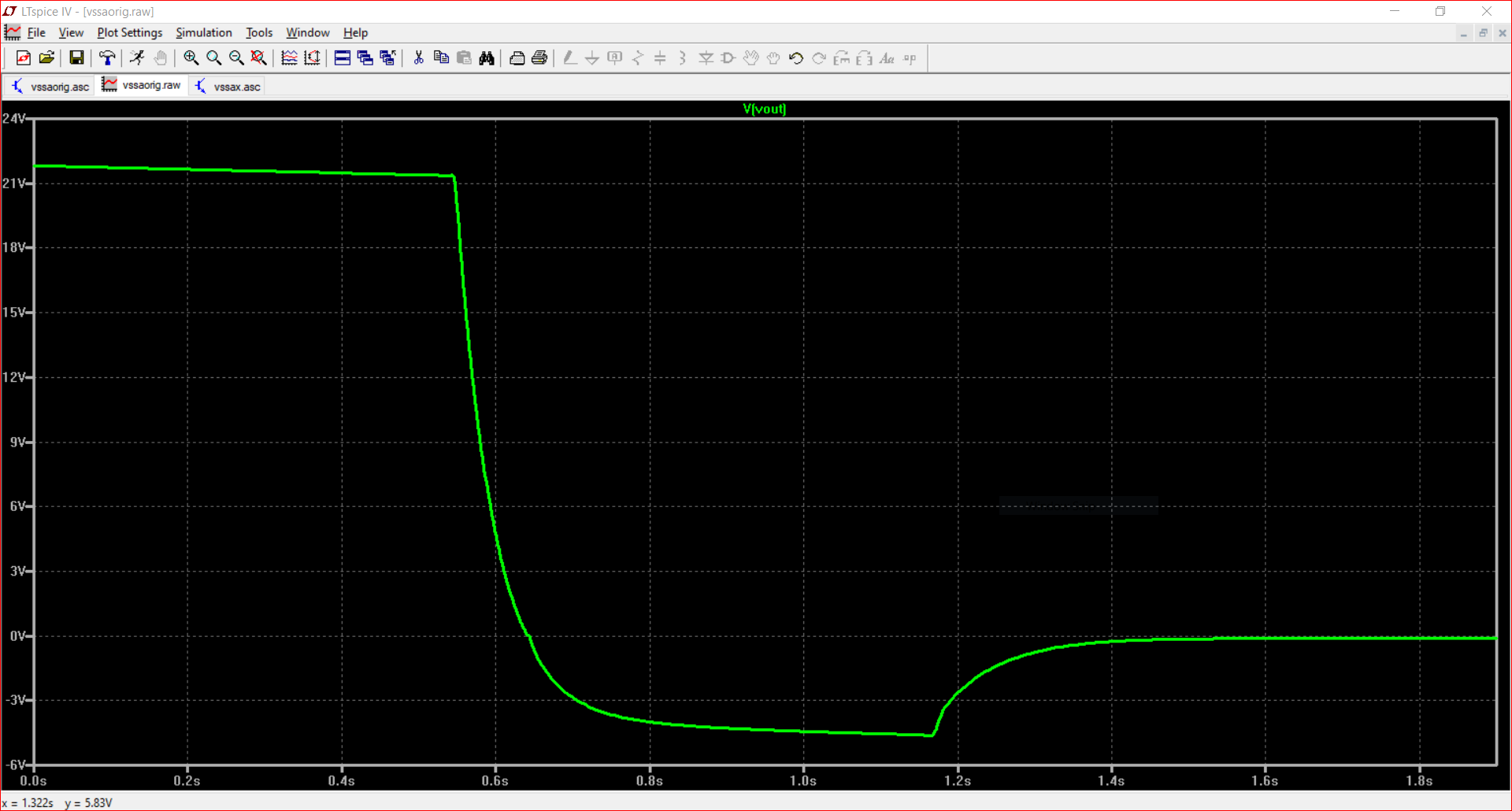

Do you mean it settles to -27 V when you wait for 100 ms or more? Is -27 V also the voltage at t = 0? If so, it is very different from ctrlx's plot.
The image attached suggests the voltage gets down close to zero volts eventually. Running the simulation on 1kHz sine wave showed the dc persisted throughout. This also shows up on a dc operating point list. There is 150 odd m.A. of current passing through R10.

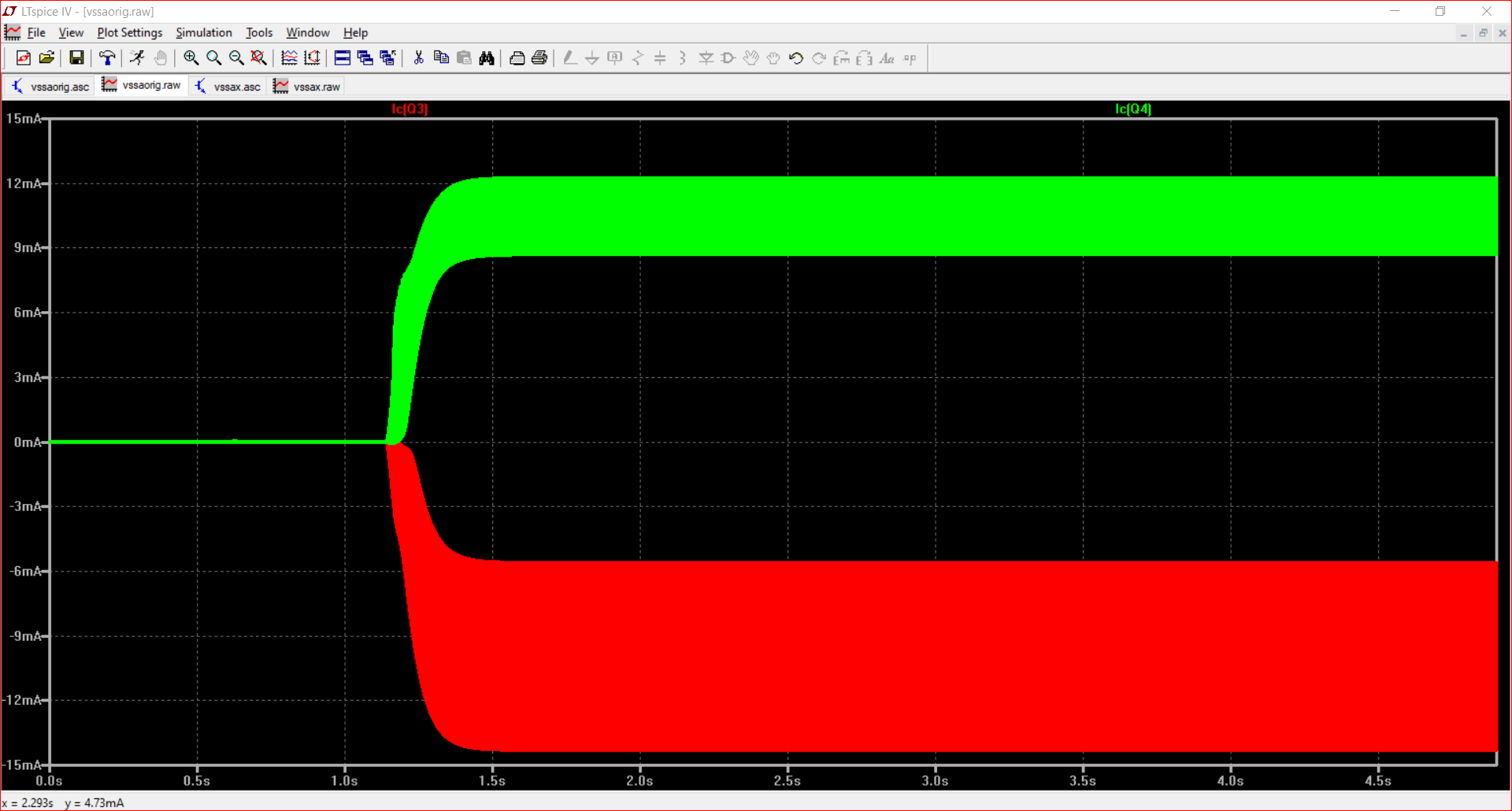

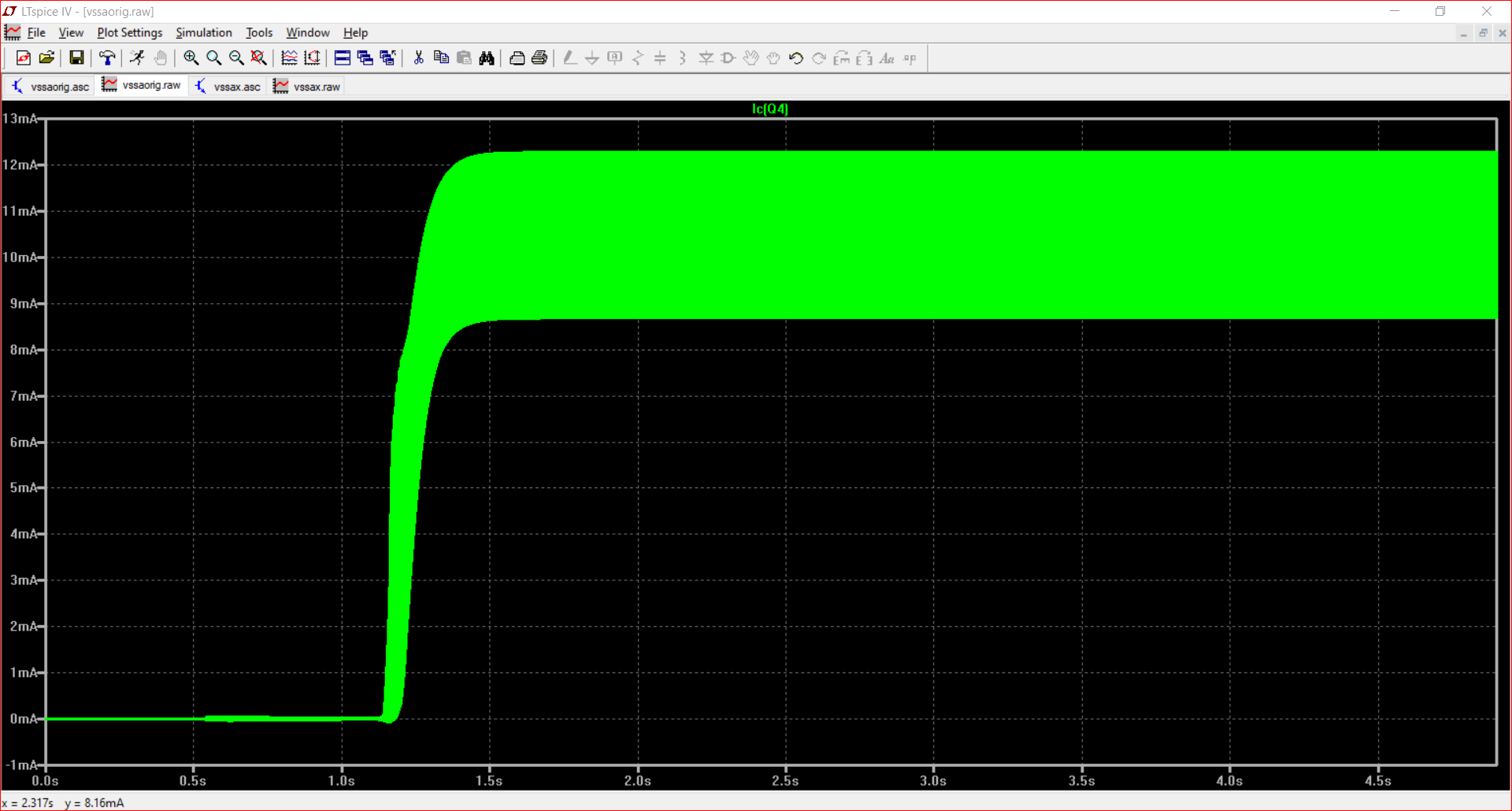

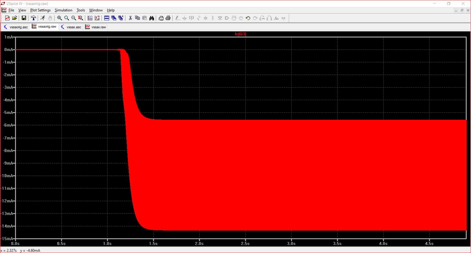

I ran the simulation for an increased number of cycles starting at 100ms and ending at 5 seconds. The plots for Q3 and Q4 are attached, also Q3 and Q4 together.
I have included my .asc file since the plot develops between t=0s and about 1.1s and this part shrinks as time increases. Those Q3 and Q4 Ic operating bands end up getting pretty thick.

I've simulated the operating point of the circuit of the .asc file of post #26 with the Bob Cordell models, and even though LTspice doesn't give any warnings about convergence issues, it looks like there is some numerical problem or a modelling issue related to Q4. The results are totally unphysical and become normal again when reltol is reduced to 0.0001.
The simulated DC output voltage with the default reltol of 0.001 is -27.1038 V. Q1 is off (collector current -35.1612 pA) and Q4's collector, base and emitter are at -36.3855 V, -36.2871 V and -36.8024 V with respect to ground, respectively. Although the base is slightly above the collector, it is probably not far enough to cause phase inversion due to hard saturation of Q4.
Q4 has a current of 153.246 mA flowing into its collector and a current of 7.89976 mA flowing out of its base, even though it is an NPN. NPN transistors can have large negative base currents due to avalanche effects when the collector-base voltage is higher than BVCEO, but when there is hardly any voltage across the device, it makes no sense at all.
Using reltol=0.0001 changes the DC output voltage to -0.115966 V.
