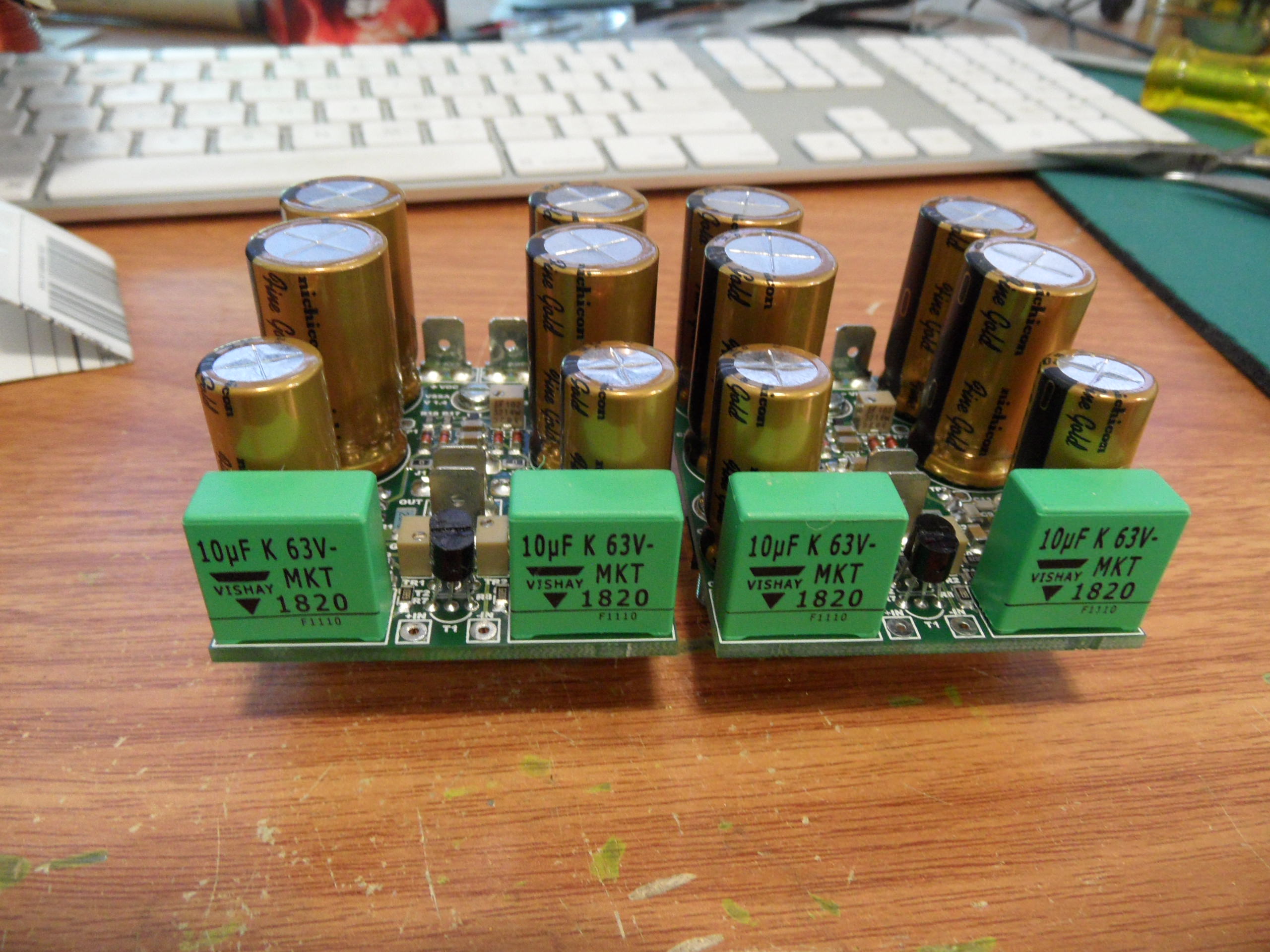

Yes, those long hours to listen and compare, and feel a solution sound better with this record, and worse with this other oneGuys, today's capacitors topic was the reason not to include capacitors in VSSA PCB set. Impressions which brand to use are so subjective that I simply left the decision to each individual.![]()
