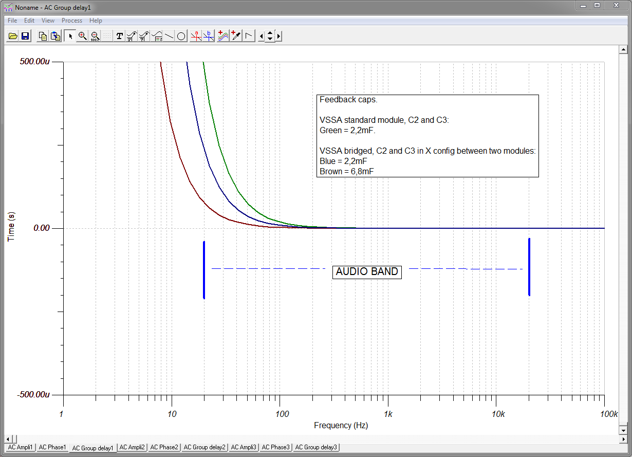

I attach simulation-plot of gained groupdelay in lows by using 6,8mF for feedback caps instead of 2,2mF, also X-config/virtuel-point gain can be seen compared to standard VSSA module. Wish you good setup/soldering and thanks for reports.
