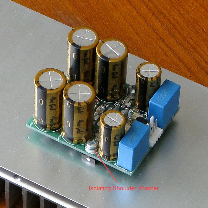

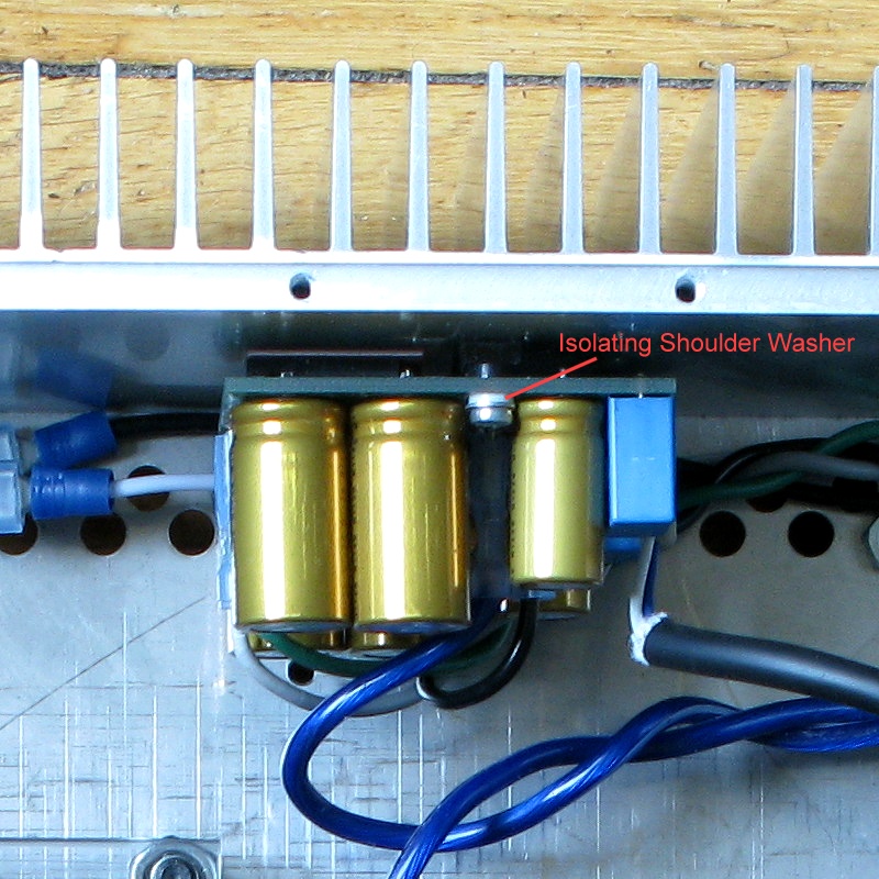

MAy-be you could do the following: Isolate the Boards from the heat sink ground, by using Canon isolators between the VAS screws and the board ground.@BYRTT: It is a mechanical problem.
Verify Power device good isolation. Provide a good ground connection between Heat sink and chassis ground.

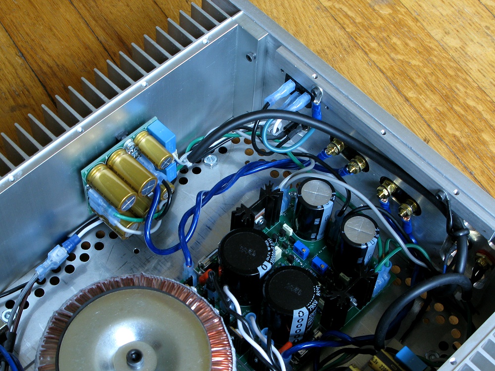

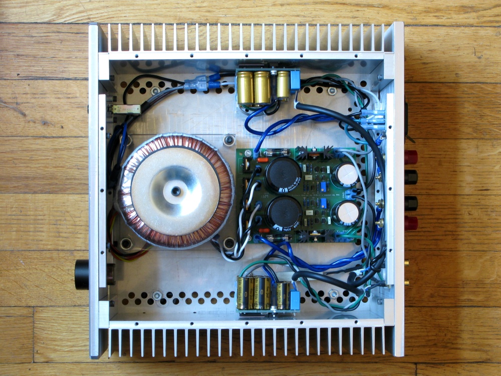

My boards were isolated from the beginning, using standard M3 shoulder washers, and the ground was always a single-point ground. The original ground scheme which was made for dual supplies was not ideal for my single supply, because there was no easy way to break the loops. The chassis (earth) and the power ground are connected through a 20R-5W, although not really visible in the pics. The ground lifter on the modules works well in my case, so it is not bypassed. Diode mod will be done in a week or two, when I install a bigger transformer, and switch to a higher voltage supply rail.MAy-be you could do the following: Isolate the Boards from the heat sink ground, by using Canon isolators between the VAS screws and the board ground.
Resistance to ground between all parts was checked when assembled. I posted pics of the chassis earlier, reposting w. more detail below.
I think we can close this as an issue, I appreciate all the suggestions received, thanks!!!
