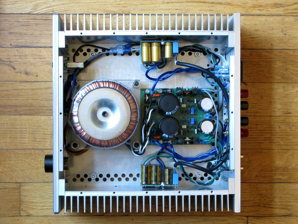

I finally got some time to play with my VSSA, I had modded like on this post
http://www.diyaudio.com/forums/vendors-bazaar/225747-vssa-lateral-mosfet-amplifier-253.html#post3652831
All the setup went fine (those trimmers should maybe be of lower values since just barely turning them would make huge jump) and I just now saw that there is an error in the doc, measure accross 22R/5W resistor should be 4V and not 3.52V so this is easy to fix.
Now, what is the deal with the R23 resistor. I just saw a post that says to bypass it? Why and will this have an impact on adjustments, do I have to readjust bias, etc..? What if I keep the resistor in place?
http://www.diyaudio.com/forums/vendors-bazaar/225747-vssa-lateral-mosfet-amplifier-189.html#post3562049
One last thing, the amp is not yet in a chassis since it is on test. I'm getting a huge hum (ground loop) from connected to my equipment (tried 3 preamps, one DAC) but when connected to my iPhone it all works properly, total silence... Do I have to implement the star ground on schematics for testing?

Hi Do,
I had exactly the same with 10R ground-lifting resistor still in circuit: apparently total dead with no input cable, or with the input cable connected to battery powered equipment (FLAC player or battery powered headphone amplifier even while the later was connected to a DAC linked to the PC !!!), and varying levels of hum when connected to other transformer supplied equipment 😕. Why after removing it the hum disappeared? I have no logical explanation, unfortunately. For some reason, it allows unwanted signals to ingress in the amplifier via the GND connection 😡. I am very curious to find a logical clarification, and also why in other setups it has an improving effect.
So the steps you might want to follow should be:
1)Short out the 10R resistor on each channel's PCB
2)Remove the connection between the heatsink and the GND by mounting isolating washers over the holes for fixing the VAS transistors (I use 3mm screws so I could perfectly use here some TO-220 isolating plastic washers).
3) Connect each GND (Left channel GND and right channel GND) to the case in only one point, the same point you connect the Earthing/Safety Ground of the power connector/cable and on each channel in the point where GND spade connects to the PCB. I used here a DDRC circuit instead of a wire to preserve the separation between GND and power outlet and also between the two channel grounds. You can connect this chassis wire also in the point between the main reservoir caps, if you will find (as myself) difficult to insert 3 wires into one FASTON spade (the chassis wire, the supply GND and the Speaker GND) but ideally you should keep the shortest and thickest possible wire for the supply GND.
4) Mount the input connectors isolated from the case (chassis) and you are good to go. Of course, take care that the GND has no other connection to the chassis except at the GND FASTON.
Well, this was my recipe at least, I am curious if you find this solution working for you. Except the DDRC this is an implementation that matches Andrej's schematic for grounding, and he reported also a hum-free setup. Thanks to Andrej for this schematic and thanks BYRTT for making an index for some important posts in his #2534 ( I have a Chrome tab permanently opened to this page)
One more important observation:
In the test phase I assume you have the PCB mounted on the heatsink. Please use the chassis wire of the PCB (that you will later connect to the chassis) tied in some point to the heatsink during tests, otherwise you might trigger HF oscillation that will smoke/burn some 10R resistors in the Zobel filter. That can happen as heatsink will be capacitively coupled to the output ALFET and you can close the loop if you touch the heatsink and some sensitive circuitry of the input area in the same time. You don't have this problem before isolating the mounting screws of the VAS transistors (step 2), for obvious reasons. But please be aware of this.
Good luck and please report your findings, as I would like to hopefully confirm my experience! And sorry for this long post 😀
