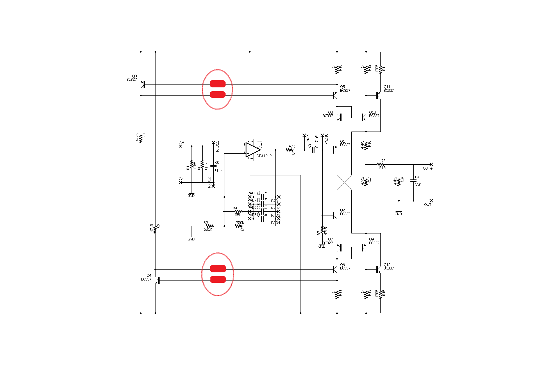

Just to double check, you are advising adding four resistors marked on the scheme below?
I've seen schematics both with and without, usually without. The Sapphire3 uses the same layout and I've not had any obvious problems with stability. Any thoughts on what's the best way to check?

I'd use an oscilloscope to view the voltage at the emitter of the current source transistor (Q5-Q6), and again at the base of the current source transistor. Apply a 50 kHz square wave to the amplifier input* and adjust its amplitude to get maximum output just before clipping. Search for ringing around the leading edge and falling edge. If you see ringing, yikes, take corrective action.
I think it would be cheap insurance to lay out the PCB including eight base stopper resistors. If that adds too much area, you can orient them vertically which reduces the footprint to 0.1" by 0.2". The stoppers are in series with the bases of Q13-Q16, and Q3-Q6 (designators in post 10 schematic, 4th image). Then if testing shows that you need base stoppers, you don't have to re-spin the PCB. If you don't need them, connect jumpers.
*I guess this would be sqwave -> inverse RIAA -> input. Or else perform the square wave tests before populating the capacitors in the opamp feedback network.

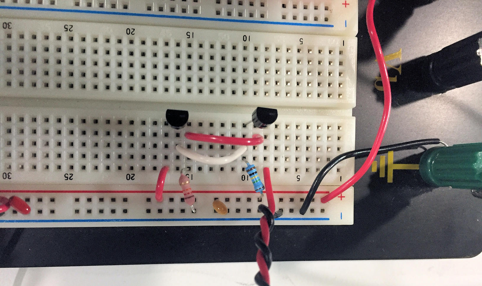

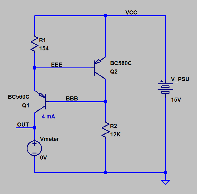

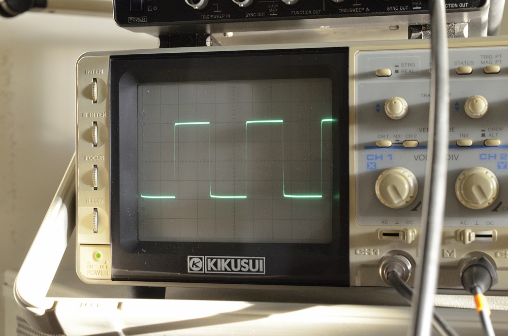

This little 2T CCS oscillated on my carefully laid out PCB so I copied it over to the solderless breadboard for further experiments. Here are a couple images. It oscillates on the solderless breadboard too.
Q2 is on the left in the photo, Q1 is on the right
node EEE is the white horizontal wire
node BBB is the red horizontal wire
left resistor (brown body) is 12K
right resistor (blue body) is 154R
yellow blob is 0.1uF ceramic cap (supply bypass)

I have that exact same breadboard &c so let me see if I can reproduce that.
Meanwhile, since you have that set up - what value resistors do you need where to kill that ringing? Does it make any difference if the transistors are placed closer together, or the bypass capacitance is increased?

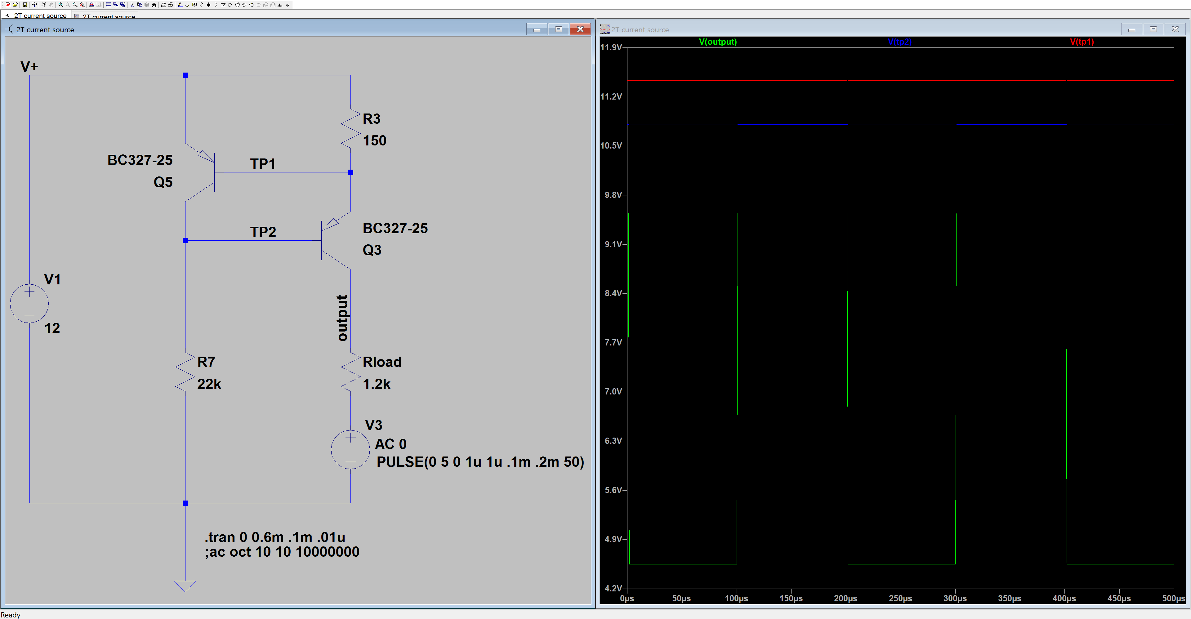

I decided that the parts count for the "repaired" 2T shunt feedback current source, was higher than the parts count for other current source designs. So I don't use the 2T shunt feedback current source with base stoppers myself, and I don't have recommended resistor values to suggest. Very sorry. A very crude "severe overkill" rule of thumb might be: make the RC timeconstant of (BaseStopper x TransistorCbc) greater than 6 nanoseconds. This corresponds to a pole at 25 MHz, far less than the oscillation frequency on the scope trace. And also, far less than the fT of the small signal transistors you're likely to use. But remember: I haven't tried this rule-of-thumb myself, in the lab. It's just an opinion.
Instead I tend to gravitate towards variations upon the theme of 3 diodes + 2 resistors + 2 transistors in cascode. For example posts #72 and #34 in this thread

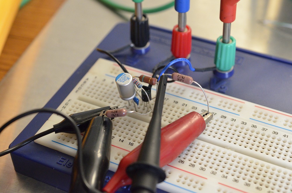

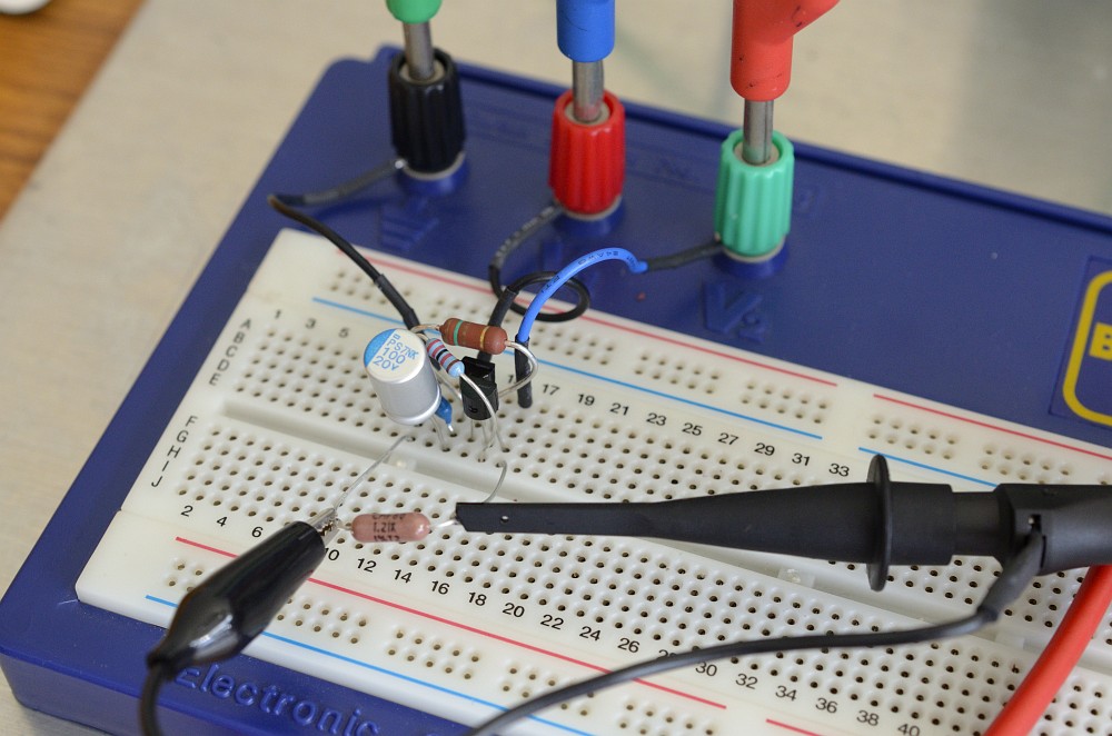

Just the resistance of the ammeter shunt which, at 4mA, is probably in the neighborhood of 50 ohms. The collector is tied to ammeter+ and ground is tied to ammeter-. The schematic shows this as "Vmeter". The red and black twisted pair in the photo, go to the ammeter.

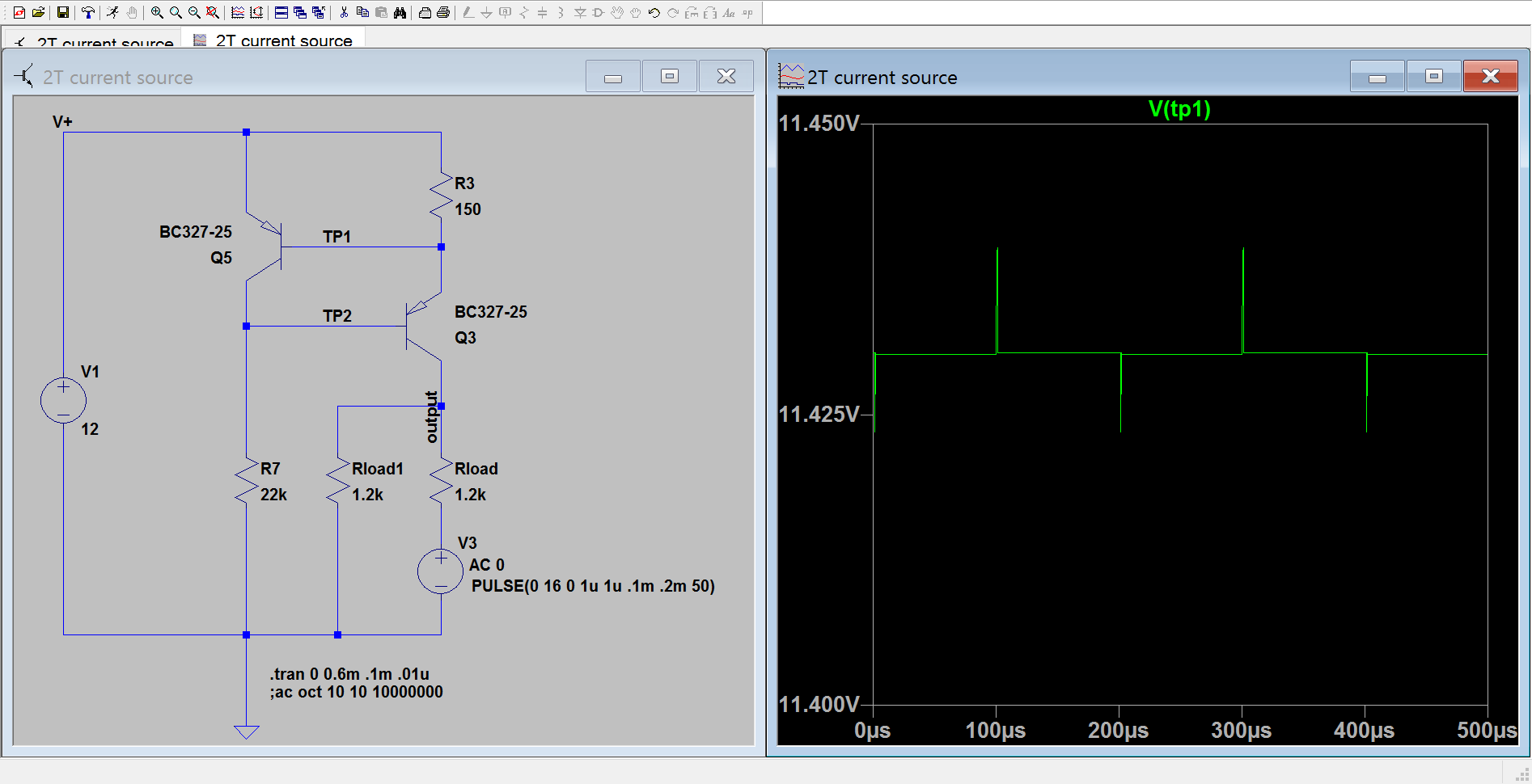

It's quiet as a sleeping baby when I try it. Exactly as simulated.
I'm just measuring DC operation though, at the output, I haven't forced an excitation like the square pulse shown in the sim, nor did I check TP1/TP1 (EEE/BBB). What did you do to get it to oscillate?

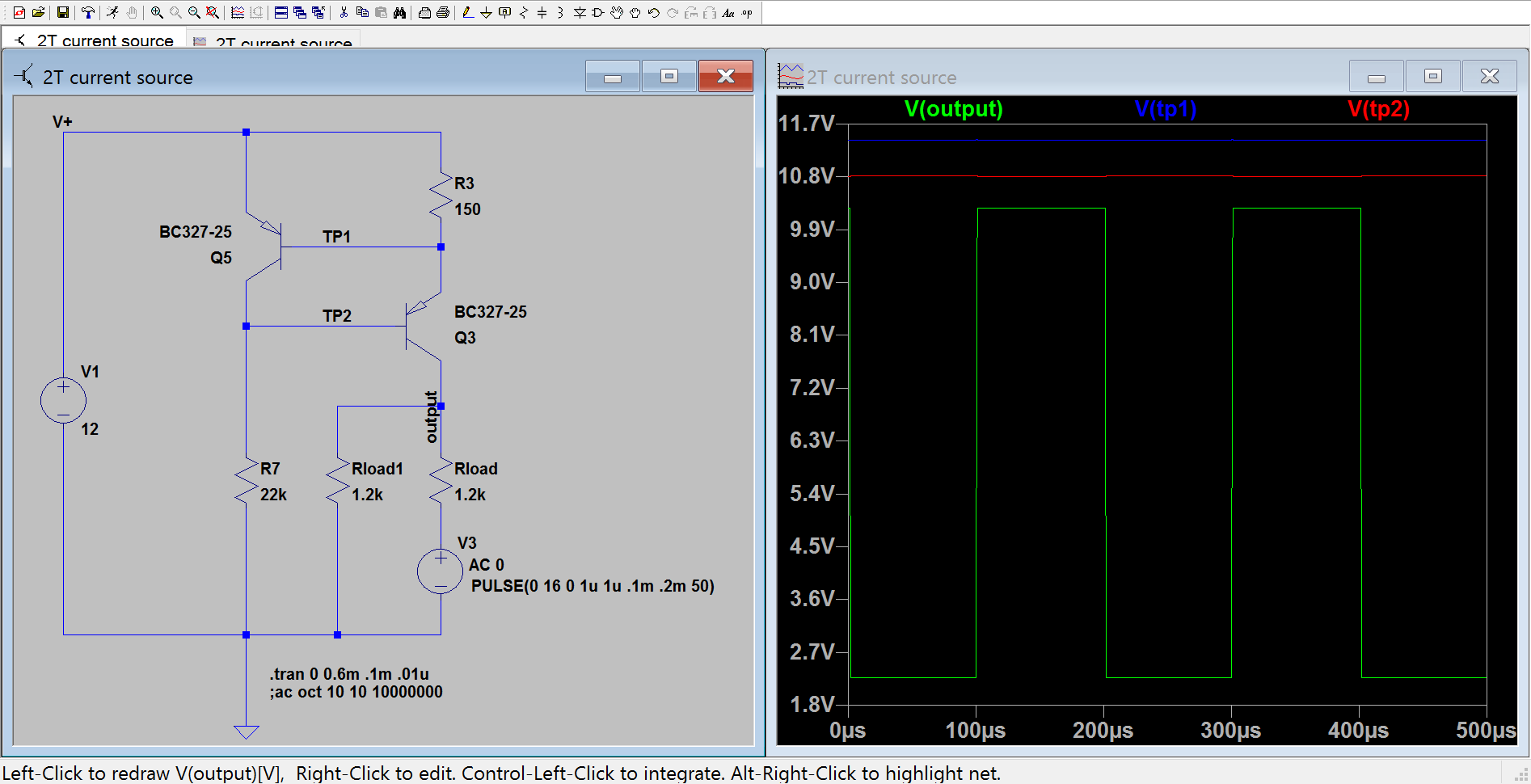

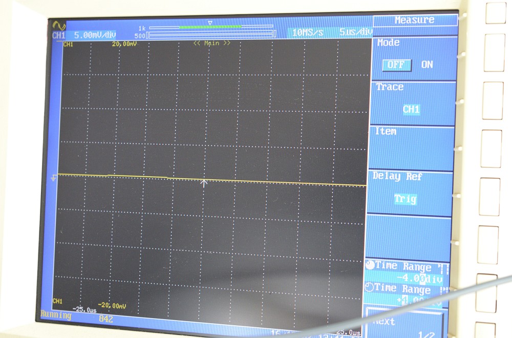

No, nuffink.
It's all clean, no trace of anything whatsoever at static bias. Finally I drove the output with a 16V p-p 50 kHz square wave, as shown in the schematic. The output goes from about 2 to 10 V. Clean as a whistle, exactly as simulated. TP1 and TP2 show minute spikes on the rising and falling edges with no ringing whatsoever, again as shown in the simulation.
/end investigation
