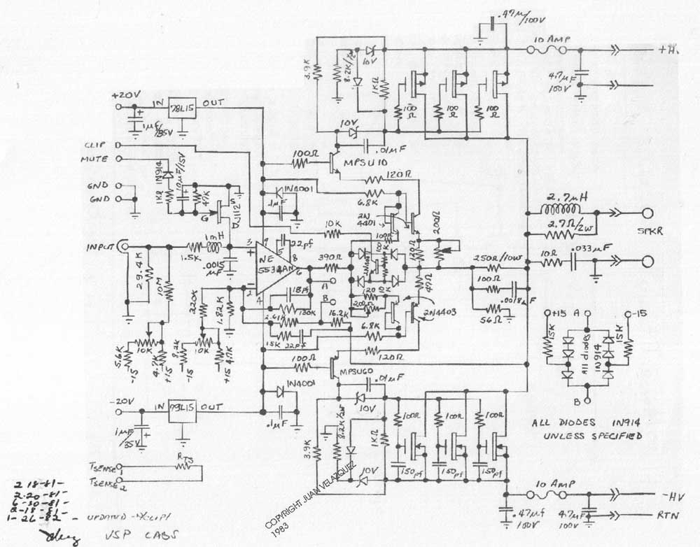

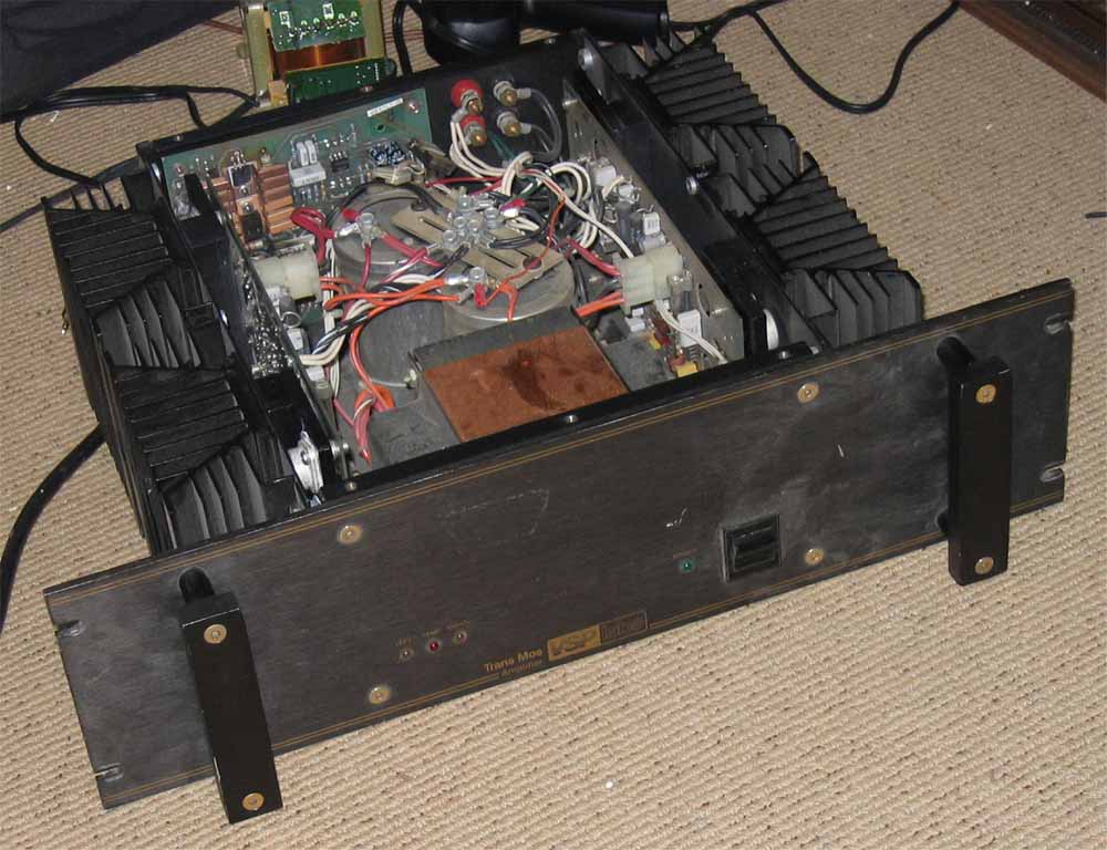

I own one of these, bought it new in 1981. It was gradually deteriorating for years, finally blew last year (taking 2 woofers with it...). Are there any CURRENT schematics available? Would love to find someone who can bring it back to life. It was a great amp, though it did run hot. ~ Dan
considering that there was some damage to one channel including the pcb's, AND the parts were expensive, AND the FETs were subject to degradation, I decided that I got a good deal on a big power supply and massive heat sinks and am looking to use some diy circuitry instead of repairing it. The only circuit diagrams I am aware of are those listed in the thread but you can always google. Yes, the one channel did sound nice.

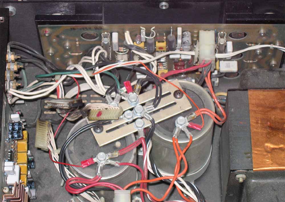

I do know that these amps, and others like it do run hot. However after looking at the posted pics earlier, I did notice that a connector and one circuit board did have serious heating problems. Not saying that the circuits are of poor design, but more so in dealing with the heat! It's been a long time since I have seen these units. I now seem to think that if the cabinet had a different design, and a cooling fan, that the problem could have been eliminated.

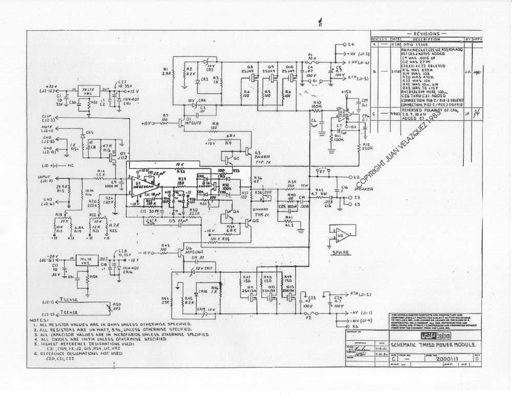

this link unfortunately NO LONGER WORK as it seems the website is defunct....I'm also the proud owner of the pristine TRANS MOS but not the gold version and am affraid to power her up before checking the voltages biases etc without the loads...As you can tell i dont have much confidence in the FUSES (if any) and i do not want to burn any speaker drivers...FYI previous owner drove very unstable and demanding THIELs 3600 with it and only sold it because he purchased a monster AMPZILLA dirt cheap...any info would be appreciated--primarily working schemat in PDF no longer avail...BTW did you get your unit going yet,,,THNX for posting all other stuff re. this dinasourus...Best of luck 2 y'a

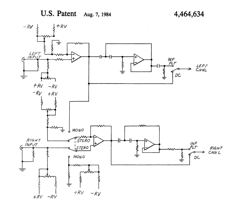

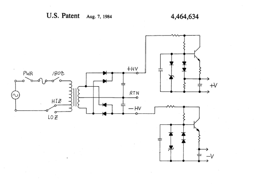

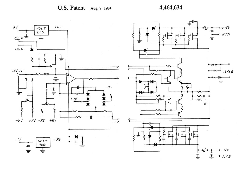

Here is a PDF containing a working production version of the VSP Labs Transmos 150.
Lots more work to do but I see a full restoration coming my way and if I'm lucky there will be tweaks. Any thoughts from the DIY folks here? I'd love to hear your impressions of this circuit!

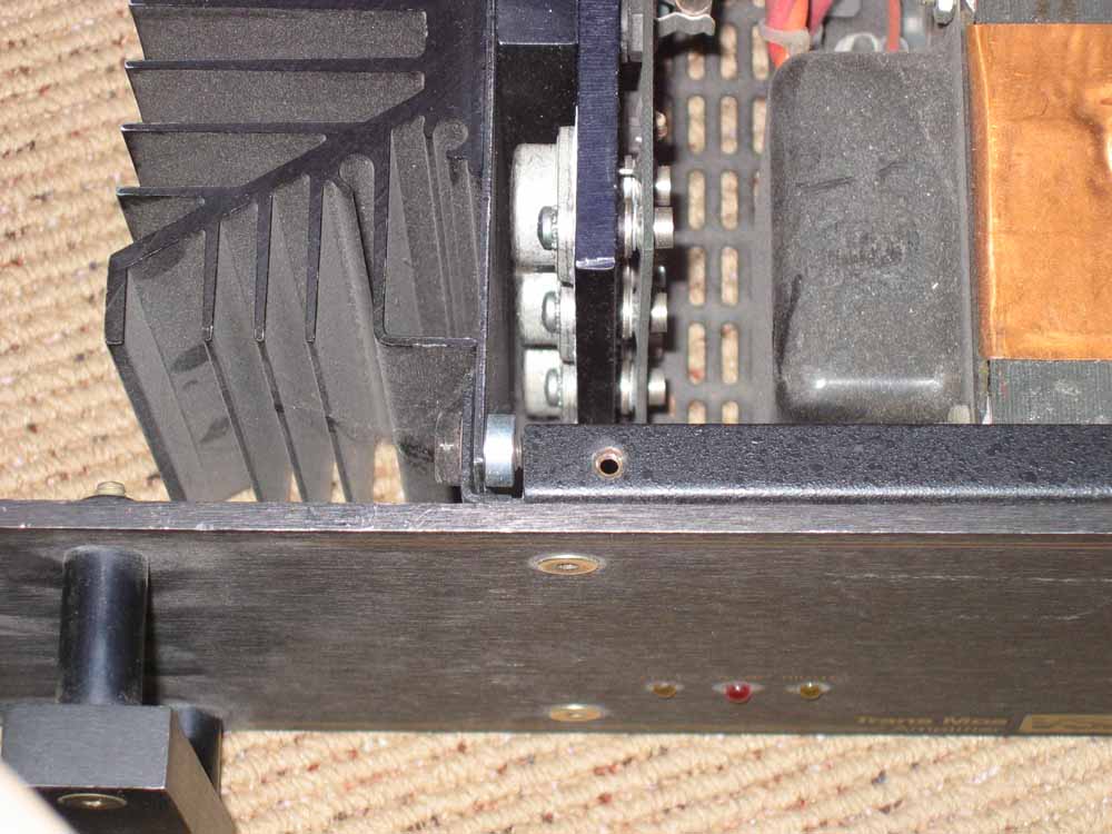

Hallo Guys
This is my VSP Labs TransMOS 150 ...,
i have since i got it not found any issues which needs img. attention.
There is a few upgrades i have planned to make .., ill share some pictures asap.
Get the missing PDF here:
VSP Labs TransMOS 150 - PDF
