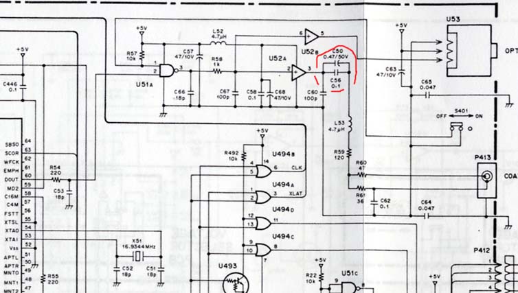

I've an old 10 years VRDS10 and I'm changing some old caps for new one (power supply and coupling/decoupling caps first). I use it only as drive.
I've a question concerning the digital output.
I've found in the digital output circuit an 0.47UF + 100nF caps used to couple signal to the next stage. Do we have a way to improve this or not? What's the best? Just change the 0.47UF for a new one or another solution?
I've enclosed the schematic and wrote a red circle to show.
Thanks for your help and ideas.

IMO it's safe to replace with a single 0.47uf film capacitor (WIMA MKP), check for the distance between the holes in the board before you buy it.
The PCB est standard. Most the hole are 5mm. The problem is more W.
I'm not sure that 0,47UF exist for MKT or FKP series.
We can may be replace both 0.47UF and 0.1UF by an unique 0.1UF polypropylene caps? I'm thinking to MKP1837 serie from Wishay.
Here's a good search engine: Farnell UK website search for 0.47uf
You want to know if you can replace 0.47uf+0.1uf with 1uf I suppose... Either 0.47uf alone or 1uf will do.
The UK Farnell search engine is realy great. We don't have this in the French site (who is slow too).
Unfortunaly, a 0.47UF polypropylene caps from Wima MKP4 is realy too big to fit, and I'm not sure that this kind of caps is occurate to couple digital signal.
Wishay MKP1837 stop at 0.1uF and Wima FKP2 at 10nF.

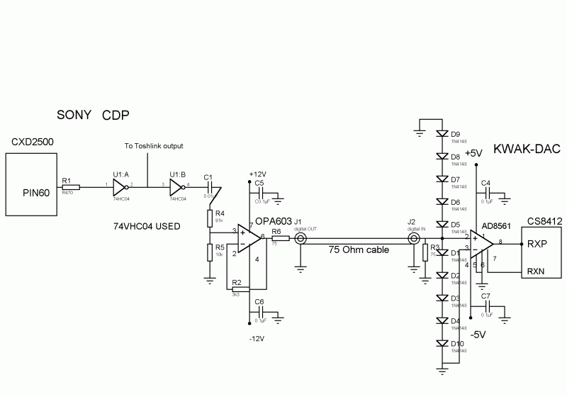

What is the advantage to use an opamp to "clean" the spdif signal instead of the passive way used in the VRDS?
Stef...
ps: resolution of mister Kwak's schematic is low and values are difficult to read. 😉
Stef...
stef1777 said:What is the advantage to use an opamp to "clean" the spdif signal instead of the passive way used in the VRDS?
Stef...
Bonjour Mr. Stef,
If you enable your email I can send you a higher resolution schematic.....Or better just email me and I will reply with the schematic attached.
The opamp is not to "clean" the signal but to have a low output impedance, ideally zero Ohms, before the 75 Ohm terminating resistor and to have sufficient "drive".😎

Ok, I better understand now. This solution is less expensive than to use a digital transformer. I used Lundahl transformer in the past but I was not really happy with them.
I've already downloaded the kwak-clock-7 package. The design is really great. I'm just afraid to build it as no PCB available. This kind of "high frequency" circuit are not easy to manage with a veroboard, and build a good working PCB worse.
Sorry if I go back to my original question: replace the 0.47UF and the 0.1UF caps with an unique 0.1UF polypropylene caps will work or not?
Yes
Yes, it will work I believe.
