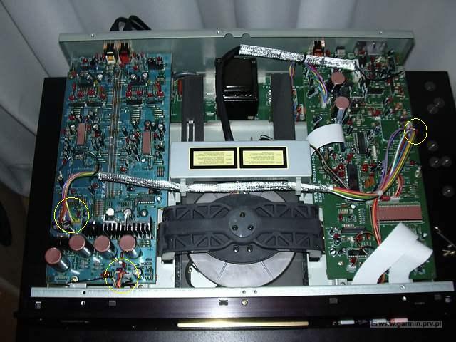

I've got a Teac VRDS 20 that I use as a transport. A few years ago I disconnected the analog boards as I didn't use them, more juice for the digital part and no interference etc.
Now I reconnected it all, and suddenly I have a weird problem.
There are two relais on the balanced board, and they click like crazy. A few clicks during power-up, when starting a cd, when paused, when skipping to the next track. And no sound whatsoever, just a few thumps. I checked whatever I could (I'm not a digital techie..) but there's nothing broken etc.
I also can't remember hearing those clicks when I first got the player, they're pretty loud.
Now the funny thing is that this does not occur when I use a mains isolation transformer...
Maybe it's too late, and I should sleep on it, but I'm completely lost here: what's the difference???😕
Does anyone have an idea?

Sounds like bad grounding (oxidation) to me, that can do really weird things. Thoroughly clean every connector on the board (and its counterpart on the cable) and try again.

Mine's a bit different:
I disconnected the two connectors coming 'from the other side', circled in yellow.

I don't know the reason for that either because the power transformer inside the Teac already isolates the player from the mains. It's an inherent trait of a transformer with separate primary and secondary windings (I'm assuming the VRDS-20 has such a transformer).
BTW, in your picture I see a black wire with a cable lug just hanging there. Shouldn't that be attached to the frame somewhere?

That's the earth for the harness shield, possible that could be the culprit.

Sorry guys, I took everything apart to find the fault, and didn't screw everything back just to take a picture😀 The boards are loose too. Of course those earth lugs are connected when the player's put back together.

The connector cleaning didn't do much, so I just let it play for a while to see if a 'warm up' would help. And it stopped the clicking! But still no sound
As I had run out of options for the analog pcb I went back to the servo board. Although it's a major PITA to get it out
Previously I had altered the S/PDIF out, so I checked if I didn't miss anything when returning it to it's original state. Everything was fine, maybe some small particles on the pcb. I brushed it off and hey presto: it worked again!!
I've spent countless hours on the darn thing, so imagine my happy dance😀
End of this story, thanks for the help everyone!
