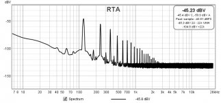

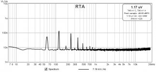

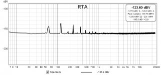

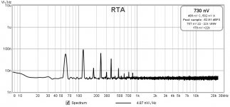

VRDN Measurements another try
I am posting measurements of my 1st VRDN board. It is set to 12V and had a 66mA load for all the measurements. Both rails use OnSemi regulators. I changed the compensation networks as recommended:
positive regulator 10nF + 0ohms
negative regulator 20nF (2 10nF paralleled)+ 0ohms
positive output capacitor ESR resistor changed to .39ohms (closest I had)
negative output capacitor ESR resistor changed to 0ohms
Both output capacitors the recommended 2200uF capacitors.
All measurements made with REW and Focusrite Solo(3rd gen)with LNA.
Positive rail output noise
Negative rail output noise
Positive rail input ripple
Positive rail output ripple
Negative rail input ripple
Negative rail output ripple
Positive Rail had 4.87nV/sqrtHz at 1kHz
Positive rail PSRR is -94.7dBV
Negative rail had 7.19nV/sqrtHz at 1kHz
Negative rail PSRR is -91.1dBV
Bandwidth for noise measurements was 10-30kHz.
BTEW, the positive rail used a BC337 and the negative rail was swapped out for a ZTX951. I swear it had better noise with the BC327, but will need to swap it out again to verify.

Excellent job RickRay! Really well executed set of measurements that can be trusted.
For what is worth, negative rail result is practically the same as my today’s measurement of the same OnSemi LM337. At 11 V, I got 8 nV/rtHz with BC327 and you got at 12V 7.2 nV/rtHz with ZTX. So, at 21 V negative rail could end at 3 nV/rtHz. My PSRR measurement was also resulting in the very close numbers.
That's rather disappointing for denoiser type PSRR.
It should get 30-35dB over Cadj which goes around -75dB to -80dB. So around -110dB to -115dB. Depending on layout off-course.
