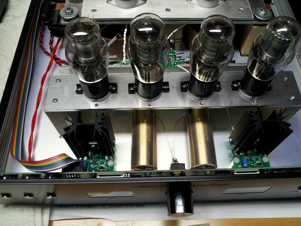

I find they work very well when a CCS is used to set the total current. I use them in my 26 preamp/DAC to set the voltage at 225V (0A3+0D3 in series) and it is very, very quiet, and sounds excellent. Total current = 29mA, current through 26 = 7mA.
I bypass the pairs on each side with a 0.1uF K40Y-9 Russian PIO, BTW.
And yes, they look very cool in operation but if they sounded like crap they'd be outta there! Not the case.
