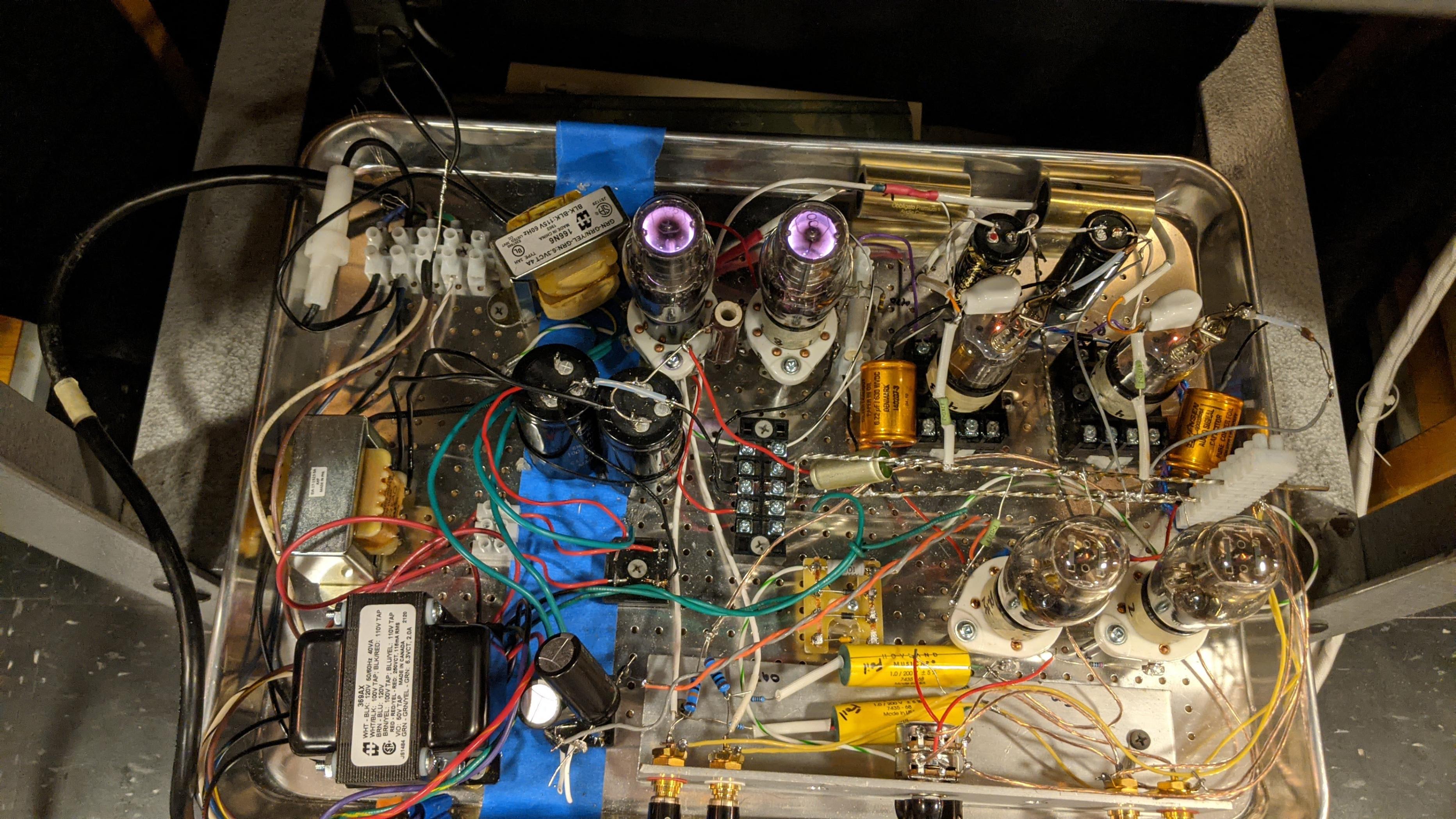

You can use them across the B+ to ground to regulate voltage. I am using two OC3 tubes in series to give me 210V regulated. There also OA3 = 75V and OD3 = 150V.

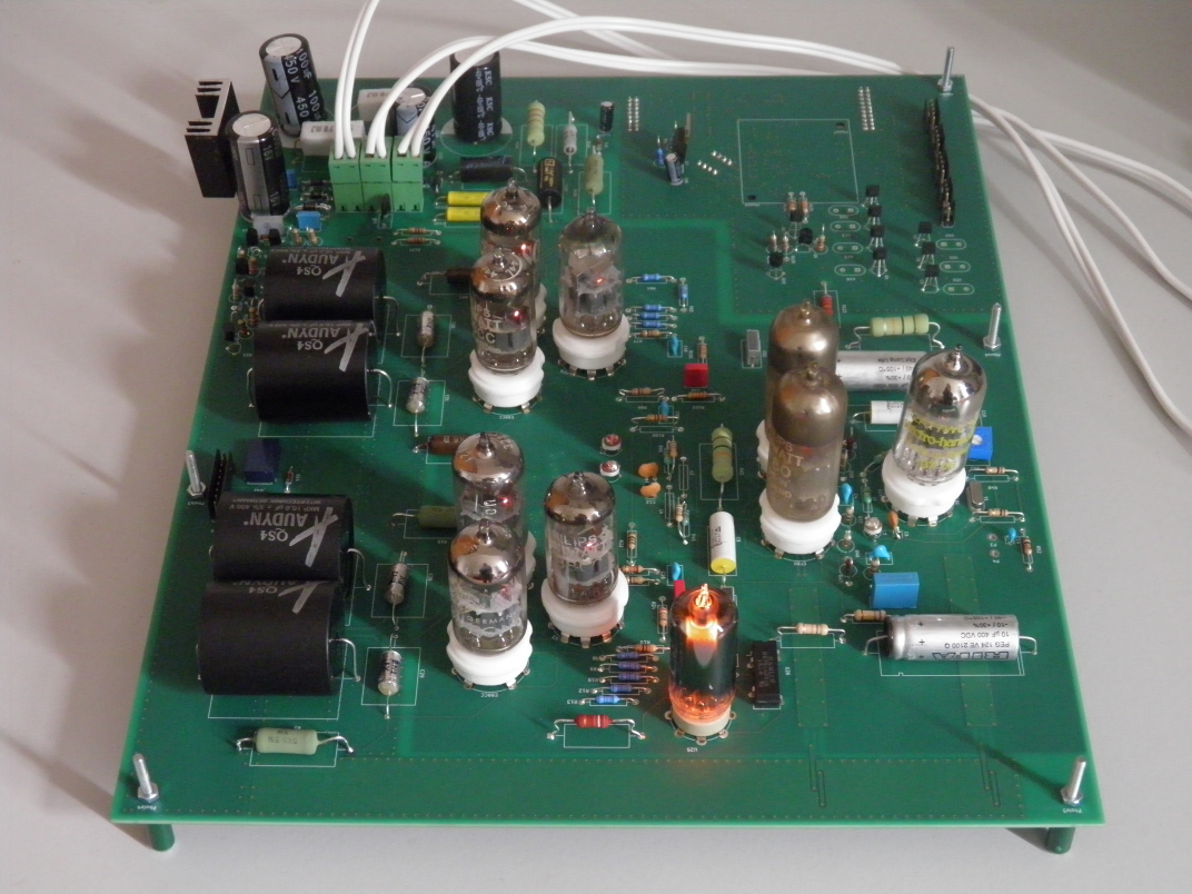

I use an 85A2 glow discharge reference tube as a voltage reference for my DAC, https://linearaudio.net/sites/linearaudio.net/files/03 Didden LA V13 mvdg.pdf The noise performance is actually pretty good when you look at the ratio of the noise to the DC reference voltage.
