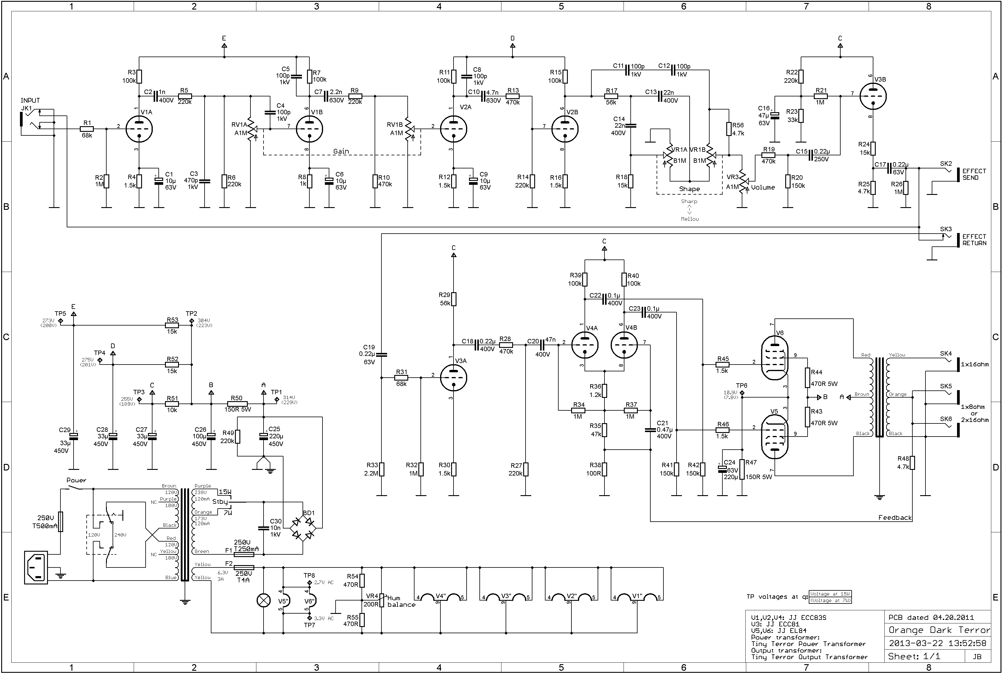

Thanks for the suggestions Kay, the iron is not yet purchased and there was a slight change of plans (it will be a dark terror instead of the 3015), but will do as advised.
The dark terror schematic calls for a 238V supply, but my trafo would do 260V, as what I see indicated on the schematic under load and whats in the tube datasheets, that extra 20-30Volts should also be in the maximum ratings.
The available OPT sadly only has an 8 ohm tap, thats where I got the tought to look up on mismatching. I have read dozens of pages on the topic and found this post by Jammin John the most complete write up.
But I still feel like theres only one way to find out what would it do to a given amplifier...
I also want to build in the "safety resistor" onto the OPT, is there an easy formula to determine its value? The AX84 P1 has 220 ohms on the 16 ohm tap.
For the dark terror and the EZ81 i think you can use the TSL100/001 from Indel for the supply and the TTG-EL84PP from Toroidy as output transformer.
Best replace the cathode resistor of the EL84 (150Ω 5W) by 270Ω 3W for each tube with also 2x 220µF 25V decoupling.This is to avoid a to great mismatch of the currents, toroidal transformers don't like that.

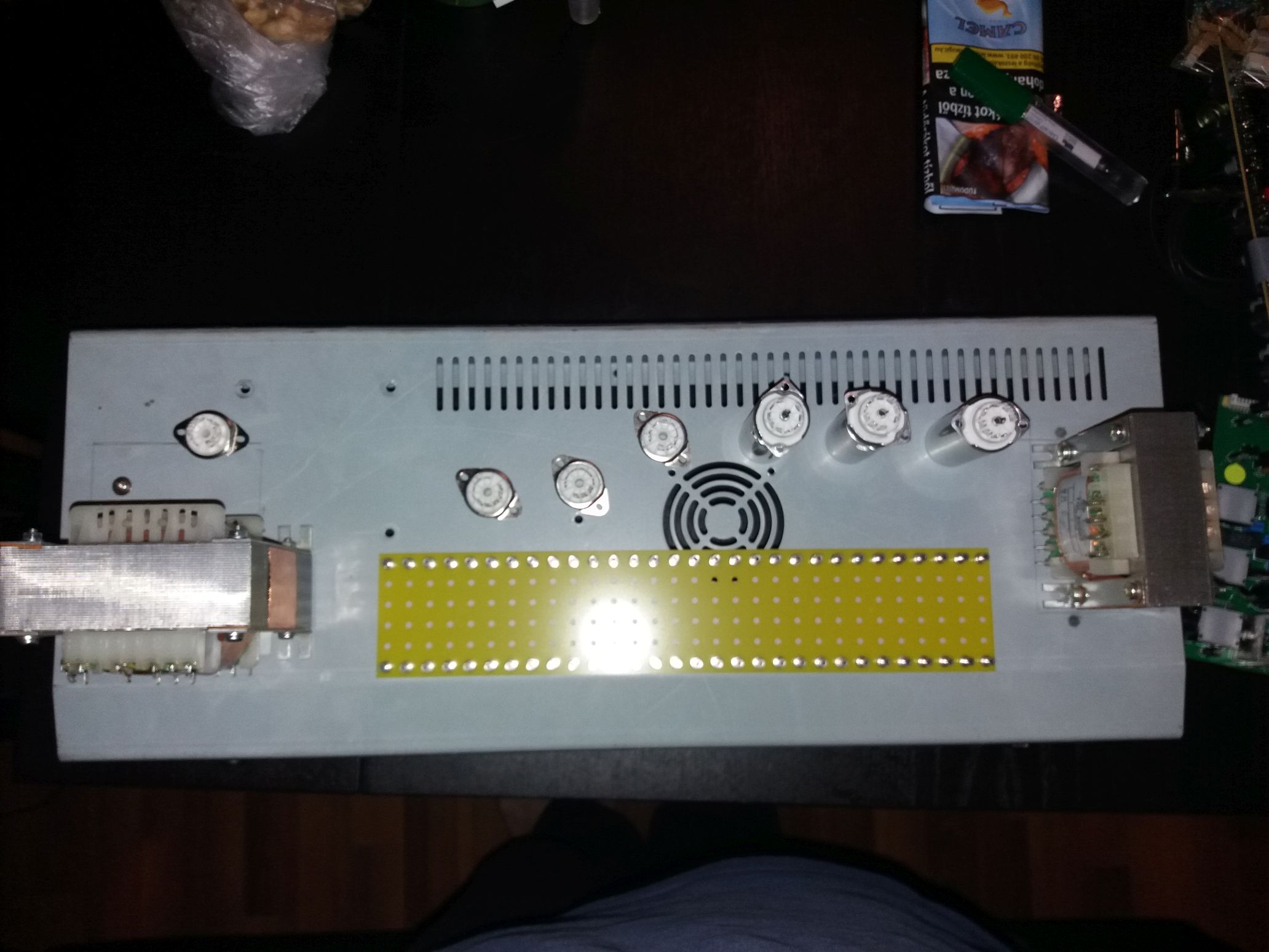

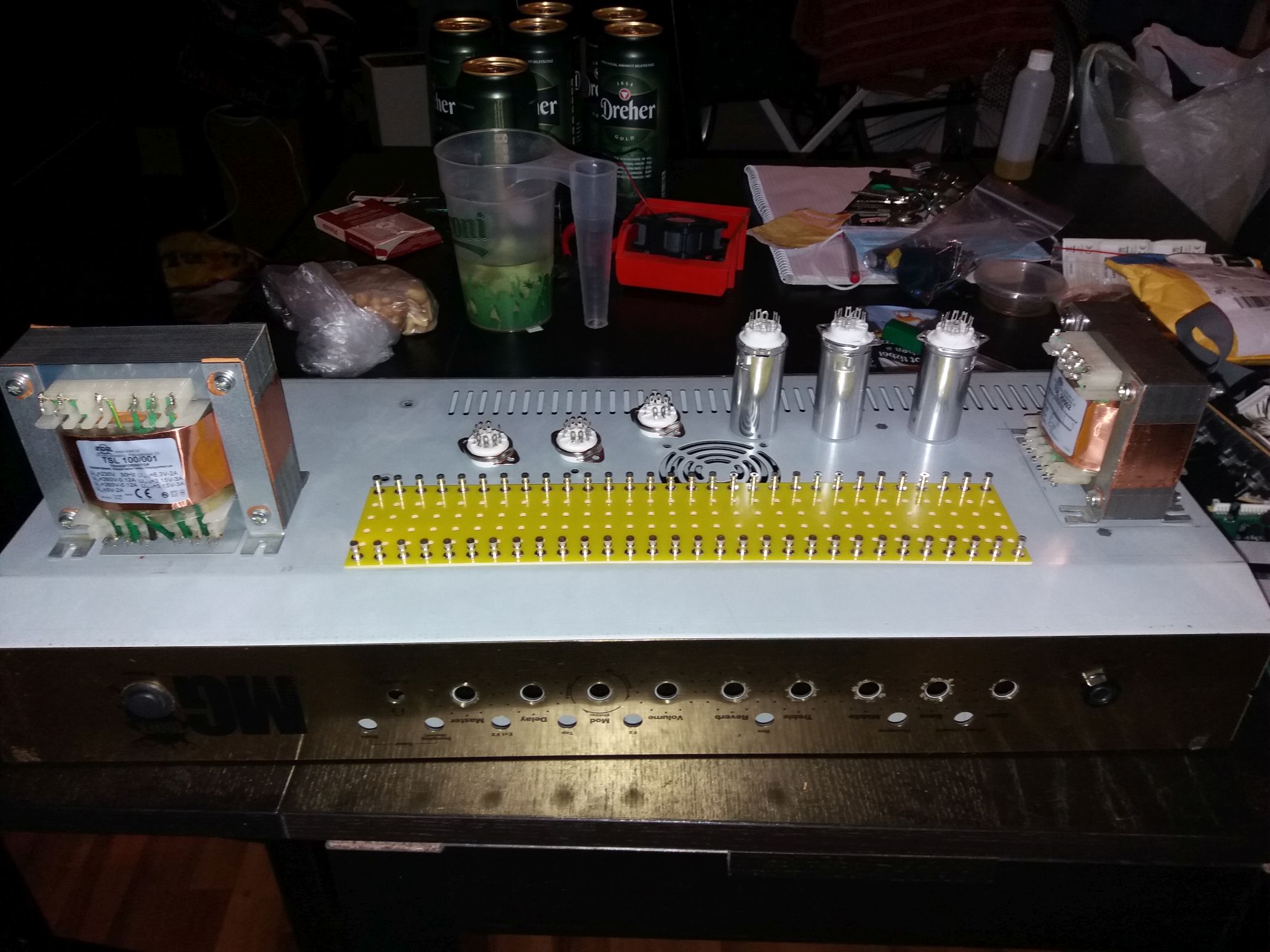

I got the parts together, now thinking about the layout.
Considering heat and weight reasons Im thinking about flipping the original box upside down, so the chassis will be sitting on the bottom of the box, tubes and others facing upwards. This way the weight will be sitting on the legs of the head, not pulling the top panel. Also the heat from the tubes can go up and out, instead of cooking everything under the chassis.
Any objections, problems that I do not see in advance?
From what info I gathered, I have came up with the component layout on the pictures. PT is on the left, behind it is the socket for the optional EZ81. Next to them are the sockets for the 2xEL84 (with option to fit 2 more if desired) and then the ECC81 of the effects loop, then the ECC83s of the preamp and the output transformer on the far right.
Could this work out properly?
As always thanks for your opinions and advices!

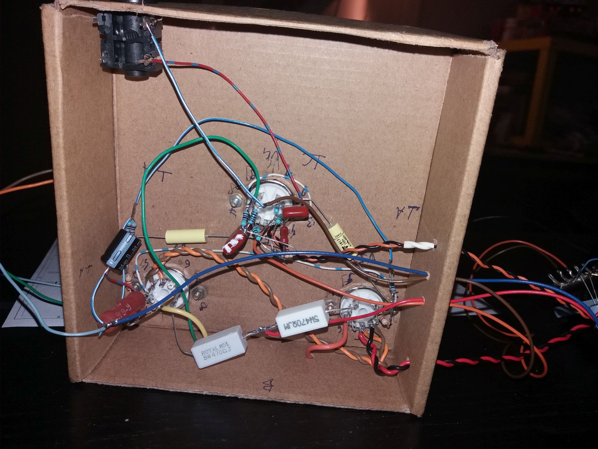

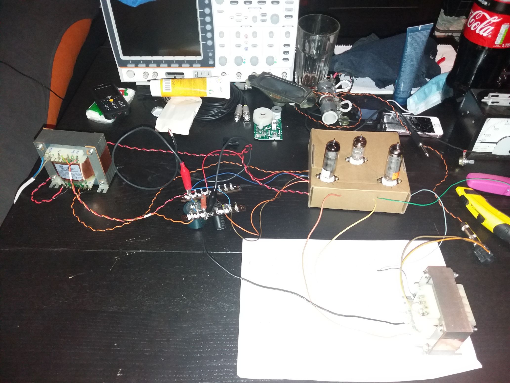

The iron has arrived and I had a little time, so whipped up a fast prototype for measuring and getting a feel for this PP thing.
Its late here as always, when I want to make noise 😀 so just did a quick test, the circuit seems to work fine with the russian tubes. But the feedback already bursted it into oscillation, so this build will be fun too.
WARNING: Extreme shock and fire hazard on the images 😛
