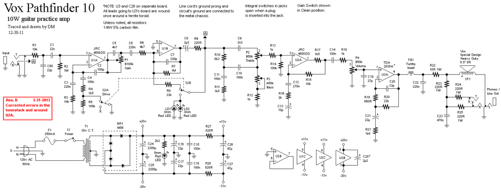

Hi! Looking on schematics of the Vox pathfinder 10 which I found on this forum. There is U1B op-amp which is configured as inverting band-pass, but after that I can't see nothing that will invert this signal back. So are this guitar amp supplies inverted singal directly to speaker? Or my understanding is somewhere wrong?
