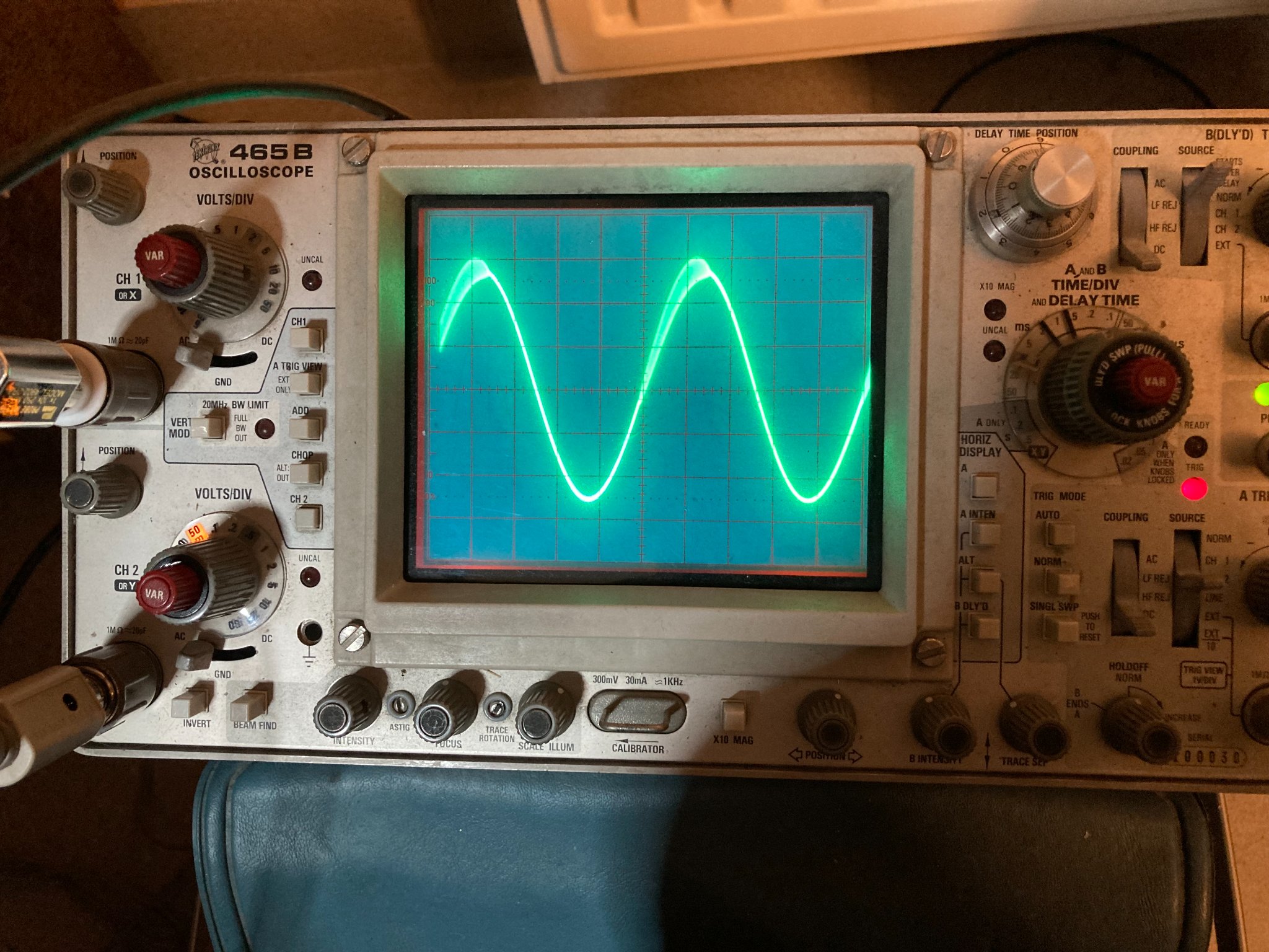

Working to bring a VOX Escort Bass 50 back to working condition and discovered this oscillation in the circuit that is a mystery to me.
See schematic attached. See also picture of the waveform on the scope, taken at the point between C3 and C6. The oscillation that is added onto the audio signal has a frequency of about 10 Mhz. The oscillation is only present at low audio frequency (up to a few hundreds of Hz) and is impacted by all controls, especially volume and treble.
Have done quite some experimenting and found the oscillation to reduce when touching the housing (collector) of one of the output transistors (TR6) with the probe of the oscilloscope. Adding a 10nF capacitor between the collector and the chassis eliminates the oscillation. Yes, to the chassis and not to ground.

Probing at junction of C3 and C6 should be a benign spot to probe. I suspect you might be using a x1 scope probe. Be sure to use a x10 probe, as the large capacitance of a x10 probe can provoke opamp oscillation.
Connect scope probe ground clip to signal common. If using x10 probe doesn't stop oscillation, disconnect C16 to isolate output amp from end and try to establish where oscillation originates. Keep us posted.

Thanks BSST. Yes, at 10MHz, the probe capacity is important. Have tested both using x1 and x10 but that did not have an impact. Also measured at different points in the opamp circuitry, they show the same oscillation. Will do the test with C16 disconnected, thanks for the suggestion !
At BSST : have disconnected C16, that does stop the oscillation completely.
At Loudthud : adding 100nF across C26 and C27 does not change the oscillation at all. There is no impact on the amplitude or lenght of the oscillation.
However, simply touching the housing of one of the power transistors, TR6, is enough to see a change in the amplitutde of the oscillation. Toucing TR7 has no effect whatsoever.
