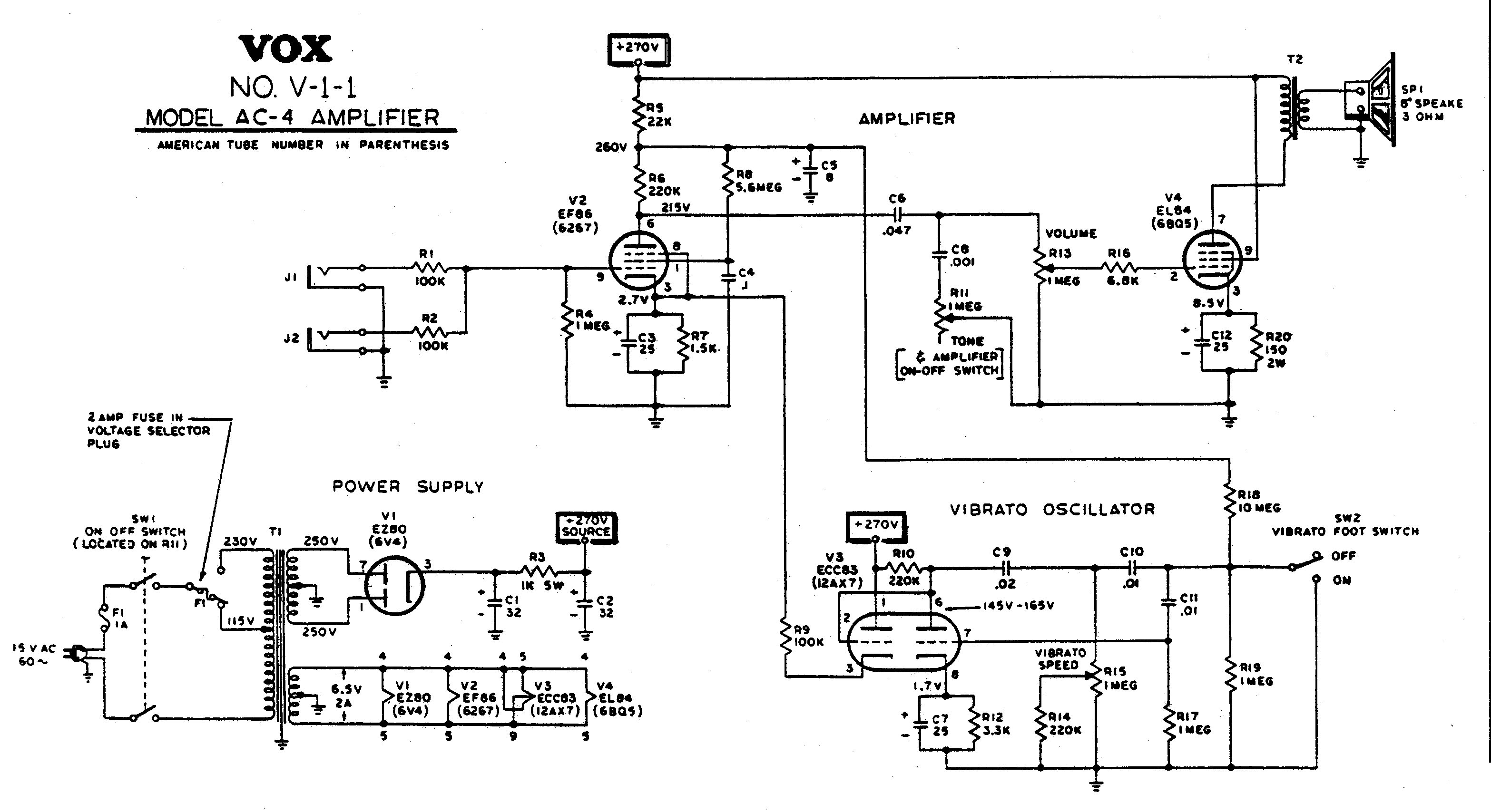

My son bought this amp off ebay. The guy decided to make some changes and decided to unload it. My son got it pretty cheap, but it's pretty messed up. The po lifted a bunch of traces and lifted parts at one end, and supposedly eliminated one of the preamp tubes?
So I am going to try and put it back to stock. At least he left most of the parts connected at one end. Here are a couple pictures showing the aftermath.
I can't find a good schematic. There is one out there, but I think it's from the guy who tore up the board. I guess I could trace it out, and get most of it.
Here a good (correct?) schematic of the amp.

Close but,
That is the AC4TV model. It only has 1 preamp tube. The AC4C1-BL has twopreamp tubes. I contacted Vox customer support but so far no answer.

couple of schematics to look at
These Vox amps are not very much different from each other on the inside. Kind of like the Marshall amps, the signal path is pretty much the same. Extra tube stages are used for reverb, fx buffers, tremolo/vibrato, etc. Depends on what options your model has. The vintage AC's had a pentode first stage, which give you that Jimmy Page overdrive sound.
The newer models are more like the clean channel of a marshall. 12ax7 instead of pentode, 2 stages instead of 1 pentode, gain knob in between stages. Next comes boost / cathode follower / tone stack / master volume knob. If it has an fx loop / reverb / tremolo, it will be combined with the tone stack recovery stage. Then comes the output stage. The newer models tend to sound a bit more fizzy or chimey than the old design. Rolling preamp tubes and/or upgrading signal path caps in the newer models makes them change character dramatically.
Here's a print of a basic model without any options:

what you have is the VOX "top-boost" channel preamp AC4 model. Same stage was used for AC15 or AC30's
I got the amp working today. It sounds pretty boxy? I may try some fiberfill like you use in a hi-fi cab. I didn't replace the bright cap that he removed. I don't think it's buzzy? The speaker breaks up way early. Some people like that? I will let my son decide what to do with it, since it is his amp.

My schematic shows R24 as 5.6k. If it's the correct one for your amp, it'll be the grid stopper on the EL84, and will connect the centre lug of the volume pot to pin 2 of the valve. I've also seen schematics listing the value as 6.8k, but having a brief flick through the versions I've collected, 5k6 is far the more common.
