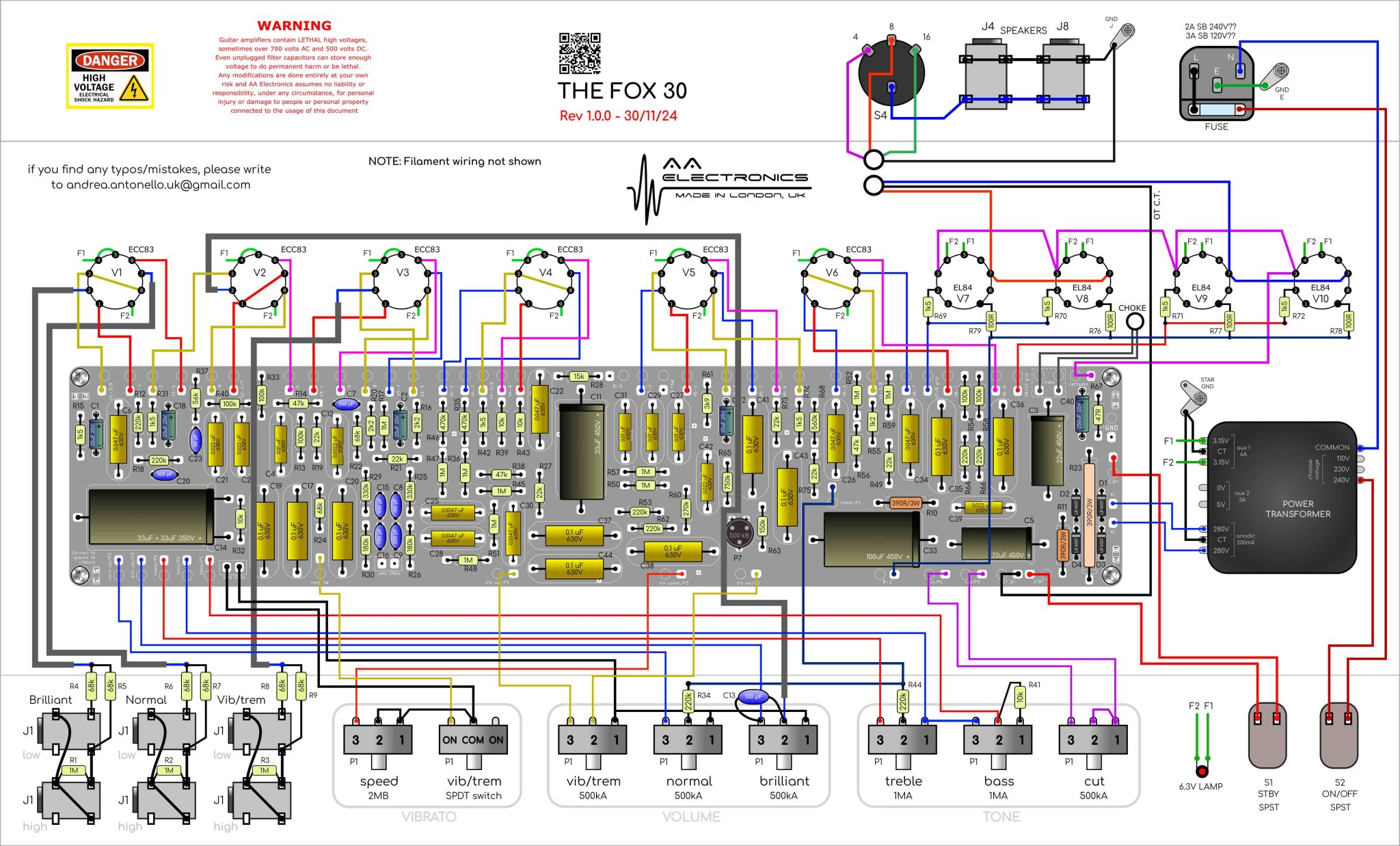

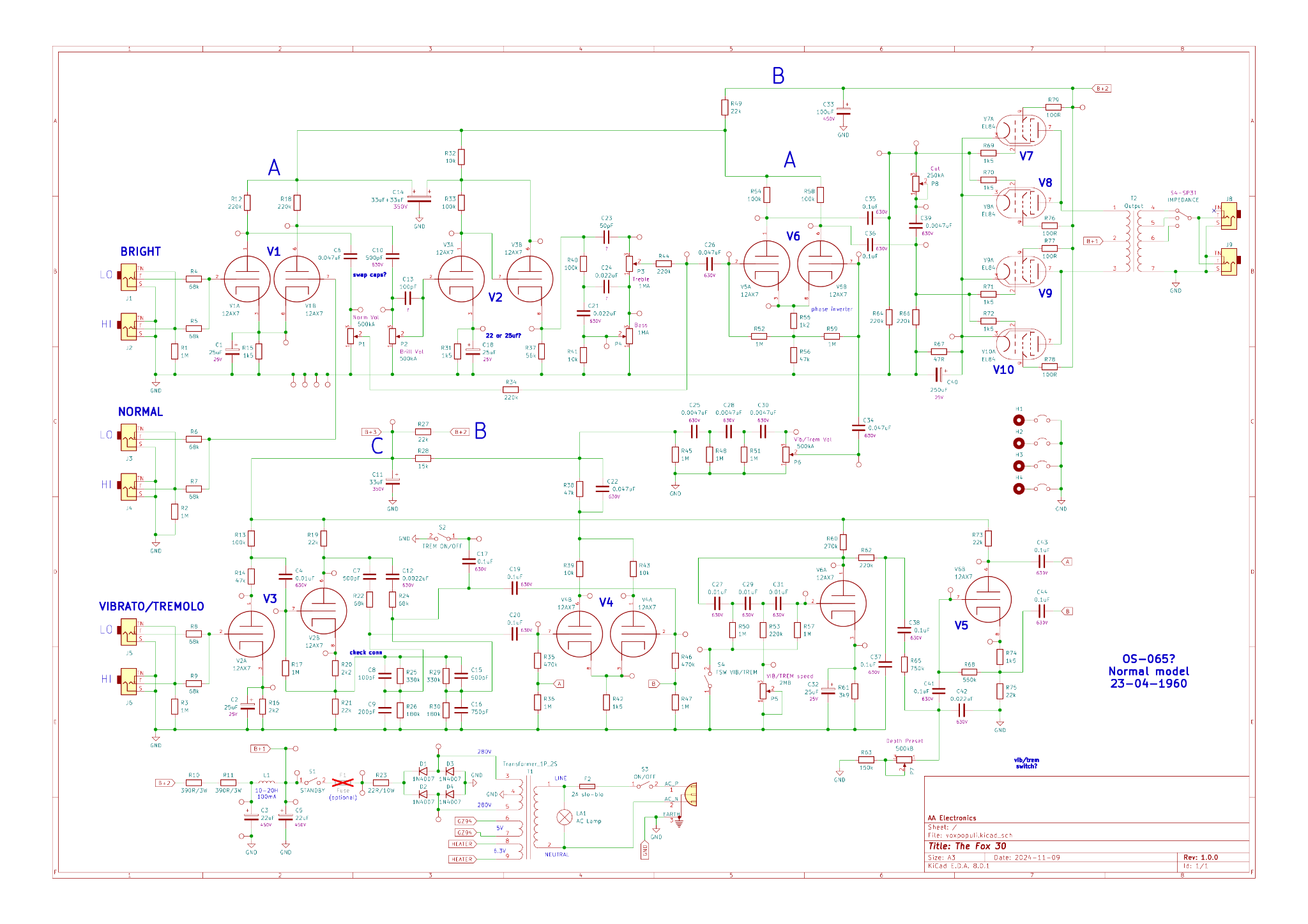

Hi all,
This is Andrea from AAElectronics (https://www.aaelectronicspcb.com/). After a lot of request, I've started design for a PCB for Vox AC30 style amps, with the aim to make it flexible enough to accommodate seevral variants (e.g., EF86 channel, Normal, the AC15 version or additional mods). I'll attach the layout, PCB, and schematic for reference.
Would love to get your input on my design, and whether you'd like to see/add something to the PCB/schematic.
