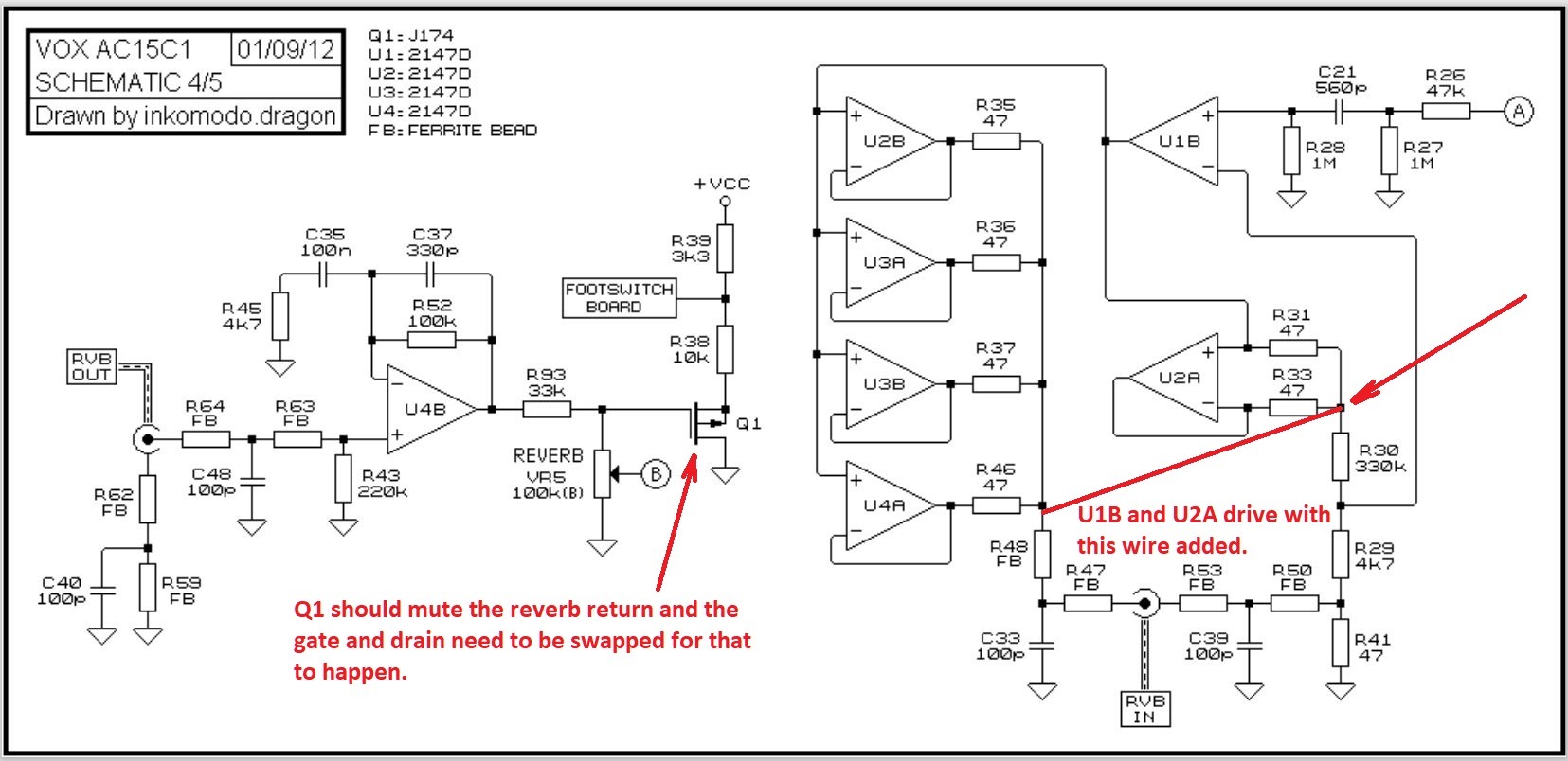

The Vox AC15C1 is their reasonably priced ($800) current production 15W circuit board based version and I
finally found a schematic for it here: I'll also try to attach the .pdf in case that source is lost.
https://www.tdpri.com/attachments/ac15c1-schematics-rev-2-pdf.291408/
Posted in this thread: https://www.tdpri.com/threads/vox-ac15c1-no-sound.570181/
There's at least one error in the reverb driver, perhaps more but overall a good job, by inkomodo.dragon
not sure who this is or if they are on here or not.
I've looked at the vintage 60s AC15 and thought that the Tremolo is way too complicated and it
would be a major cost savings to make it solid state which they've done in this design.
The Reverb driver and recovery is done with OP amps for another cost savings.
There's one OP amp in the main signal path that it looks like there's no need for, or it could at least
be moved so that it is in the Reverb path only.

@artofharmony Sorry I don't come on here often.
You need to look at the full schematic, in the .pdf and for the FET MF1.
First notice that the circuit connection C goes to the grid bias of the output tubes indicating
that this is the bias shift type of tremolo. The output stage is cathode biased but it is still
possible to shift the bias by altering the bias voltage on the grids.
MF1 the LND150 is a phase shift oscillator with the phase shift provided by the Rs and Cs in
front of the gate. B+2 has and RC filter and then a 100K to the drain of the FET, just as with
a 12AX7. The output is AC coupled (C47) to the depth pot.
Q2 shorts the DC bias voltage across R69 in order to stop the oscillation.

Revisiting this and looking at the reverb driver they are obviously using multiple small OP amps
to try to serve as a power amp and these are a high voltage type for +/-30V that are no longer
available. So, why not just use a single power amp chip such as the LM1875 which is in a TO220
package and also has a +/-30V rating. This came up quickly with a search, I'm not up on these
and not sure if there's a better one.

Why not? What, you're going to hear distortion more so from 4 ganged op-amps to one chip amp to yet another device, after going through the springs? It's a good idea!So, why not just use a single power amp chip such as the LM1875 which is in a TO220
Nah. That would be too easy.Why not? What, you're going to hear distortion more so from 4 ganged op-amps to one chip amp to yet another device, after going through the springs? It's a good idea!
