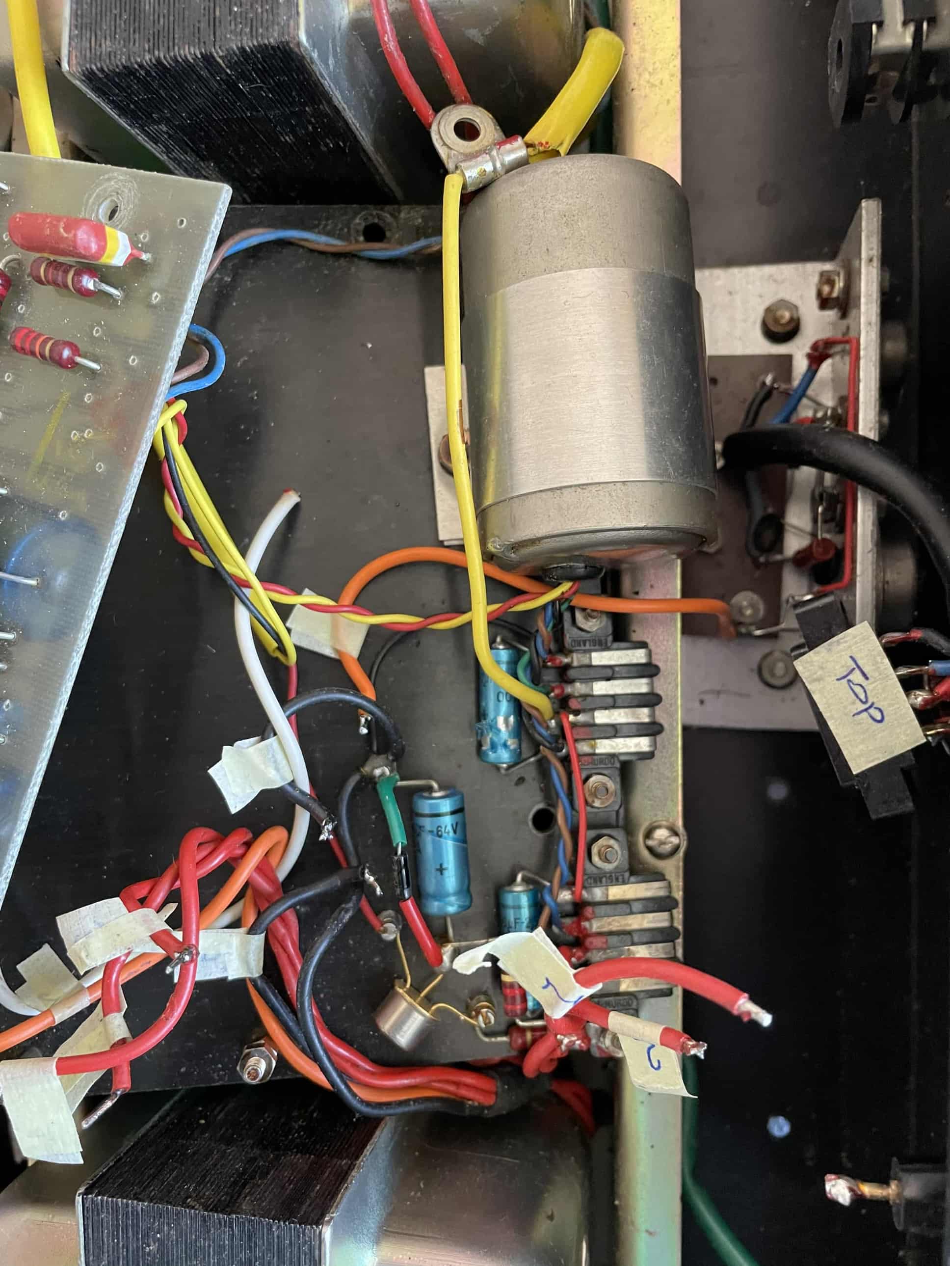

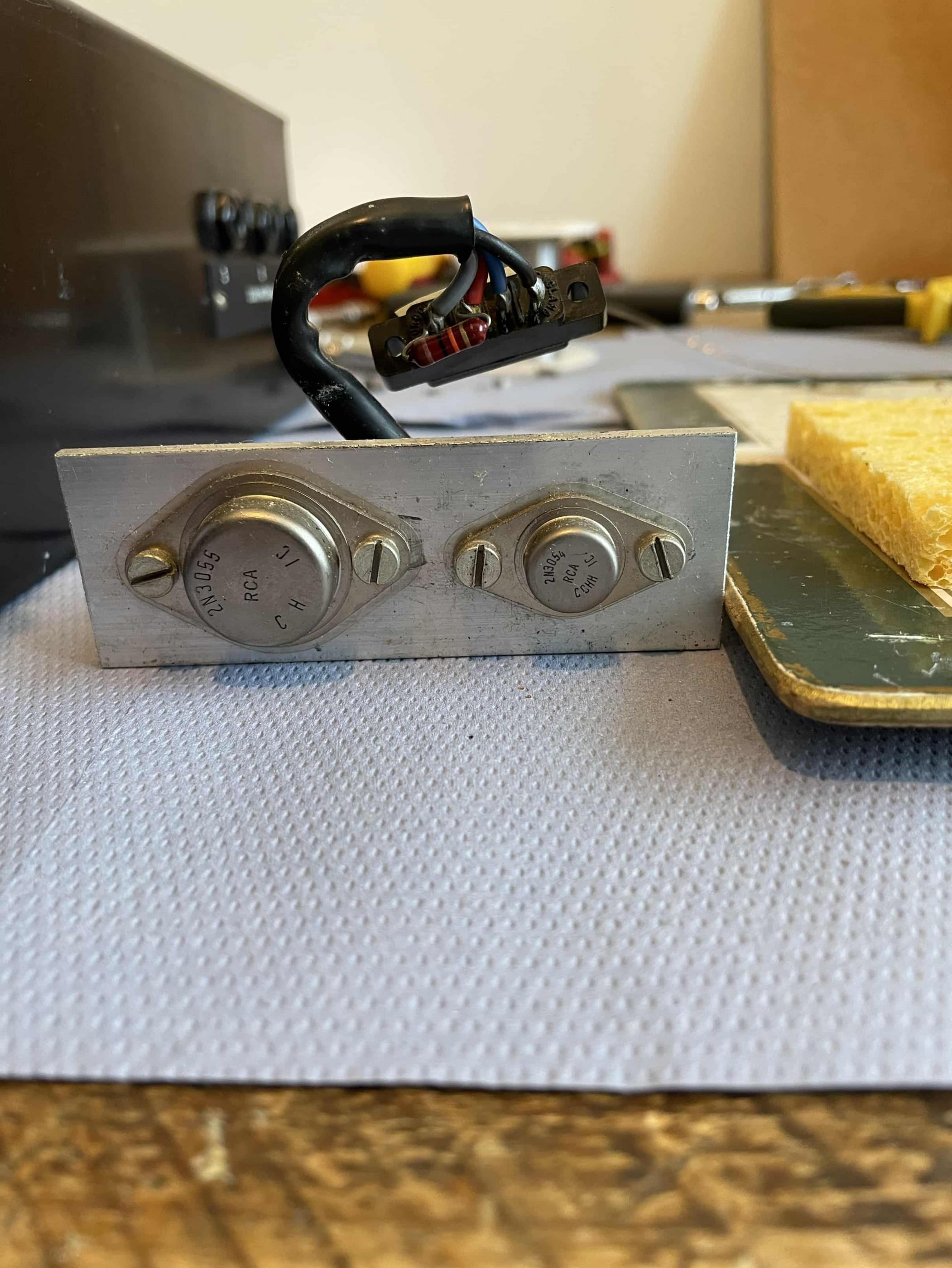

Well pulled apart interesting set up differs from schematic. The only transistors are BC114 K30 2N3055 & 2N3054 paired on two separate heatsinks. Connection wise nicely done just plug.

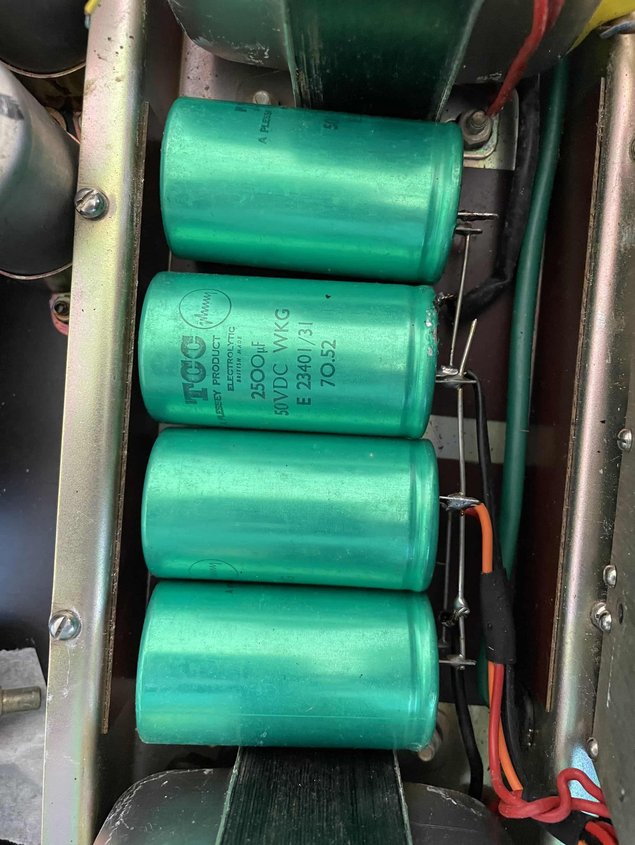

PSU 4 2500uf 50v was gonna try and reform them but since there so old leakage probably be too high it’s been in storage since 1983.

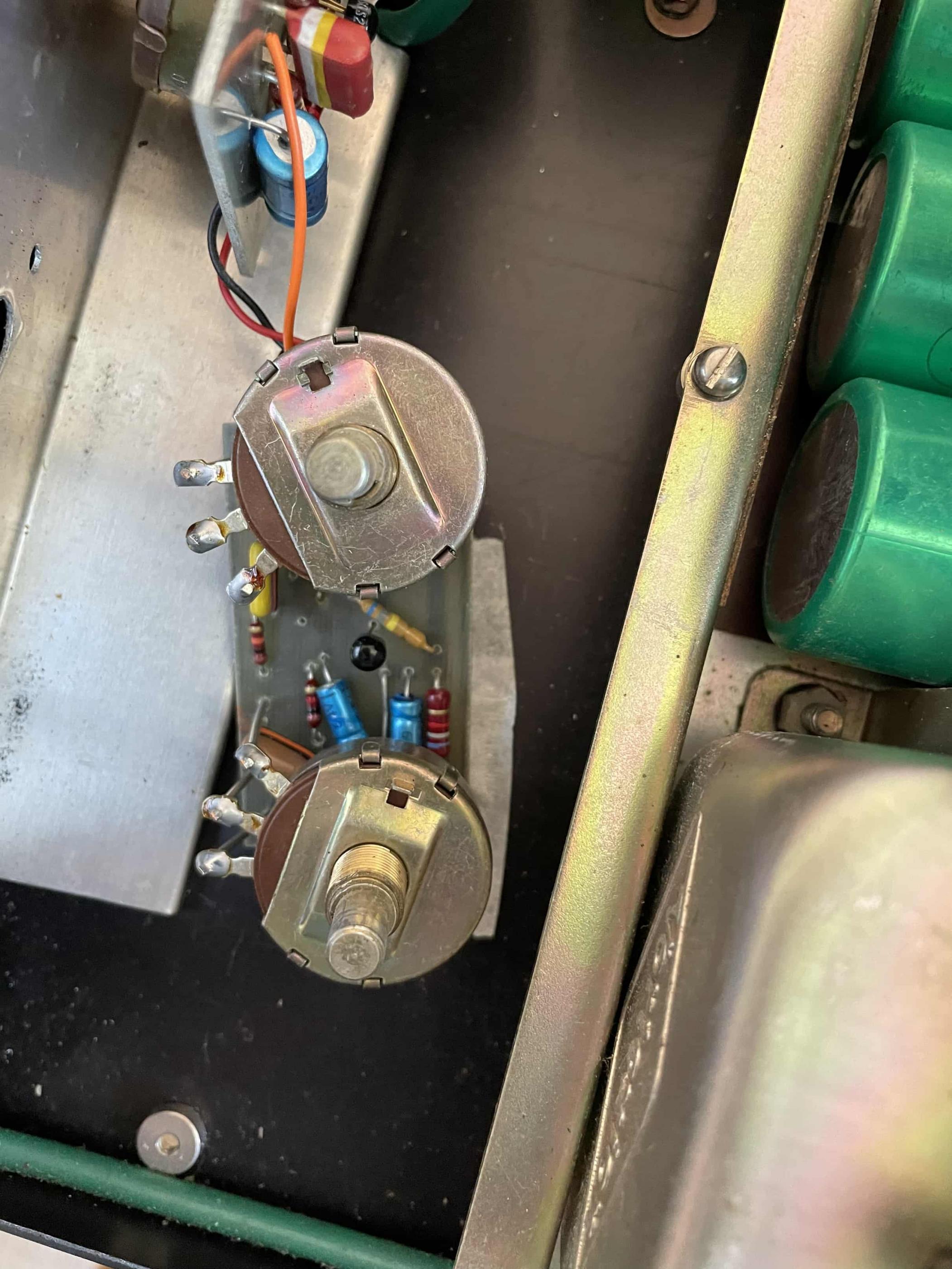

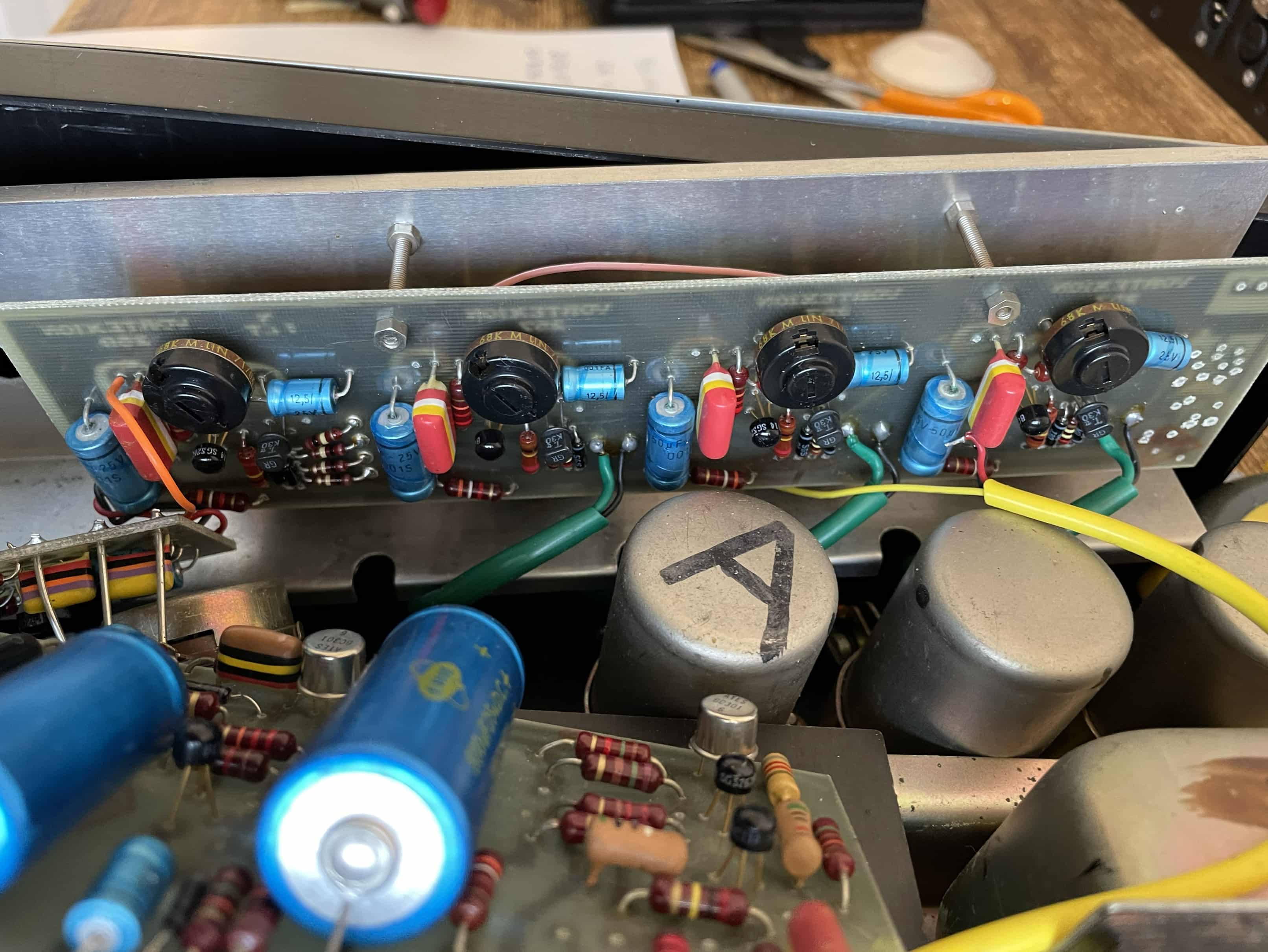

Anyhow I think 3 cans front end are mic transformers and the one on the psu board possibly a step down transformer possibly!
Anyhow some pics to follow see what you think.

The 2N3055s found in this one may be later repairs or may be Vortexion selected to the 40646 specs. We did a lot of that cheating back in the day.
They look like they’ve been in there from day one. None of bolts or red paint removed off solder joints. Odd no grease just mica spacers? Think bc109 and bc 107 have been replaced with bc114. Couple of holes in psu board looks like components may have been in there only around 4 holes all other holes clean. The rest is all original from what I can see.
Psu caps replacing them with 3300uf caps bit higher but not really gonna make any difference sonically originals 2500uf. Not that we would hear. Then I’ll pull the others out and replace plus those tropical so called fish caps shame not swam off. Find outer casing goes dry and brittle on them. The rest seems fine I’ll check resistors see if any have drifted.

Anyone know why no heatsink compound used just mica washers? Not seen that before.

Definitely some was usd in the 70´s BUT:Anyone know why no heatsink compound used just mica washers? Not seen that before.
we are used to mineral loaded (typically zinc oxide) transfer paste but there is also a transparent non mineral version, Dow Corning makes a few, here we call them "silicone vaseline"
It works well, but maybe in 40 years plus quite a few heat cycles it may melt and slip away.
Personally I´d remove power transistors, wipe them clean, and remount with fresh mica and grease.

So there are two more blue and brown wires from op going to psu board so you could put some veto pins in there and tap from there. Terminate the two 100v wires and connect from psu board. So I’m bypassing them. Just a thought as there gonna be redundant. Not connected to a load. Think in one of pics you will see the brown and blue wires going to main board about 24awg. See attached pic.
Well that’s interesting those two leads are giving me 3.5ohms.
Those Philips caps all gone way out. Difficult to read small ones can’t make my mind up if there 6.4v or 64v. There on tone board so can’t see them being high voltages. But higher is not gonna do any harm. If I put 6.4 and there 64 then asking for trouble. Those tropicals are actually in pretty good condition so gonna leave them in for now. If drifted soon find out when fired up.
