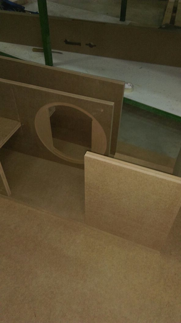

CNC cut parts fit neatly. Tomorrow the box will be ready. Hopefully, Monday I will have the hypex amp and by next week the woofer!

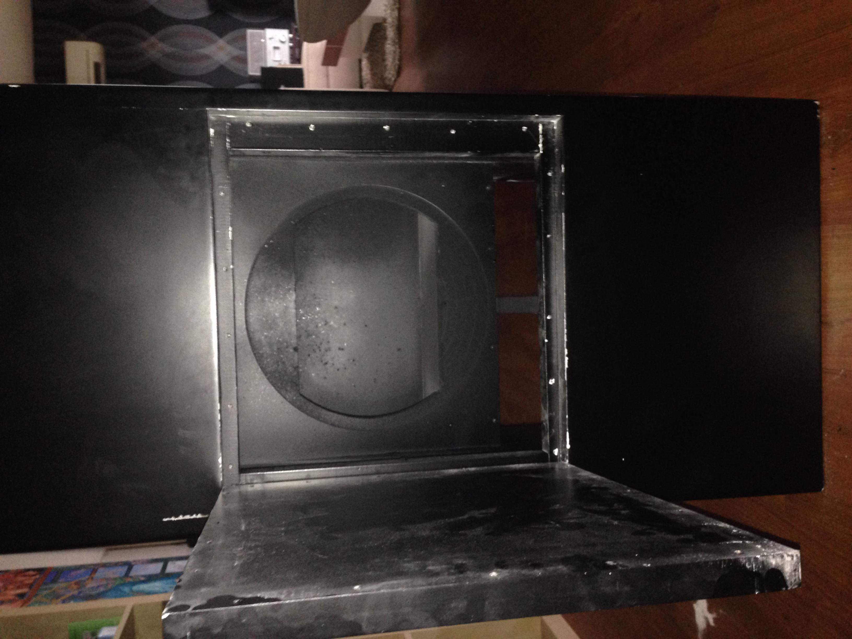

Will it hum for sure if I install the plate amp over the access door? It doesn't obstruct anything inside size wise. I will close the back of it as well. Any experiences?

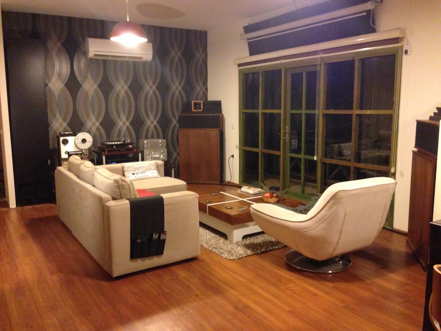

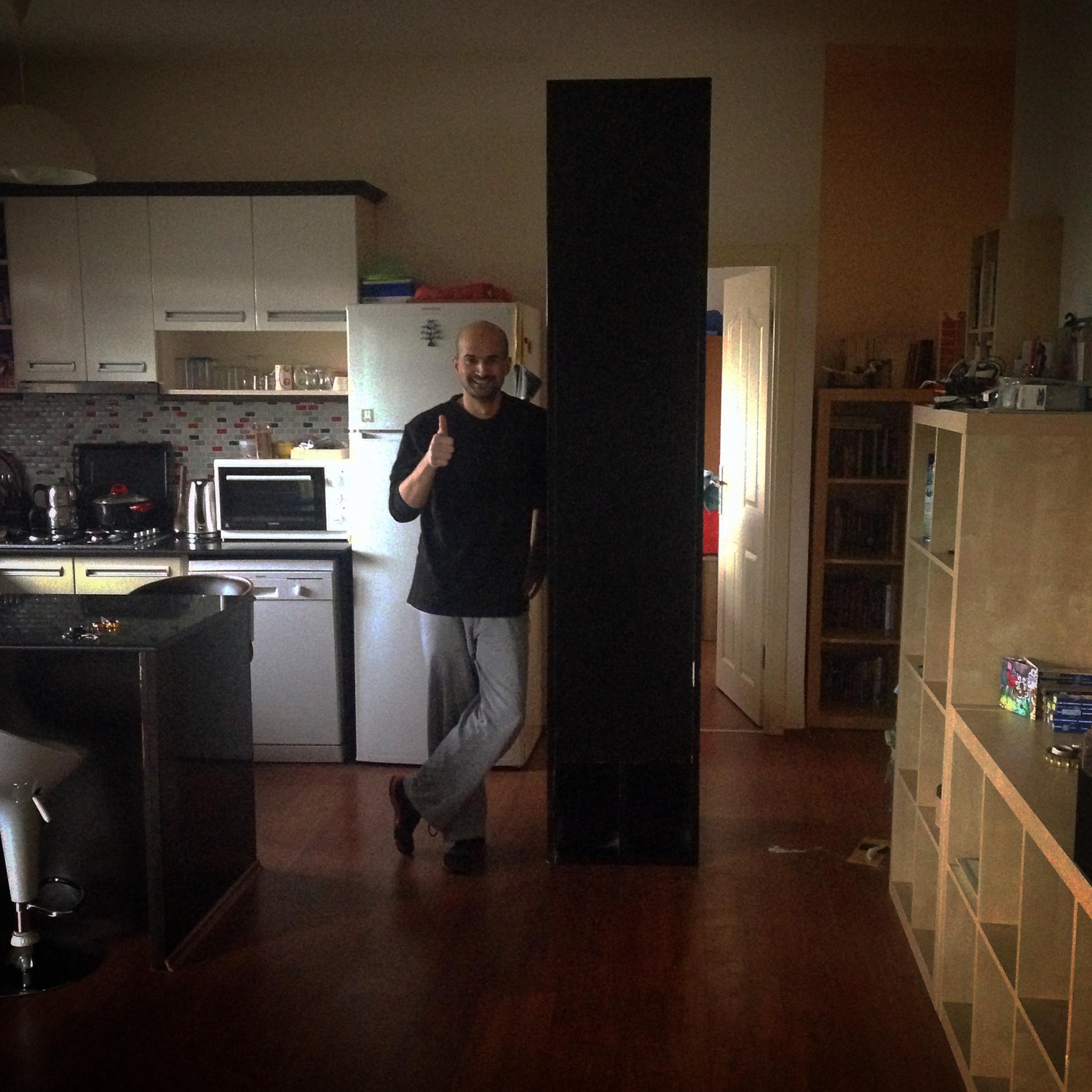

an here is the finished eminence horn box. Both out to see how big it is and in its place where it fits and disappears 😛 I can't wait for the driver to arrive so I can test it. I have been very patient though and worked my way slowly. There is absolutely no leak in the horn, I made the lighting test. It is close to 100kg's! so I believe it is inert as well 🙂

I don't think it would be an audible effect. 22mm mdf access door, plus another 22mm frame piece for the access door to bolt on creates a 44mm depth there. Hypex is 60mm's deep. Just an extra 1.6cm. Hypex amp is compact. I will seal the back of it as well. This may add another cm. It wont hurt the sound.
If I keep the amp outside, there has to be the speaker connection cables coming out of mouth or I have to make a hole, or put connectors, which are things I don't want to do.
My question is will it hum if it is bolted on the access door?
