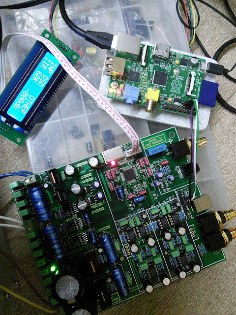

I bought a 4 layers ES9018 board by Weiliang hoping to connect my Raspberry pi/Vlolumio via I2S. The board works fine with the Opt and Coax input. But using the USB input (I2S input) the board detects as DSD signals (the display says so) and makes noise only on the right ch when it plays 44.1k/16bit files.
Is there anyway I can fix this problem?

Here is some information that may help.
http://www.diyaudio.com/forums/pc-based/271811-moode-audio-player-raspberry-pi-71.html
Start at post #705. A potential fix is in post #710 (see below)
/etc/modules
snd_soc_bcm2708
snd_soc_bcm2708_i2s
bcm2708_dmaengine
snd-soc-pcm1794a
snd_soc_rpi_dac
