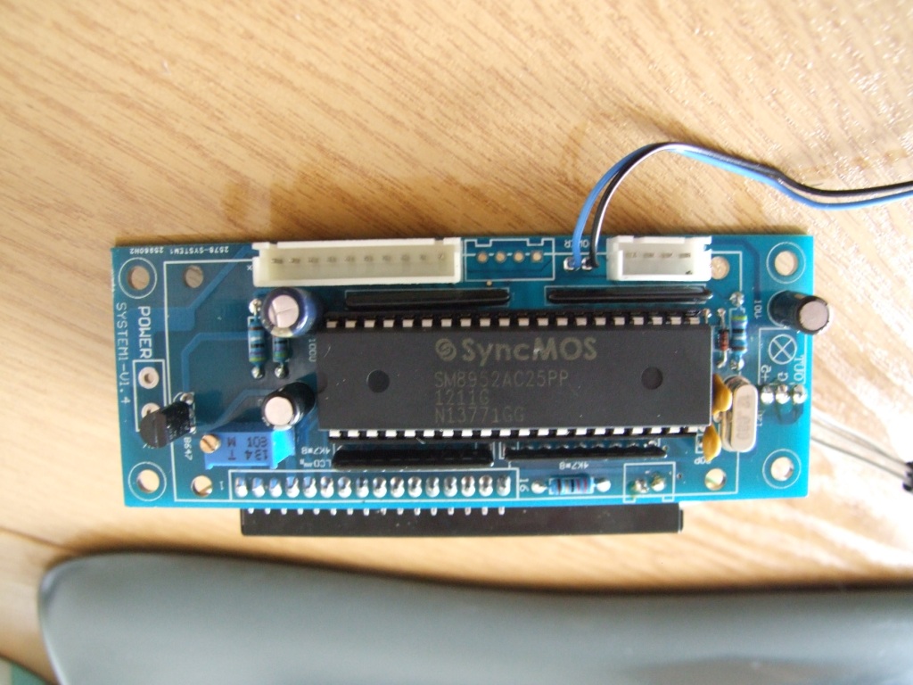

No mine is as per your diagram. Supplied by the same Chinese supplier. I just assumed it was a PIC.

Yep, Mine looks exactly the same, just the markings on the micro are different.
Question was, How do you reprogram the new micro ?
If I need to buy a PIC (or whatever) programming board and the software to go with it, it ain't worth it. Dusty Bin can have a feast.

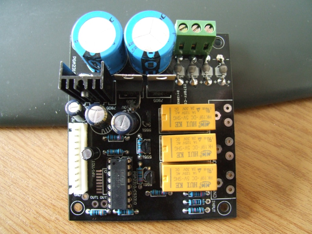

I've had to send the kit back to China for the time being. The PCB that I bought had the rectifier diode silk screen orientation round trhe wrong way which caused a bit of damage. The vendor wants to see the boards.

What crystal is on your PCB ? Mine has a 12MHz crystal.

crystal is same but I see 1 Cap to lcd backlight the yellow one left site
and connectors top right is not same
but that dont mean its not same chip pin layout as mine
about the rectifier diode maybe the PGA2311 is dead from this error wrong power in +-5V
I think the regs protected the PGA2311. They did not output anything with reverse polarity input.
I was amazed, the two regs smoked like a burning building but were both still OK after testing. I only applied the reverse power for less that a second.
Anyway, hopefully Chinese vendor will sort that out as that was his mistake. You will notice that the four rectifiers are noe apparently the wrong way round (this is how they should be)
