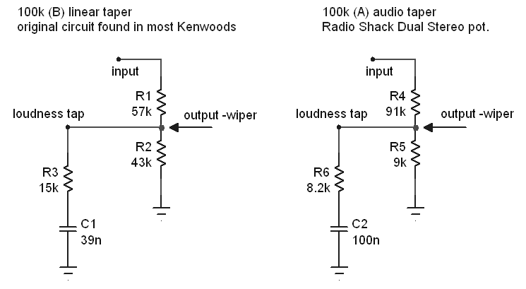

Hi gchrist,
Here's some schems of whats used in most Kenwood Amps and a good compromise using the Radio Shack part or an audio taper pot. As you can see there is a BIG difference between the two.
Using the RS pot there will be a difference in level with respect to the volume control posistion and the amount of loudness "boost". Experiment with the value of C2 in regards to the amount of boost and frequency where the action begins (turnover freq.).
I never did like Kenwoods or most other brands choice of turnover frequency (272Hz), I usually changed C1 to 68nf and R3 to 12k (195 Hz). Usining the values in the schem for the RS pot will give you a turnover of 194Hz and is a good compromise in level with respect to control position, you'll find using the RS pot you'll have to turn the control up higher to get the same volume. Also the bass boost will be somewhat less.

Wayne correct me if I am wrong:
The Radio shack pot has a loudness pot. The only problem is that it is not linear. To fix this problem I will have to install R6 and C2 from the right schematic you posted above without changing anything else?
If I use a linear pot, other than the RD pot, without a loudness tap then what do I do? Do I get a loudness feed from the central wiper installing R6 and C2 also?
On the above schematics the resistors R1,R2,R4,R5 are included in the pot. They are not resistors connected externaly on the pot. Correct? The only thing missing from the pots are R3-C1 and R6-C2.
You don't *install* R6 and C2. They are already there in your receiver. Wayne was simply suggesting that you change the values of these parts so they might work a bit better with an audio taper pot, and to get a lower turnover frequency.
If you don't use a pot with a loudness tap you lose the loudness function, period.
On the above schematics the resistors R1,R2,R4,R5 are included in the pot. They are not resistors connected externaly on the pot. Correct? The only thing missing from the pots are R3-C1 and R6-C2.[
R1,R2,R4,R5 depicts the resistive element inside the pot. The reason why there are two resistors is to show at which point the pot's "tap" is attached. R3 and C1 is what's already in your receiver, probably with the shown values. R6 and C2 is what Wayne is suggesting you change those to. Also, remember there are a set of these per channel.
Hope that clears this up.
-Ti
I also should probably mention that the "43%" referrers to the percent of rotation from fully counter-clockwise rather than the percentage of value. amb is correct in his analysis, I should have explained it more clearly.
