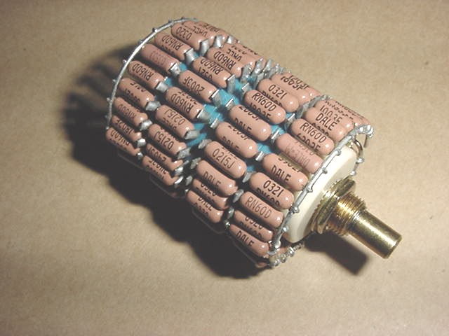

I have used a few different stepped attenuators from Ebay including:
SMD type
and also the vishay/dale ladder type:
vishay dale ladder type
The SMD one is a series attenuator; the vishay dale is ladder type. In all honesty I think I prefer the SMD although both are excellent and I'm not confident I could tell the difference in a blind test.
I don't see why anyone would buy a potentiometer when stepped attenuators can be had for so little money. I absolutely agree that the balance at low volume levels is a serious advantage, aside from the increased transparency.

These PEC controls look like copies of the Allen Bradley and Clarastat 2 watt controls that I've been using for years. But some time ago I bought this Vishay stepped attenuator from a fee-bay seller in Hong Kong. I just haven't had the ambition to try it in something yet.
Victor

Yes, many people feel this way. Especially if you're using continuously variably controls that may not be closely matched. However with stepped controls, it's the value of the individual resistors that provide the tracking accuracy. Assuming they are correct, having them on a common shaft gives you the convenience of having only one knob to turn.
This assumes that both channels otherwise have equal gain. If there is something else that is upsetting the gain balance, then fixing that, or using seperate controls is necessary.
