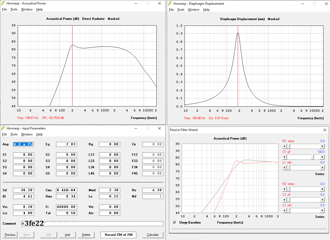

fwiw here's what I get with hornresp

It depends. The Qt is more like .43 btw. This driver's fr slopes upwards. If the enclosure is too small, it will sound thin. You want to have some high Q bump on the low end so a smallish enclosure will sound more balanced.

If you can EQ its not critical with the volume. Make it as big you can fit on your head 🙂 but I would think > 0,5L and you must start here to consider the actual volume of the driver itself as it will take a big portion of any box or tube...

Make the enclosure small. You will have less bass extension but the speaker will sound fuller nonetheless. This is true for closed boxes.
