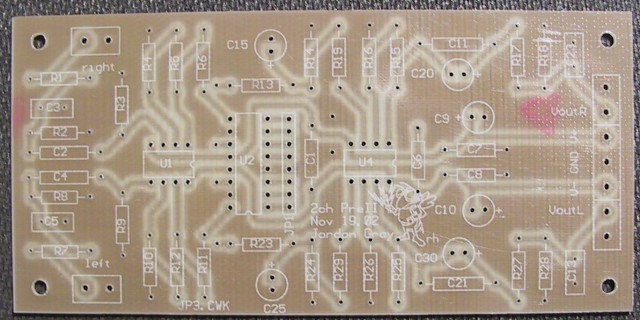

speaking of the volume control, my roommate who is helping me with it got back the analog volume control boards. They are pretty cool. He made them so that you can stack them on top of each other and then you only have to connect the digital connection to the top board. It is a pretty cool design. It makes it highly scalable. The boards are now populated, and I will get some pics soon. He made one mistake... mapped the +/- 15v to the opamps backwards, so he fried the opa2134 chips, and the pga2310 chip, so he had to reroute these two, and start with new chips. It appears to be working now.
Here is a pic of the unpopulated board. It is quite simple, and is based off the schematics on Mark Hennessy's website. Thanks Mark for the inspiration. I should have a finished prototype soon. The digital side is pretty much done. We haven't done the power supply yet, and are just using a bench supply for the analog stage now.

Hi Brian,
I'm impressed with your board layout, and very pleased that my site was helpful to you 😉
You've been able to optimise the layout by freeing yourself from the mechanical constraints that I imposed on myself. I wanted to minimise the interconnections by using things like ribbon cable and PCB-mount phono sockets...
Your layout has lots of copper dedicated to earth, which is an excellent plan. One suggestion, though. I notice that there isn't a power supply decoupling capacitor at the input-end of the PCB. It might be worth trying to solder a couple on the back of the board during listening tests. It might not make any difference, but the PGA2310 datasheets made quite specific recommendations about it.
I notice that you've included gain on the input buffer. I added a very small amount of gain there to compensate for the losses in the input filter - this was only for the benefit of the fixed-level listen-source output that I provided, indeed I didn't bother for the surround-channels. So, you'd be able to simplify that end of the board if you wanted...
Out of interest, what do C15 and C25 do? I ask because they appear to be electrolytics! I guess that they are the 1nF caps that I used to set the -3dB point to 100kHz...
Very impressive work! I can't wait to see the assembled version... Which CAD package does your roommate use?

This is my roommate second pcb layout that he has made. He messed up on the first try with this board. I showed him how to use the ground plane in Protel, so that is what he is using. He is using Protel DXP now. I will ask him about the purpose of those caps.

Well, here is the picture of the assembled board. Notice the reversal of the +/- vcc for the opamps...
Mark,
The caps you were referring to are not electrolytics, he just set the footprint wrong. He will fix it in the next revision. The circuit is straight from your schematics on your website.

I should have shown the bottom, there is a single row of pins sticking out that allow you to stack the board into another. It should work well for a scalable pre-amp.

Hi Brian,
Still impressed with your PCB! Question: what are the resistors you've used? They look expensive 😉
And, how do you think it sounds?
Something else to try - C15 and C25 (the 1nF caps). I notice you've used ceramic caps here - it might be worth trying something better. Let us know if you hear a difference. I used a plastic cap (can't remember the type).
You could also try losing the small ceramics on the input and output. I put them there to protect against ultrasonic noise, but I'd be interested to know if you hear a difference without them (or if they sound better for being non-ceramic)
Unfortunately, I haven't got the time to try these tweaks for myself at the moment🙁 Maybe during the Christmas holidays...
I like the stacking idea. Just one question - how are you going to cascade the shift registers in the PGA2310's? If you look at my diagrams, you'll see that I took the data-out from the first PGA2310 and connected it to data-in of the next. This means that I have to send a 6-byte word when changing volume, but it means that I can address them individually. It appears that you are planning to simply parallel-connect them all, and this might work ok (just watch data-out pins), but you have to send the same data to all of them at once. Obviously this is only an issue if you scale up for 6-channel, as you might want to control them individually...

It looks like you have used a copper pour for the ground plane. There are advantages and disadvantages to this. From a purely simple noise standpoint, an all-over ground plane is great. However, for the absolute best in analog performance, a poured ground plane is actually not the best way to go. By using a poured ground plane, you have lost all control over where your ground currents are flowing. Even though it is a lot of copper, when you are talking 96db of dynamic range or more, a small difference in ground potential from one side of the board to the other can make a huge difference. Star-Grounds, often applied when wiring, are just as applicable in PCB design.
