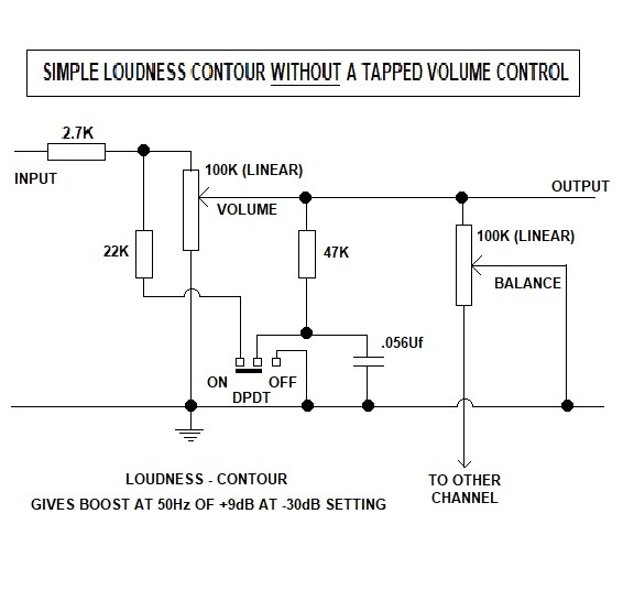

Hi! Anyone have schematic for passive volume control with loudness compensation and 250-500K potentiometer without taps? Tapped pots are very problematic to obtain today unless ordered in quantity 100+ directly from factory.
I found schematic on Steve Bench web site (attached to this post), but I have no idea of its origin. In the books I have there are schematics, but ALL use tapped potentiometers.
Thanks in advance for any suggestion(s).

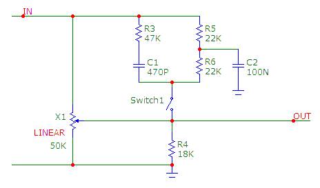

I have this one, slightly simpler - I also cannot tell you its origin: (when I saw the useful circuit I just saved it with no record of where it came from)
It should be easy enough - using simulation software - to plot the frequency response curves of both circuits and see which you prefer.
The tapped pot circuits are merely a cheap approximation anyway, so no reason they are inherently better than an arrangement using a standard pot, other than they may give a lower insertion loss.
There are also circuits that use double-gang pots, so for stereo you'd need a four-gang, or two gear-coupled twin-gangs.

You can place a parallel RC in series with the cold end of the pot to ground, place a switch across it if you want to be able to defeat it.
Some iteration is required (With 100K pot I might start with 4.7K - 10K and 0.1uF or greater and iterate from there to the optimal values - best done in spice) and this approach works best over a very limited range of the listening levels, and as you would expect boost becomes significantly less as you turn the volume up.

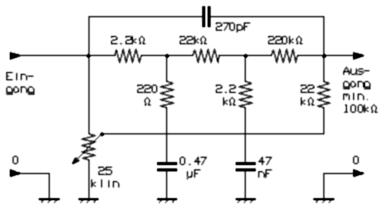

similar approaches are realized here:
http://www.dl4cs.de/audio/preamps/loudness/index.htm
Unfortunately this isn't a level independent approach - exact like those versions with tapped potentiometers.
This is a great disadvantage for the use of loudness filter - mostly the equalizing effect is clearly too strong due too much output levels of several line-level sources like a lot of cd players.
Therefore I like the variable and level independent loudness potentiometers like in use on Yamaha's AX-570.
