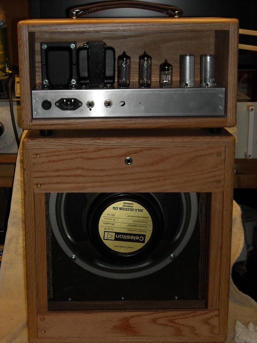

The speaker is a 1976 Celestion G12M. I think the efficiency should be about the same as the Heritage Greenback which is 96dB/W-M.
Recording is done with the recorder 1M from the speaker. The tone is 1KHz at 6mV when measured on a 8 ohm load.

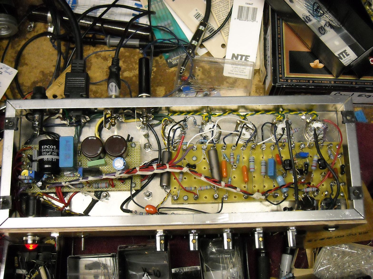

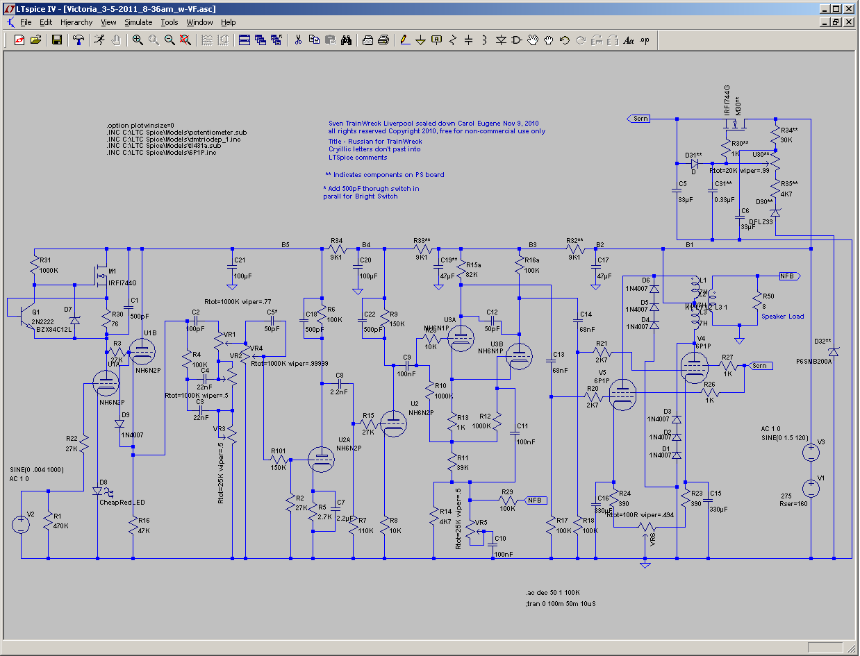

Yes a guitar amp in the style of a High Gain Lead/overdrive amp, modeled after the TrainWreck Liverpool with the changes of;
(1) replacing all 12AX7 stages with 6N2P-EV stages
(2) reduce the output from 4 6BQ5/EL84s Parallel push pull to two 6P1P (6AQ5 equivalents ?) push pull, including output transformer change
(3) convert an un-used triode to cathode follower between first gain stage and tone stack
(4) several tweaks that reduced the gain slightly in an attempt to reduce hiss

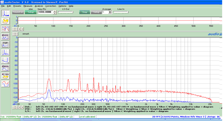

I put the amp on the bench and hooked it up to AudioTester and ran a frequency sweep tonight. No wonder it had so much hiss. With over 20KHz bandwidth and that kind of gain it is bound to have hiss.

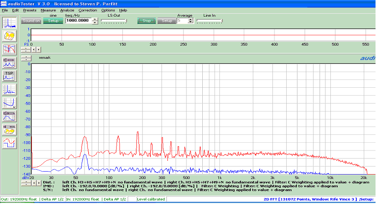

I found I had placed two cap values wrong. One effected the low frequency roll off which was not the issue. The second one effected the hf roll off. Changing it made a world of difference. The amp does not have quite as much gain but is so much better sounding.
The first plot shows the original frequency response compared to the corrected response.

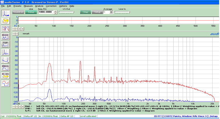

The second plot shows all controls at noon, Min base w/ Max treble, and max base w/ min treble.
Driving a "1976 Greenback" with the volume at max I have to put my ear to the speaker to hear the hiss.
