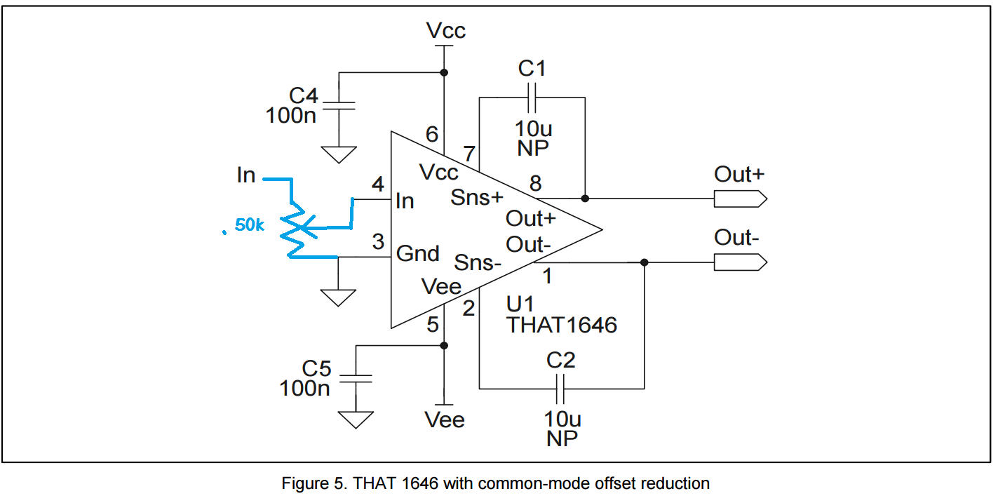

I've built the Modulus86 amplifier (my first amplifier build), and am happy with the sound. Now I'd like to add a volume control to it. Unfortunately my knowledge of electronics is limited, so I'm looking for some guidance.
Tom has suggested a simple option, a volume pot with a THAT1646/THAT1606 output driver, which I'm exploring. I've attached a schematic configuration based on what I can understand from the data sheet. I'd appreciate any advice on this.
Even though there are only two types of caps in the circuit, I'm not sure what types to use. The data sheet suggests that "C1 and C2 are typically high quality non-polarized electrolytic capacitors".

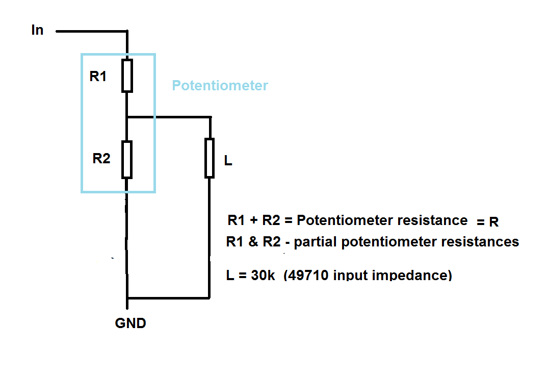

I'm going to attempt a formulation of the problem.
We have the THAT1200 driving the 49710. The THAT1200's minimum recommended load is 2k. By adding a pot before the 49710, we will potentially reduce the load. The key to good performance should be to figure out a way to do it without drastically lowering the effective load resistance seen by the THAT1200 over the range of potentiometer settings. From the analysis in this post. We could model it as shown in the diagram.
One could write out the equations and minimize etc, but for a back of the envelope calculation, I'll use the approximation that for this configuration,
max load = max (R, L) (an overestimate) and min load= min (R, L)/2 (an underestimate), for worst case scenarios.
Then, for example, a 5K pot presents a minimum load of 2.5k and a max load of 30k, a 10k pot presents 5k to 30k, etc.
Would my inclination to choosing a 30k pot for a range of 15k-30k load be the right intuition?

IMO, THAT1200 will be happy with or without a pot, it can drive a 5k pot no problem. I wouldn't worry about stressing it. And BTW, if the ohms goes up the load is easier, not harder to drive. A lower resistance value draws more current, which is called a "bigger" or harder load, even though the ohms value is numerically lower. 50 ohm source impedance will have no problem driving a 5k resistor in the pot.
The problem is whether the signal after the volume control will have source resistance too high to drive the 49710. I will ask my engineer friend when I see him this weekend, or maybe someone can chime in. I think it's OK, but better to know for sure before buying an expensive volume control.

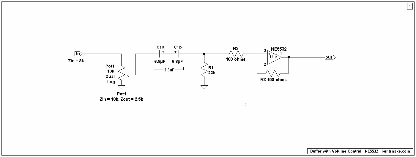

So I have to chime in with those suggesting an NE5532 buffer. In buffer configuration the NE5532 has negligible distortion, a Zout close to zero, and a Zin in the megohm range, you can hang anything you want on the front end.
The NE5532 does have significant bias current, but the shown amplifier circuit has a DC servo, which should deal with this. In any case DC errors can be kept small by keeping resistor values low.
I'm posting a suggestion below. If your audio source is a CD player or similar you don't need a Zin of anywhere near 50k, the shown 8k will do the job. Capacitors C1a and C1b form a non-polarized input capacitor of about 3.3uF. This back to back arrangement is used because various gurus have tested it as superior to a single capacitor--although the superiority might not be audible, as the improvement is small.

Good first start, actually. This is exactly what I had in mind. I missed the 5 kΩ input impedance of the THAT1646. Sorry about that. So you'll need a buffer between the volume pot and the THAT.
For the two bypass caps (100 nF), I'd use a ceramic cap with X7R dielectric. The two bipolar caps can be Nichicon ES-series (available at Mouser).
See attached. PS: Just noticed I copied the schematic without the common-mode reduction caps. You'll want the 10 uF caps from OUT to SNS.

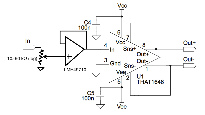

If you're gonna use a buffer opamp plus THAT1646, the you might as well just use two opamps to make a balanced output
Thit is indeed a possibility, however, the common "differential" drivers usually either require precision resistors or adjustment to ensure that the output signal is indeed differential, rather than differential + common-mode.
Since you don't need any gain, a much simpler option is to just put a volume pot in the single ended signal running between the THAT1200 balanced input stage and the 49710 opamp of the Modulus. Modulus is a single ended amplifier, even though THAT1200 is a balanced input receiver, it puts out a single ended signal to the Modulus composite amplifier (49710 and 3886.) You don't want to mess with the composite amplifier, but putting VC before that is fine.
True. Between the THAT1200 and the LME49710 in the MOD86 is a good spot for a volume control. Getting the volume control into the circuit without degrading the performance can be a bit tricky, though. If you don't want to cut traces on the board, the best option is probably to lift pin 6 of the THAT1200 and solder the wires for the volume control to pin 6 and the pad for pin 6.
...LME49710 which is 30kOhm input impedance, ...
That's the differential input impedance of the LME49710, actually. In a buffer configuration, or other single ended application, you're looking at the common-mode input impedance of 1 GΩ. The feedback ends up bootstrapping the differential input impedance.

However, I do have one question - since the source will have a low-impedance output, isn't it ill-advised to connect the potentiometer directly to GND, since, then, at one extreme of the potentiometer adjustment, you are connecting the output of the source directly to ground?
The source connects to one end of the resistive track of the pot. Ground connects to the other end of the tap. The load impedance imposed on the source is just the resistance of the pot.
No sir. That was a guess at 2/3rds of max for any size op-amp, because none of them work well at maximum.
Most modern audio op-amps, including the LME49710, can go within 1 V of the rails before you see any degradation of the THD.
I am jealous of the efficiency of your speakers. However, the rest of use might not have matching conditions.
85-87 dB/W*m makes you envious? It doesn't take much, I guess...
My listening position is 180-200 cm from the speakers. The SPL when I really crank it is 90 dB. To reach this SPL with 87 dB/W*m efficient speakers requires 3.24 W per speaker, not including room gain. With 8 Ω speakers, this requires 5 V RMS to the speaker. With 20 dB gain, 0.5 V RMS to the amp would be required.
I suggest to delete that mod. Your artwork is technically correct, brilliant, highly valuable, and doesn't need diluted.
However, there may be some external accessories involved, not too dissimilar to how to tow a camper with a sports car.
That's a separate matter and therefore quite good on a separate board.
Once I have a differential driver board available, I'll change the doc to read, "should you need higher gain use this board".
After that step for compatibility purposes, it would be great to have an available upgrade to a Neurochrome DAC with a significantly high amplitude output--enough to actively prevent the need of a preamp.![]()
