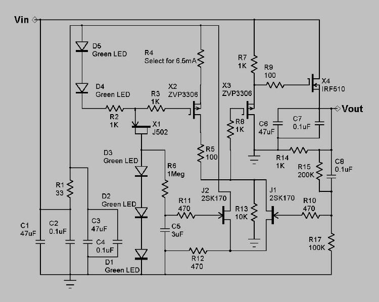

I agree that discrete regulators are better. Twenty, thirty years ago, we were building Japanese designs with current sources etc. which sounded much better. The problem now is that these and other designs are TOO big for stuffing into existing digital systems which may need 9-12 regulators. The only design I know off is the Audiocom regulator which can be plugged into a 78x or 79x designed board but they want £40 for one which to me is too much. Hence my post.
Regulator King!
Jean-Paul,
This one.
Jam
So, does anybody have a printed wiring board for either of those discrete regulators?

Go here and you will find the Sulzer regulator:
http://hitechnetworks.net/bwaldron/audioelectronics/sb1_regulator.htm
That sophisticated regulator is also very good, still measured quite well on Walt Jung's test and it's easier to build, because it uses a one-sided board.
W.Jung did a revision on his superregulator, which was published in in Audio Electronics, to solve some problems the first design had. Do find out if the pcb Audioxpress sells now is modified for those revision changes. If it is go for it, if it's not you would have to do further wirings and modifications to do those changes. Certainly not worth the money you paid.

Warning: none of these regulators (or any discrete one) is "small enough". Certainly not to replace a chip regulator. But they are worth finding the space to put them in.
Carlos

For a simple discrete design, try the POOGE reg - a few transistors and better than 3-terminal performance. Search here, you'll find the schematics (just noticed JAM posted it already!).
