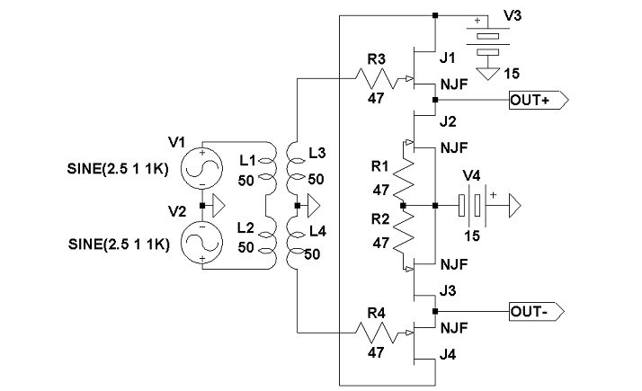

VoltageDAC with B1 output buffer
A better way of using a transformer(if this an option) and also get rid of coupling-caps is to place it between DAC and B1. As a good transformer like LL1690 has a Zout, in the ballpark, of 1k it is not the best to drive long cables. Let the B1 take care of the low Zout instead. Any additional filters can be placed differentially before or after the transformer. There may be need for additional loading on the transformer but that must be done by measuring and listening.
ERROR in the schematic V2 should be opposite phased.

OK, I could not resist the temptation.
Firstly I wonder what is new in this. My Sony XB940 has such a JFET Follower (a la Curl) output stage for 4 years.
As to the circuit proposed in #12. If I were to use split rails anyway, I would put the HP (i.e. decoupling cap) on the high impedance part, which means input. That saves you money on caps.
I would not use separate cap multipliers on the left & right side. Reason is simple. In a balanced circuit, the AC current draws are out of phase and compensates each other, so that the (common) power supply sees constant impedance. Using separate supplies makes it worse.
If you are really daring, you can float the entire DAC, use single rail, and BJTs for the lower current source (where 2.5V Vce is OK), and just run the outputs at 2.5V DC, which you may (or may not) ground to the rest of the equipment. This means that the DAC Ground is now effectively at about -2.5V relative to the system ground, but floating. Advantage ? No caps.
Matter of opinion of course. Mr. Choky would no doubt have a different one.

Thanks a lot for all your input.
The hole point of running a buffer without gain is that this dac-chip already have enough voltage output(at least in my setup). At the moment I will stick with this thinking. But who knows what the future brings.
I have reread the B1 article, and will also try the Vishay caps Nelson uses.

This configuration, AKM voltage out DAC >>>>> Lundahl 1674 transformer, was designed for me and recommended by Kevin from KK audio. 1674 transformer is 1+1 4+4 type and is wired as 1+1 2+2. Original configuration 1+1 4+4 is not recommended to be used in this circuit. So far is working great and I am still to hear anything that will match that when it comes to transparency. The project that Zen Mode and I are working on is to solve several issues mostly related to different gains that I need in my three way system and to see if we could improve on output circuit I have with DACs and Lundahls. I did some measurement long time ago and this passive circuit presented clear advantage vs. active with opamps. I am very interested in seeing what it will do with jFets, vs. passive.
This issue of inductance and impedance with DACs and transformers is very convoluted, and any exploration here would be greatly beneficial. For people that never heard this simple set up - in my case AK4396 >>>> Lundahl1674 >>> balanced out, I would suggest, please try it, it is quite amazing.
Hey AR2,
Think we met in the DCX2496 thread. LL1690, 1674 and 1676 are great transformers in the same family. It is totally impossible to wire the for 1674 1+1:2+2! Maybe 2+2 should be 4//4?
My personal favourite of the bunch is LL1676 that I run 2+2:1+1 (balanced to unbalanced) and still get enough output level and also quite low Zout.
