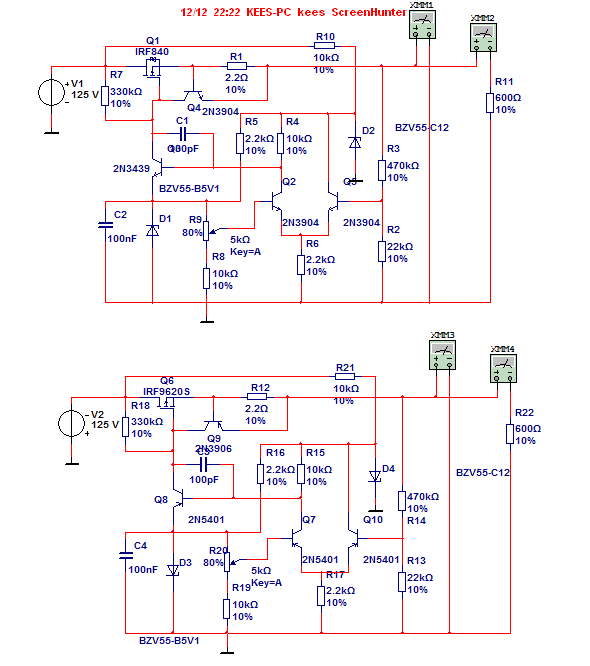

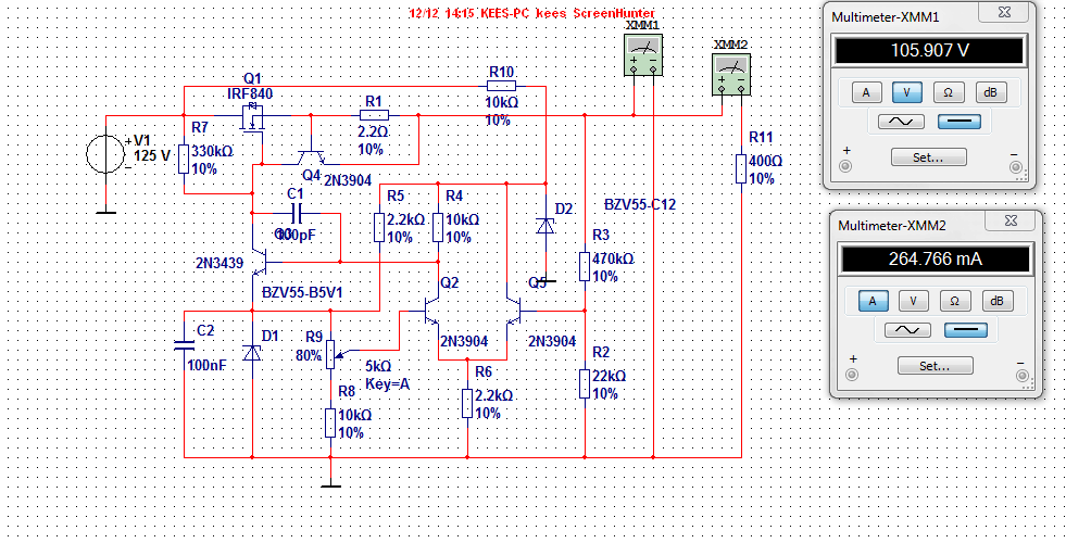

I just want to now what you think about this one, it simulates good, 10 mA to 1 amp just 100 mv difference in output.
it is a shunt coupled to a source follower, I need it for a hybride who use white follower, on differential supply dc coupled to mosfets.
I have now test it in amp, and he is so quied as a astronaut on the moon, deep black.
for the shunt mosfet you can also use a bjt npn with some changes on his base resistors, but I think mosfets are better, in simulations that is maar in my amp it does good job.

classic design. mosfets are better than the transistors because they keep the power supply low in impedance.
Yep. Pretty classic design. I tried that as part of my quest for a high-voltage regulator. I found it inadequate for use in my 300B SET amp for a number of reasons. The pass device would blow on start-up due to SOA violations, the ripple rejection was mediocre, and the output voltage varied quite a bit with temperature. I eventually ended up designing a floating high-voltage regulator.
With your relatively low voltages (125 V input), you do have the benefit of being able to choose components that offer more gain. Having access to low-voltage electrolytics so you can get a decent amount of cap in a small package works in your favor as well. Specifically, the C4-R4 time constant in your circuit (main ripple rejection filter) works well with a sizable cap.
Obviously, the circuit works in your application. Good work... Just sayin' that it's hard to scale it up to higher voltages.

For very high voltages there are always limitations, but I have need only 2 x 110 volt for white follower in hybride, and it simulates very nice, I have to say that in these days there are a lot very high bjt and mosfets, shunt it with a zener can protect it when startup, but has some danger in case the zener fails.
Than bipolar junction transistors I assume you mean?
This is incorrect because BJTs have higher transconductance than MOSFETs do, at comparable operating conditions.

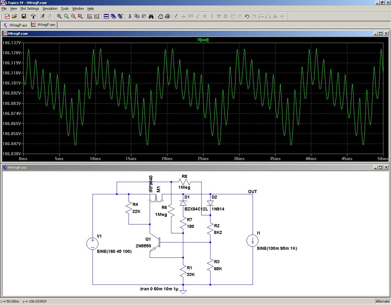

This doesn't matter much, because the circuit shows a big fat 22uF crushing the loop response. The output impedance of this regulator will be approximately 1/Gm of Q1, which will be in the 10s of ohms range most likely.
If R4 and C4 were removed and a small compensation capacitor (or R+C) placed across R2, and the values adjusted until critically damped transient response is obtained, you will have the lowest possible output impedance and highest PSRR. I would guess Zo will be in the miliohms, especially with BJTs, while PSRR will be >40dB.
Further improvement can be made by reducing the bias current supplied from R3; 100k or even 1M will suffice here, at some expense to high frequency response (which is easily compensated for with a customary filter capacitor on the output). This also relaxes the operating point for BJTs, which are often 2nd breakdown limited at these voltages and higher.
As a final step, the error amplifier can be changed from a single transistor to a differential pair, at the expense of one small transistor; this will essentially transform the tempco from an obvious Vbe error down to the error of D1, which could also be replaced by a lower voltage zener (with predictable tempco), or a bandgap reference such as TL431.
Then you'll have essentially the regulator circuit I built here, with a bit higher current capacity:
For that matter, this circuit will do an excellent job under the same conditions, replacing the pass transistor with a MOSFET and adjusting the current shunt resistor accordingly.
Tim
Actually, it is not so classic: reference voltage for the follower is taken from capacitor, and feedback loop is slow.
There is a small capacitor (C6 = 220nF) across R2. Read somewhere else that it improves the PSRR by about 10dB?

Looks nice but I need only low current q50 mA max, but I will try your for a test, I have also need a negatieve one because the white follower has differential supply, there is much on the internet about regulators, it seems complicated or maybe whe are never satisfy ;-).
I dont need a mosfet pass transistor persee, a bjt will do, oly I have a lot of high voltage mosfets here so I try first.
This moment the amps works with two gyrators in the supply, the ripple in the loudspeakers are now gone, it is deep black.

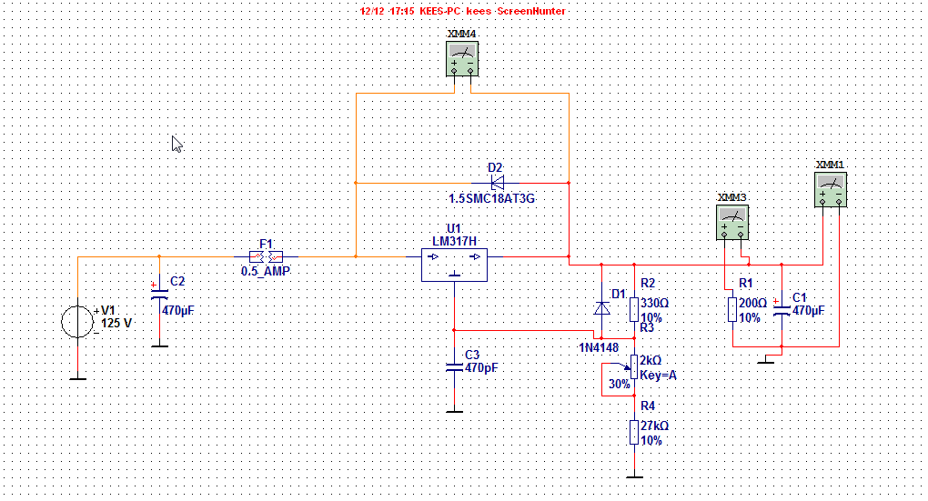

I have now do 2 things, one is a normally lm317 floating and protected with a fuse and transient diode of some amps, it works in simulation en is simple, with 80 db riple rejection .
or the one from post 11 I have done with a mosfet, I think that a normally LM317 is for me just fine and simple, maybe remove the transient diode and use a darlington npn for input as a current limiter, can simple with a zener. even a thyristor acros the lm317 can work together with a fuse.

These regulators are nominally a bit more complex, as they use three transistors, but they remain inexpensive and have decent performances considering their cost/complexity:
http://www.diyaudio.com/forums/power-supplies/198986-simple-hv-series-regulators.html
Another route is to use complementary transistors.
This example is based on a P channel ballast, but if there are no grounding issues, polarities could be swapped (bypassing could be added to improve AC performance):

I have test the one with lm317 and have try to kill it but it is quite good, it is very good protected, I have afcourse relative low voltage this counts also, I here here about 600 volt and more, there are transient diodes who can protect mosfets and transistors when power up and cause trouble with electrolitic capacitor who has to be charged, and thus see a short for a short time, here these diodes can help?
