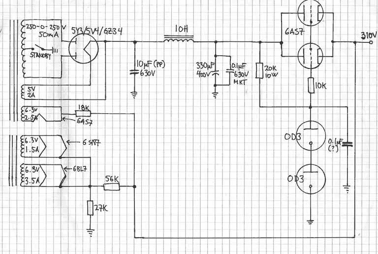

Voltage Regulator Tubes
They are actually pretty easy to use - only a few considerations:
1. Need a little extra voltage above the operating point to light them off (depends on the type).
2. Use a current limiting resistor or current regulator to stay under the maximum current limit (the short term limit is well above the steady state limit) when the downstream stuff is not yet drawing current.
3. The general load recommendation I've seen, is that the load current should be within about half of the steady state limit, and the steady state current through the tube should be around half of the continuous maximum.
4. With series regs., you'll often see a high value resistor (200k or so) from the supply to the series connection between tubes. This helps light off the lower tube.
5. Keep the capacitance across each tube less than 100nF (even less to be on the safe side).

I have read through all of this incl. the links and manuals.
I do have some questions still:
- Lynn used an OD3 here: http://www.nutshellhifi.com/IT-Triode-Amp.gif ...but why did he use the 330Ohm Resistor in this position ? He uses a CCS to feed the stage. The CCS allows only 60mA. So, even in warm up he would not need any resistor at all. It is notthe series resistor, it is between Anode of the OD3 and reg HV+ ?
- where is the OD3 allowed to be positioned in a PSU ? Always as last element of a passive filterchain or could as well between a pair of LC- legs ? Example: My current line amp has One 5u4g feeding into one LC, so choke input. For channelseperation, two LC in parallel are following, so we have LC-(LC*2).
Can i just have one OD3 after the first LC feeding into the two chokes following, so LC-OD3-(LC*2)? Or must it be two OD3, one per channel after the last LC of each channel feeding directly into the tubes, so LC-(LC-OD3)*2 ?
- in the discussion linked above, people talk about a start voltage of the OD3 of 180V. This confuses me. Looking at the data sheet I find as well 160V as starting voltage... https://frank.pocnet.net/sheets/137/0/0B3.pdf ...Currently I have only 172V on my PSU...
Can I interpret it like: New OD3 will start with 160V, but need more and more voltage once they age (up to 185V) ? Or will even a new one not start below 180/185V ? AND : For how long do we need the starting voltage ? Fractions of seconds ? I guess any transformer will deliver much more voltage as long as there is no real load as the main tubes need to heat up first...?
Thx for your help.
I am going to guess that he added the 330R resistor to swamp the negative slope resistance of the regulator valve. This avoids forming a relaxation oscillator with the decoupling capacitor. In this respect voltage regulator valves are different from zener diodes: zeners have a small positive slope resistance but VR valves have a negative resistance so cannot have too much capacitance placed across them.
Where it does whatever you want it to do. If you know what you want to do then put it there. If you don't know what you want it to do then why do you think you need one?
Almost all valve audio circuits do not need voltage regulation. When present it is often there to impress journalists and customers by giving a superficial impression of precision. Personally I think it is quite silly to feed a valve stage via a series CCS and a shunt voltage regulator.
Starting voltage is a matter of age, sample variation, light level, local radiation sources, cosmic rays etc. Some military versions have a little radioactive gas inside to give a quick ignition under all conditions.
Thx...so I can position an LC-Leg behind thenm ? I understand that any capacitance bigger than 0.1uF will destroy the Reg tube...the question is, if the Choke is isolating the following C or if this is already to much for such a tube...never used them before...
Even disregarding the bad grammar this is preposterous. This is diyAudio. Here we build amplifiers for our own use and don't need to impress anybody but ourselves. I find valve voltage stabilizers very useful and use them frequently. I'm sure that I'm not alone in this.
Driver stages in amplifiers often use a lower voltage than the output stage and a voltage stabilizer can conveniently be used to set the correct voltage. They kill ripple very effectively into the bargain. And they look good.
In the right circumstances they can also be used to get rid of those pesky cathode bypass capacitors. If you connect the voltage stabilizer from B+ to cathode you get a much higher current through the cathode resistor. If this results in a cathode resistor below 40 Ohms or so you will probably be able to omit the cap.
However, using a voltage regulator between two LC stages is not a good idea.
