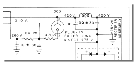

Me personally? I'd put a 5 kΩ resistor on that regulator and not use its regulated voltage directly. Instead, run it to the base of a HV transistor in series with the HV leg, to deliver around 0.9 volts less than the reg-tube nearly-constant-current stable volts… [...]

No need to hide behind the tree. The only thing I am throwing is a sketch (of a schematic). Something along that line?
The right version with CCS supplying around 10mA (sorry did not find a correct symbol).

How about this Martin, attached schem?
Ref Kolbrek, the C can be increased if used w the series resistor, I'd try 10uF but might be conservative and use 10ohm or higher for R. A flat impedance of 10-20ohms over a wide frequency is better than a low impedance with rising peaks in the hundreds of ohms.
Hi SemperFi,
yes, that looks good. VR tubes look great, but I have to admit that I have a soft spot for LEDs as well.
Indeed, higher output impedance might not be such a problem if there is less variation over a large range of frequencies. Especially if the load is reasonably constant.
If you want to have lower output impedance, you would probably go "all silicon" anyway. 😀
The cap on the base of the pass transistor is for soft start?
Best,
Martin
The cap after the base resistor creates a capacitance multiplier function with the R, C, and NPN.
