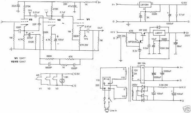

What would be the simplest way to increase voltage in HV section from 250V to 300V ? TIA , L

OK , Thank You guys .If I find 120k/5W in my junk bin ,I'll try it first . If not I lower 500R a little bit , easier to get small wattage resistor. And LM317 has hefty heatsink so upping current want be a problem either.
Actually it's 1.7mA for a channel so 3.4 mA for both . I didn't want to mess with it too much. ( the psu unit ) I don't know why people who made it went for Maida regulator . I put Cree Shottky rectifier diodes , dropped resistor from 500R to 420R and it took care of the business. I will listen to it a little (sounds pretty good )and than maybe go passive with chokes and tube gas regulators . Thank you for your help. Best Regards, L
