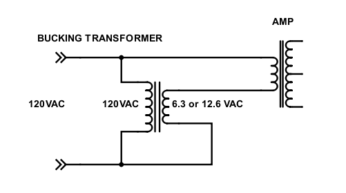

Use a small transformer to buck the input AC voltage down.
You get -5% with a 6.3VAC filament transformer, or -10% with a 12.6VAC unit.
I'd go with the -10% option.
The transformer's secondary current rating should be more than the amplifier.
