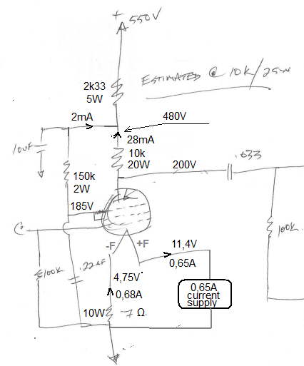

voltage dropping resistors
With what we know from the TS and the tube datasheet it could be something like this,
There is, with this way of getting the negative grid voltage, no stabilising cathode resistor.
To adjust for differenties between tubes I sugest to make the serieal resistor to the supply (550V) ajustable.
