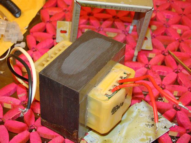

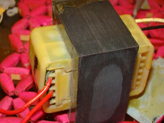

There are some good power rated step down trannies made for playstations etc.
Just make sure that these step-down trannies are not autoformers! In Brazil they love these to handle 220V - 110V and vice-versa. You can test it by checking for continuity (resistance) between 'primary' and 'secondary': if you can measure a resistance it means it is an autoformer, and your 'secondary' is actually connected to the net!
For sure. These step downs are truly big EI transformers. Aournd 25 uSD for a 400Watt model increasing to around 60 USD for a 1000 watt model.

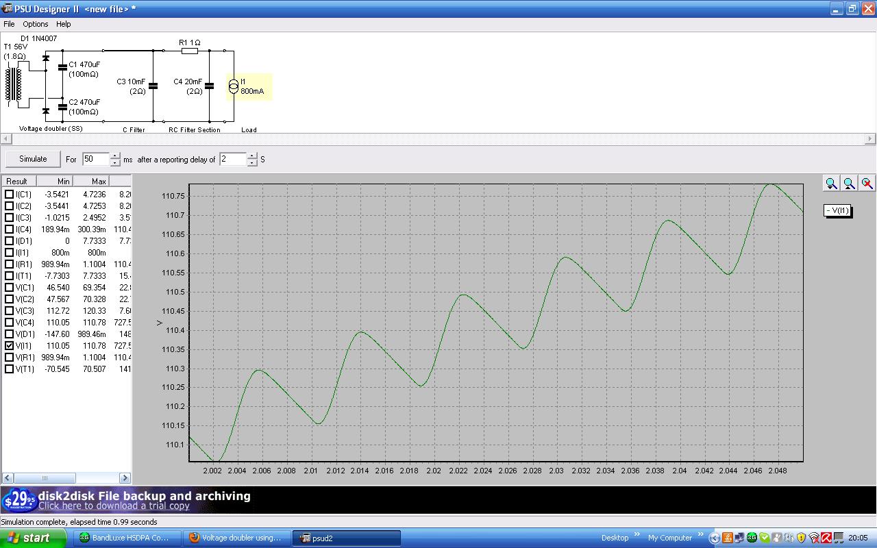

Having trouble choosing the right values here. Never designed a voltage doubler before.
Could you assist?

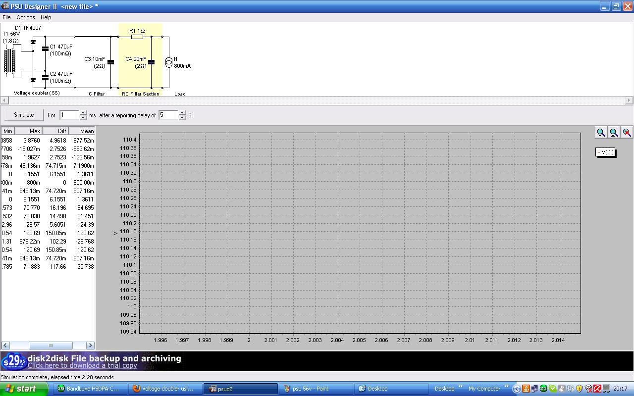

don't we need a resistor/cap series and also change the load to constant current?
How does this look? 723 mV of ripple. maybe with another series of caps this can lower. maybe 2 series of 10000 instead of 1 of 20000uF.
I get 110 volts with this. Perfect for the 6080's.

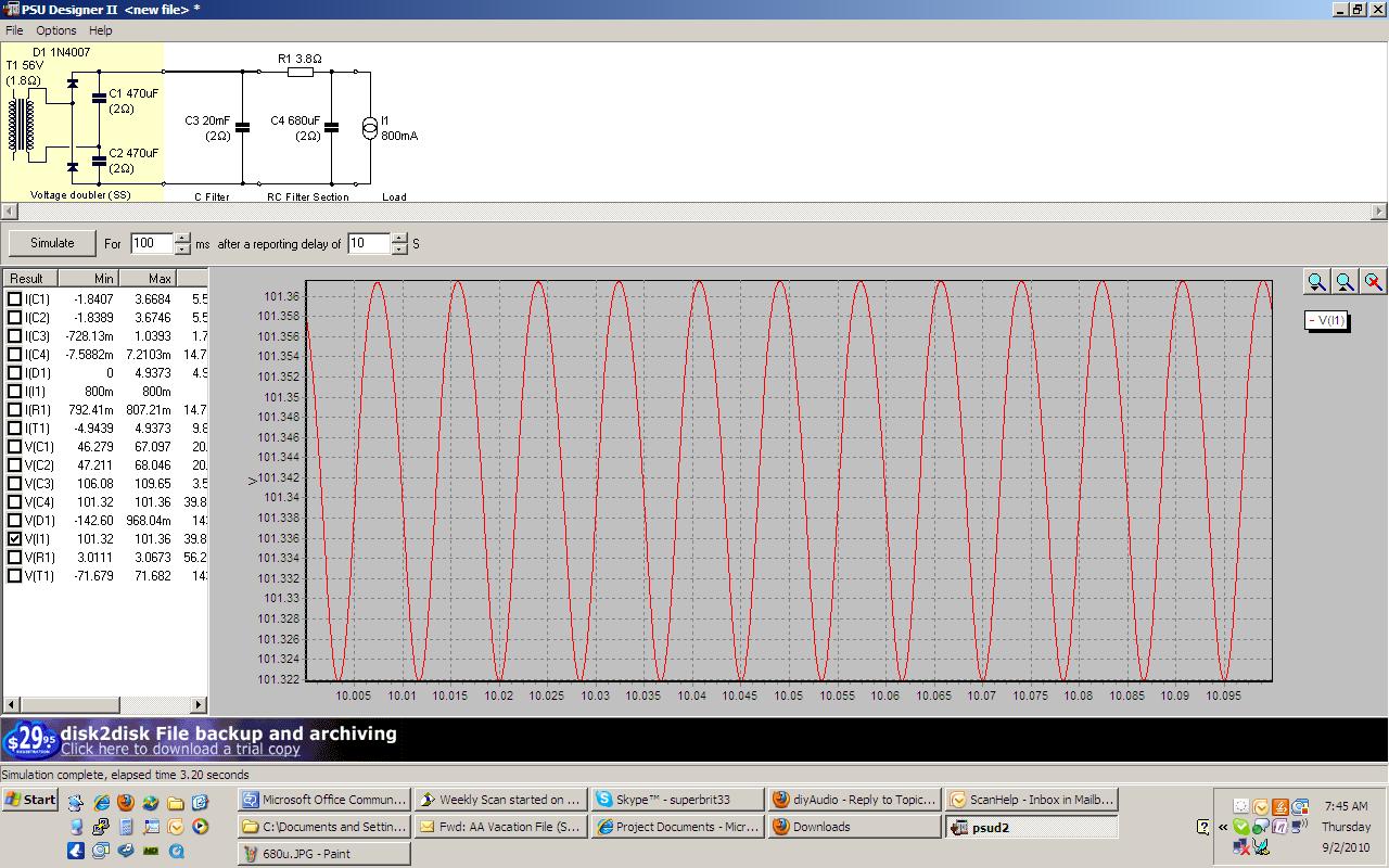

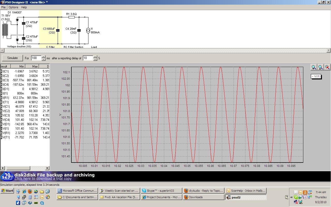

I think I should have the highest capacitance on the first leg of caps.
you can see I get much lower ripple with 20K (39mV) on the first leg rather than the last (738mV). Maybe a CCS on the anode would filter out some noise but at 1 amp my DN2540's would explode. I'll try tweaking the caps tonight.
