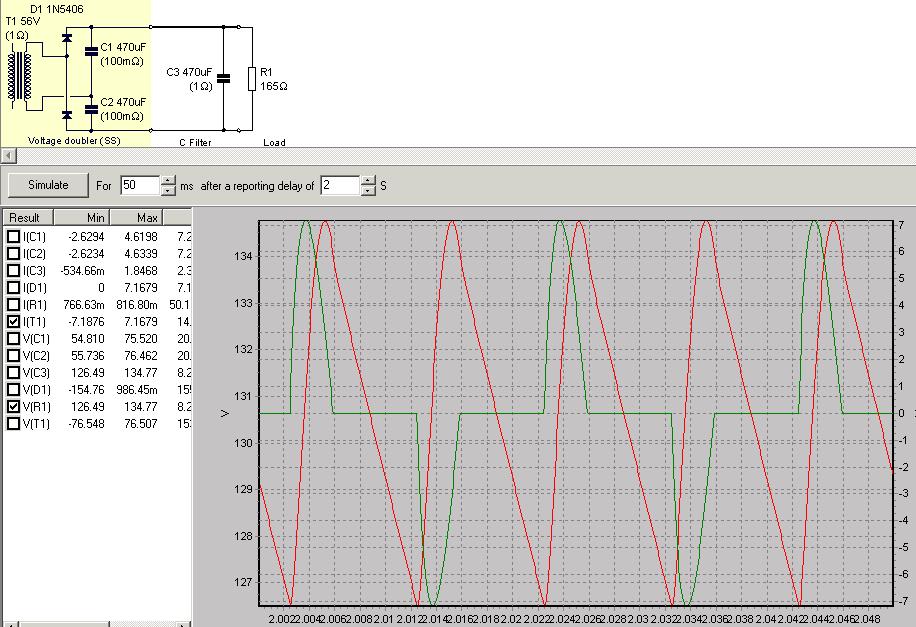

Voltage doubler using PSUII?
Attempting to use PSUII to create a voltage doubler.
I have to 28V (3 amps each) trannies I will put in series and use a voltage doubler.
I calculate 28+28= 56 volts
56 *1.4 = 78.4
78.4 * 2 = 156 volts.
I cannot seem to get a simple circuit to work from 78.4 volts.
Maybe I'm expecting too much from the draw of 800 mA of current needed.
I tried using low resistors and high capacitance but the psuII drops negatively and gives me around 20 volts! What am I doing wrong?
Better to work it out manually?
Can I get 100-150 volts to supply 800 mA from these 2 trannies?
Maybe better to buy a new 110V tranny. But...$$$

I just tried it in PSUII without problems (see attached).
Using 470uF capacitors, at 800mA load current the DC voltage is 131V with 8Vp-p ripple. The ripple current in the transformer is 3Arms, which nicely matches your real transformers.

#1 I have to emphatically disagree with piano3: it is far preferable to use 2 identical transformers with secondaries in series than to do a back-to-back with those same identical transformers. Back-to-back is best done with dissimilar transformers, so that the larger one can handle the extra magnetizing current.
#2 Using a 3A rated transformer with a doubler and expecting only 800mA is quite reasonable. As for why it isn't working in PSUDII; have you really gone over all the settings you have in PSUDII? Are you focusing on the start up transient too much? Maybe we should be focusing on that?

Sure, I can have a look at it tonight maybe (Wed is wing night here). The thing with a voltage doubler is that your AC ripple is also doubled, but you can use SS diodes and big caps to smooth that. Also, you just barely meet 160VDC rating, which helps a lot with the cost of big caps (also, if you are a recycler you can pull a lot of 200VDC caps out of PC switching supplies). You can try something like a CRC filter with 2 1000uF/160VDC caps and a resistor in between.
Personally, at 160 VDC or less I would use a LM317 regulator (without protection) to smooth things out, but I know that is generally frowned upon by this forum and the collective recommendation would be to consider a Maida regulator.
Either the transformers will be in phase (2x voltage) or out of phase (0 volts and possibility of smoke). Nothing in between. It's safe to test them without a load to verify the proper connection.
